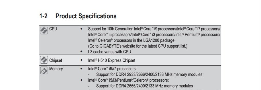

My specs:
  • CPU: Intel i3-10105 (Comet Lake, 4C/8T)
  • Motherboard: Gigabyte H410M S2 V3
  • iGPU: Intel UHD 630 (no dGPU)
  • SMBIOS: iMac20,1
  • Bootloader: OpenCore (latest release)
