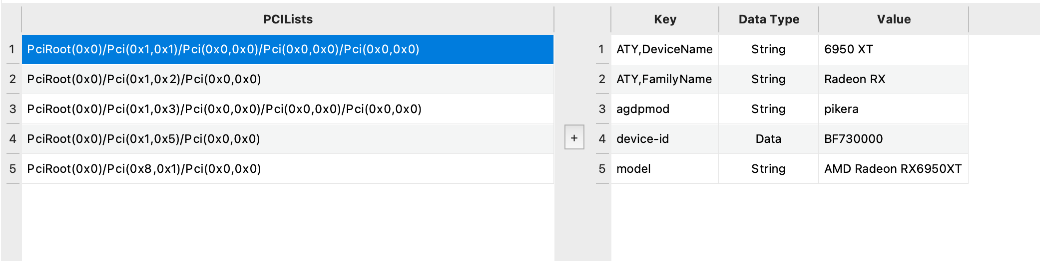

if you had XTXH GPU you have to spoof it in DP properties of your config.plist as example you can see this:
this is for unsupported 6950xt but it is pretty the same

I managed to get hardware acceleration the same way I did with the old Haswell system. No problem there.

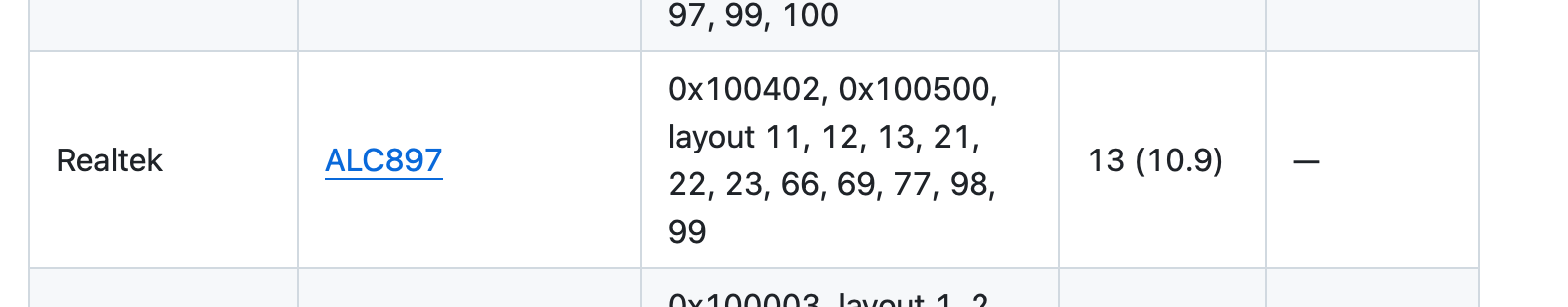

Yeah, I figured as much when I realized that the mainboard uses a standard ALC897. Sound is working now.
