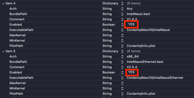

deeveedee Posted August 9, 2025 Share Posted August 9, 2025 (edited) @gravity25 Your config.plist shows that you are simultaneously enabling multiple Ethernet kexts. Spoiler Enable only one kext (I prefer IntelMausiEthernet.kext for Tahoe). Also, your Ethernet kexts are old. The versions you should be using are as follows: IntelMausiEthernet.kext 2.5.5d0 IntelMausi.kext 1.0.8 In summary: Enable only ONE Ethernet kext in your config.plist. I prefer IntelMausiEthernet.kext 2.5.5d0 for Tahoe. Edited August 9, 2025 by deeveedee Quote Link to comment https://www.insanelymac.com/forum/topic/361493-tahoe-hackintosh-ethernet-connection-problem/#findComment-2838728 Share on other sites More sharing options...

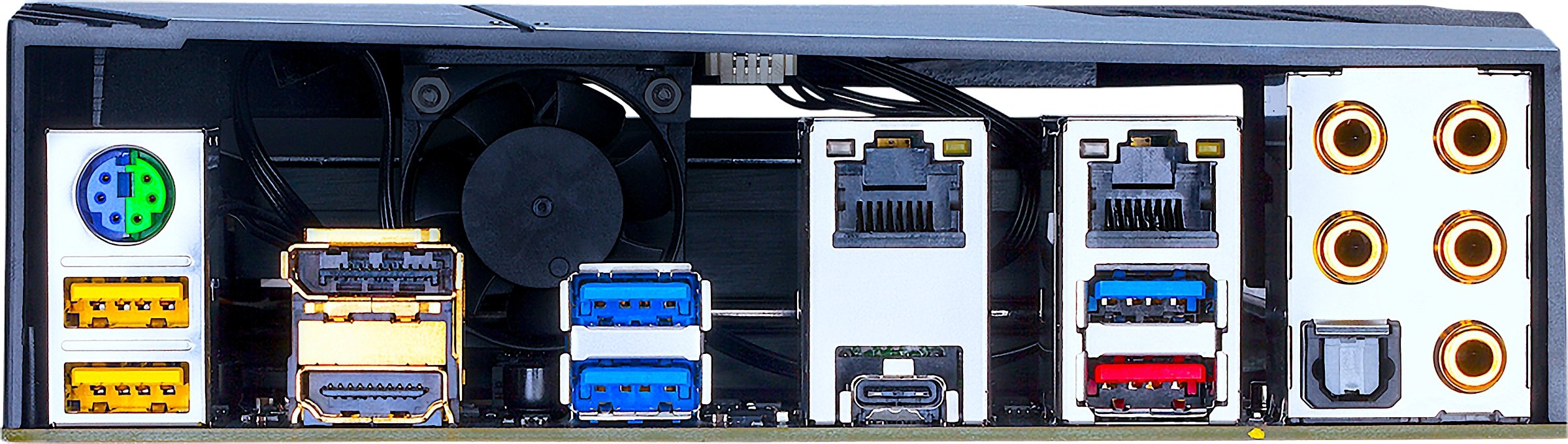

Oyecomova Posted August 9, 2025 Share Posted August 9, 2025 19 minutes ago, deeveedee said: @gravedad25 Tu archivo config.plist muestra que estás habilitando varios kexts Ethernet simultáneamente. Habilita solo uno (prefiero IntelMausiEthernet.kext para Tahoe). Además, tus kexts Ethernet son antiguos. Las versiones que deberías usar son las siguientes: IntelMausiEthernet.kext 2.5.5d0 IntelMausi.kext 1.0.8 En resumen: Habilite solo UN kext Ethernet en su archivo config.plist. Prefiero IntelMausiEthernet.kext 2.5.5d0 para Tahoe. It doesn't work for me Z370 AORUS Gaming 7... is there a conflict between using two networks in Tahoe? Quote Link to comment https://www.insanelymac.com/forum/topic/361493-tahoe-hackintosh-ethernet-connection-problem/#findComment-2838733 Share on other sites More sharing options...
deeveedee Posted August 9, 2025 Share Posted August 9, 2025 @Oyecomova I don't have your motherboard to test, so I can only offer suggestions (as I did after finding errors in gravity25's config.plist). If your EFI worked for Sequoia but not Tahoe, make sure that you have Kernel > Quirks > DisableIoMapper = True for Tahoe. If that isn't it, try asking your questions here. Quote Link to comment https://www.insanelymac.com/forum/topic/361493-tahoe-hackintosh-ethernet-connection-problem/#findComment-2838735 Share on other sites More sharing options...
gravity25 Posted August 10, 2025 Author Share Posted August 10, 2025 15 hours ago, deeveedee said: @gravity25 Your config.plist shows that you are simultaneously enabling multiple Ethernet kexts. Reveal hidden contents Enable only one kext (I prefer IntelMausiEthernet.kext for Tahoe). Also, your Ethernet kexts are old. The versions you should be using are as follows: IntelMausiEthernet.kext 2.5.5d0 IntelMausi.kext 1.0.8 In summary: Enable only ONE Ethernet kext in your config.plist. I prefer IntelMausiEthernet.kext 2.5.5d0 for Tahoe. Thank you for the reply and suggestion. I followed your suggestion with both individually. Still NO Ethernet..... Quote Link to comment https://www.insanelymac.com/forum/topic/361493-tahoe-hackintosh-ethernet-connection-problem/#findComment-2838779 Share on other sites More sharing options...
