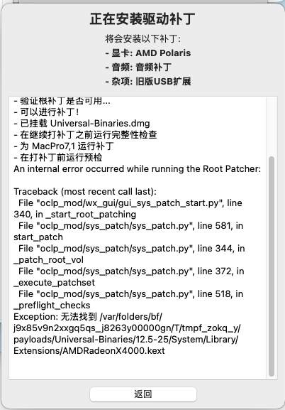

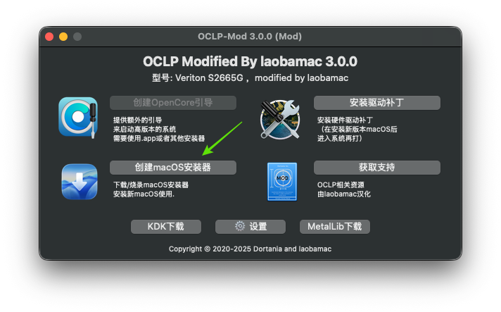

The latest OCLP-Mod Pre-release currently does not support AMD Polaris patches. Please wait, I will submit a test version within 30 minutes....
Please follow Pre-release

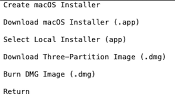

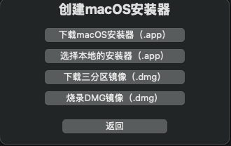

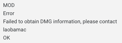

Try Download Three-Partition Image (.dmg)
Screenshot2025-07-08alle11_06_23.png.b6d9ae9df051180140e833634e02ddaf.png                                      Screenshot2025-07-08alle11_48_30.png.7a8b496fca44c88aa00b472646d1d87e.png
Does anyone know how to contact @laobamac_yyds ?  😂

31 minutes ago, Anto65 said:
  隐藏内容
  截图2025-07-08alle10_58_00.png.279c3757bf629994da6a41779ed2cc69.png                                      截图2025-07-08alle11_43_12.png.ee0f53f4105833915b575ba31df3f390.png
尝试下载三分区映像(.dmg)
Screenshot2025-07-08alle11_06_23.png.b6d9ae9df051180140e833634e02ddaf.png                                      截图2025-07-08alle11_48_30.png.7a8b496fca44c88aa00b472646d1d87e.png
有人知道如何联系@laobamac_yyds?   😂

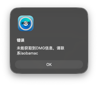

Last month, our API server was attacked and we haven't been able to fix it yet. Dig a hole and fill it up during summer vacation😂
  • Haha 2
  • Sad 1
16 minutes ago, Anto65 said:
我很抱歉,哈哈 😒
无论如何,它应该下载 Recovery,对吗?或者不下载?
Now downloading the PKG installation package is still available. That three partition DMG image is used to burn the Hackintosh Installer. Three partitions refer to HFS+, OpenCore(This partition holds the user's own EFI), and PE used for system maintenance, which are more convenient for installing Hackintosh.

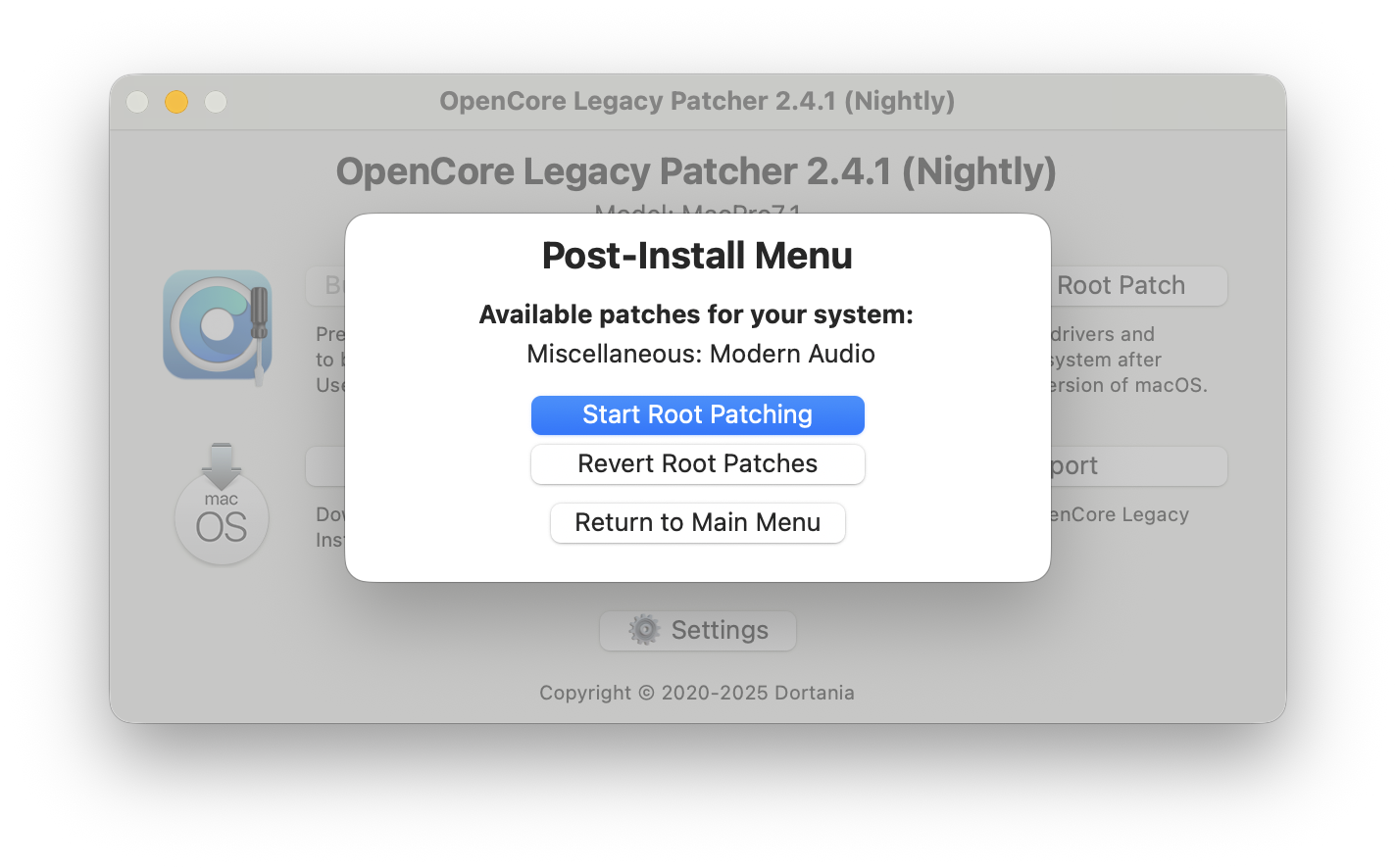

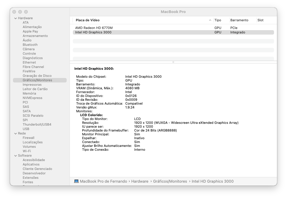

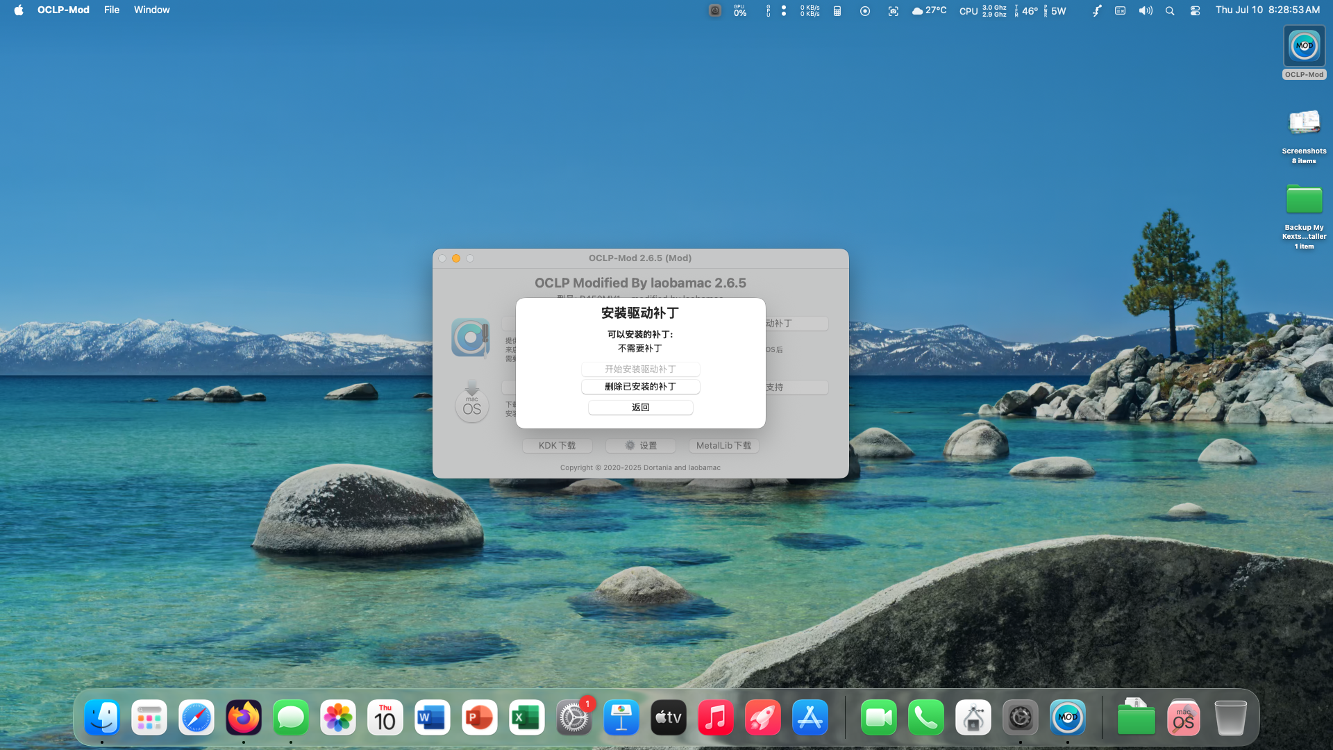

Do this after installed @laobamac_yyds OCLP-Mod Pre-release and rebooted

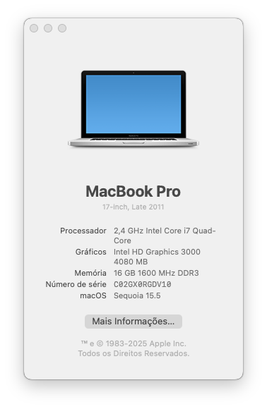

With those commands, your acceleration will work but transparency is not working at all. => MacBook Pro Late 2011 - 17 inches - Intel HD Graphics 3000 (512MB) / AMD Radeon HD 6770 1GB. MacBookPro8,3 - Real Mac.
Need SIP Disable 0803...
sudo mkdir /Volumes/root
sudo mount -o nobrowse -t apfs /dev/"Your Tahoe Disk (Apfs)" /Volumes/root
sudo mount -uw /Volumes/root
cd /Volumes/root/S*/L*/Extensions
sudo rm -R /Volumes/root/System/Library/Extensions/AppleIntelHD3000Graphics.kext && sudo rm -R /Volumes/root/System/Library/Extensions/AppleIntelSNBGraphicsFB.kext && sudo rm -R /Volumes/root/System/Library/Extensions/AppleIntelFramebufferCapri.kext
sudo cp -R /users/"Your user Name"/Desktop/Drivers/Apple* .
cd /Volumes/root/S*/L*/Ext*/AppleIntelSNBGraphicsFB.kext/C*/M*
sudo cp AppleIntelSNBGraphicsFB AppleIntelSNBGraphicsFB.backup
Those commands make your Intel HD 3000 Graphics with (1,5GB VRAM, 2GB, 3GB,4GB (4080 MB)) - Not working on Tahoe (Sequoia works)
1,5GB
sudo perl -pi -e 's|\xC7\x45\xBC\x00\x00\x00\x40|\xc7\x45\xBC\x00\x00\x00\x60|g' AppleIntelSNBGraphicsFB
2GB
sudo perl -pi -e 's|\xC7\x45\xBC\x00\x00\x00\x40|\xc7\x45\xBC\x00\x00\x00\x80|g' AppleIntelSNBGraphicsFB
3GB
sudo perl -pi -e 's|\xC7\x45\xBC\x00\x00\x00\x40|\xc7\x45\xBC\x00\x00\x00\xC0|g' AppleIntelSNBGraphicsFB
4GB (4080 MB)
sudo perl -pi -e 's|\xC7\x45\xBC\x00\x00\x00\x40|\xc7\x45\xBC\x00\x00\x00\xFF|g' AppleIntelSNBGraphicsFB
sudo kmutil install --volume-root /Volumes/root/ --update-all
sudo bless --folder /Volumes/root/System/Library/CoreServices --bootefi --create-snapshot
Attached files: Kexts + Command (Terminal).zip ***Unzip at your Desktop (To use these commands, or adapt to new location)***

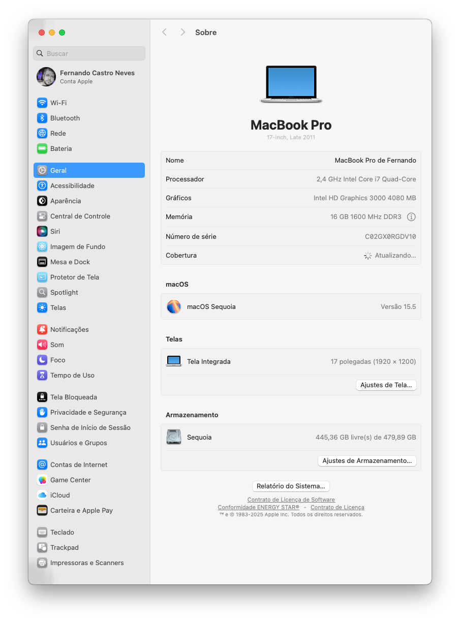

Ps: I' using two SSD's one with Tahoe Beta 3 and another with Sequoia 15.5, to manage how to implement the patch for Intel HD 3000 Graphics at least...
I get Acceleration in Tahoe Beta 3 with Safari over Youtube on videos 1080p 60fps... Smooth, but the transparency of the system is with some bug's...
I guess this is far as I can go with Real Macs patching.. Now if @laobamac_yyds can help it will be appreciate.
Another thing that I observed is that FrameWork is not included in @laobamac_yyds patch, so no acceleration from OCLP-Mod Pre-Release. I managed to install using this commands:
Install Legacy Video Patcher... => @chris1111 Many thanks for your Legacy Video Patcher, is working like a charm until Sequoia 15.5 =>
@chris1111 Source code => https://github.com/chris1111/Legacy-Video-patch
Compiled version => https://drive.google.com/file/d/1AG9CivELxxE0bPKisGy9qPuaGYUvP0AA/view?usp=sharing
And after use these:
sudo reboot
Thats all folks.
Regards,
Fernando.
Edited by fernando.c.neves
  • Thanks 2
i create a fork from OCLP main repo and add the Audio patch (restore AppleHDA.kext) from KDK beta 1, without anything else, seem to work to restore my audio, maybe myKextInstaller miss some step needed to get a functional root patch
Spoiler
Edited by arya
  • Like 4

For the ones who has Real Mac´s, I made an Topic to discuss there the directions of first OCLP-Mod from @laobamac_yyds
I made some progress in getting acceleration in my Real Mac (MacBookPro8,3) MacBook Pro Late 2011 17 inches with Intel HD Graphics 3000 with 512MB of video memory and AMD Radeon HD 6770M with 1GB dedicated memory.
All the credits for @laobamac_yyds who have forked from OCLP this project.

Is what I´m doing, try to adapt to my Real Mac with Intel HD Graphics 3000... (Sandy Bridge).

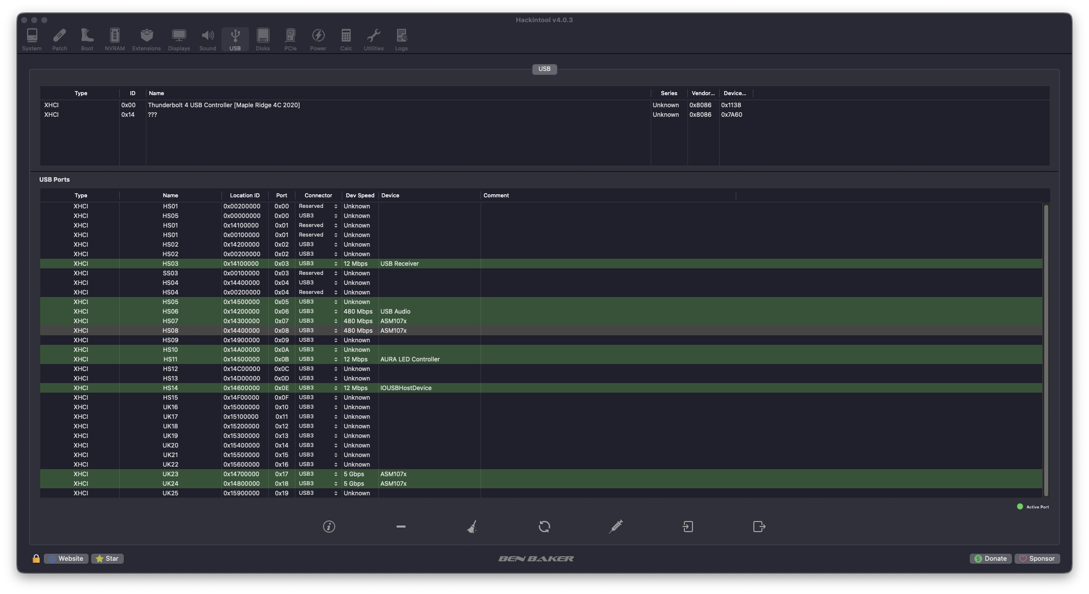

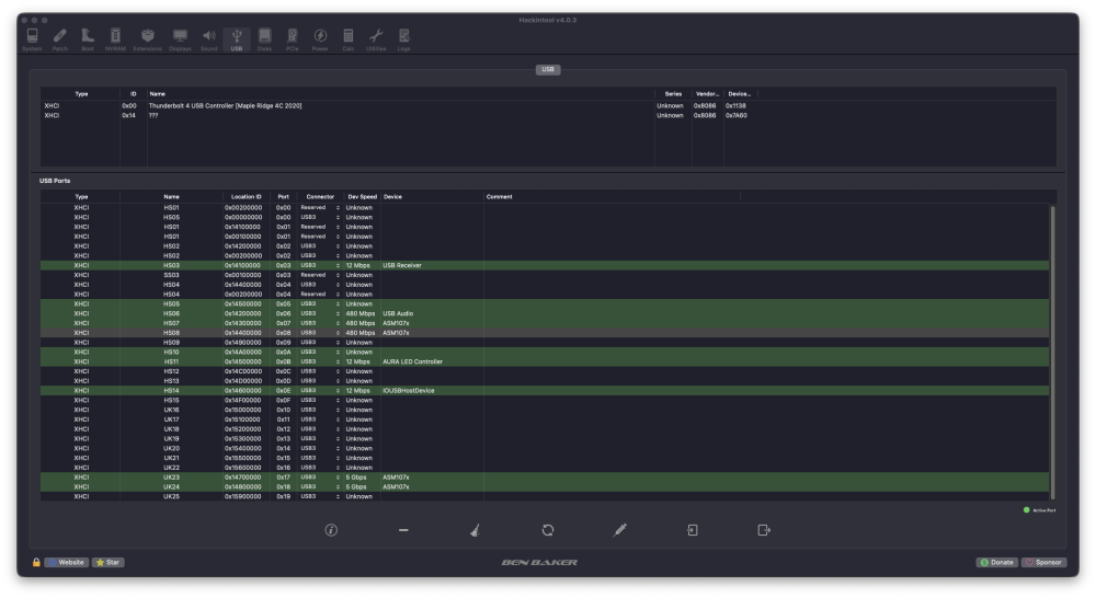

I have a puzzle when trying to operate WIFI/BT adapter TP-Link Archer T2UB Nano. I created my USBMap.kext from old Sequoia version via USBMAP tool. If I run the system with this USBMap.kext ,  I am able to run BT feature. It works , scans the devices and connects succesfully. But BT does not work although I had installed @chris1111's app Wireless-USB-OC-Big-Sur-Adapter. And if I apply @laobamac_yyds OCLP-Mod,  this time WIFI İDENTİFİED AS 802.11ac NIC, starts working but BT wheel only spins but can not find an device. More strangely,  USB in system information does not show all USB , only otherbus , as can be seen in the picture. Hackintool shows all USB ports, HS08 is the port connecting 802.11ac NIC
I am really confused. I suspect that my USBMap.kext is fully correct and OCLP-MOD is scrumbling it . Any idea for a solution is appreciated.
image.thumb.png.99a3b40e348e0a96487f77f7fcc08929.pngimage.thumb.png.4596c86af8c3b353e6a1f5457634ce6d.png
Edited by dogansan

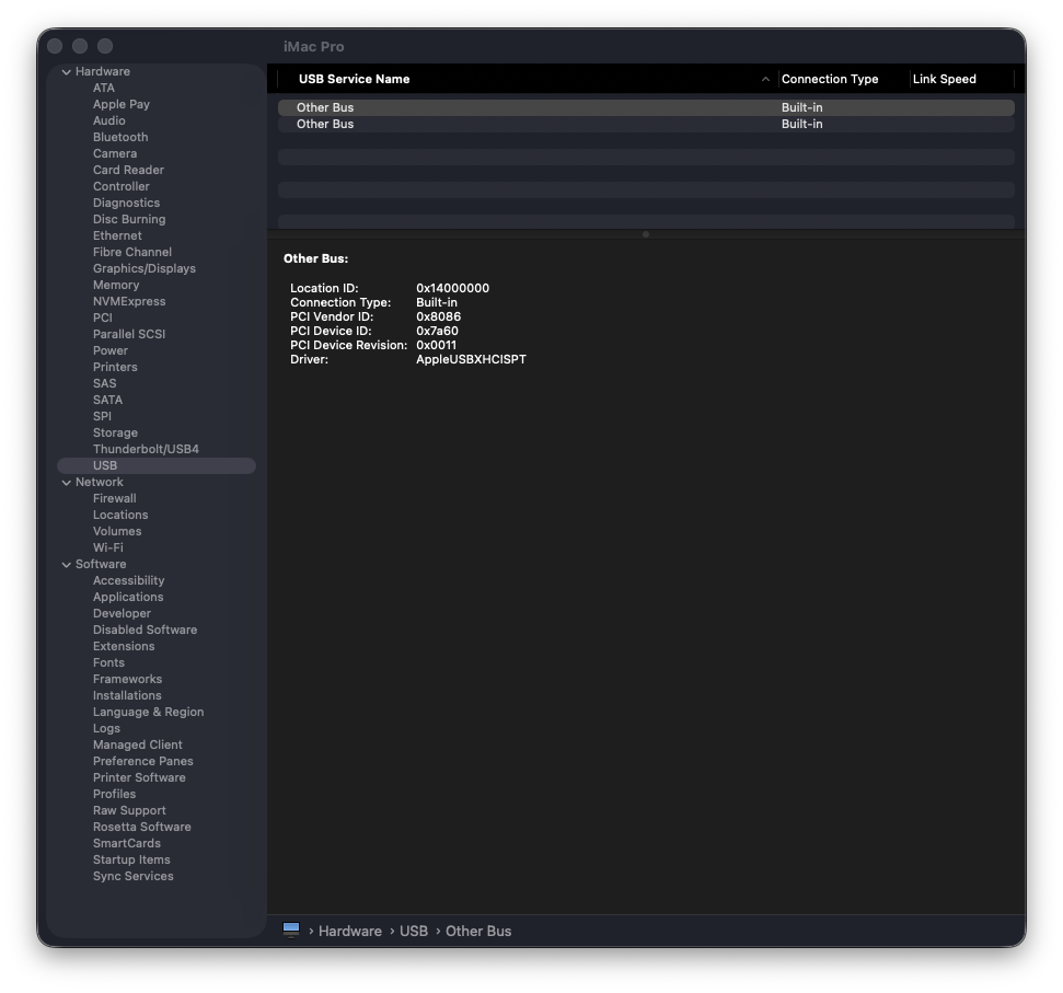

With OCLP-MODs USB Patch I can't see my USB Devices in System Information either, but they are fully working.
Maybe you got the same (small) issue with bluetoothExternalDongleFailed as I got since Sequoia? Sporadically it miraculously jumps to 01 although 00 is set in NVRAM - I simple set it back to 00:
sudo nvram 7C436110-AB2A-4BBB-A880-FE41995C9F82:bluetoothExternalDongleFailed=%00
  • Thanks 1
Thanks for the comment. I did apply OCLP-MOD USB patch again,  WIFI works but BT still does not work even after I apply above command

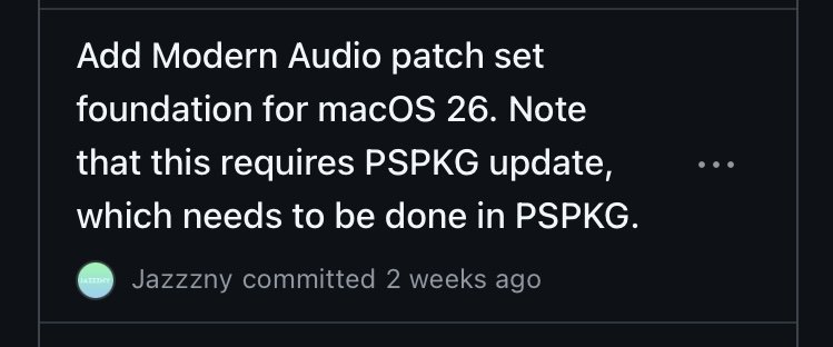

1 hour ago, miliuco said:
恕我无知。OCLP 夜间构建版有这个贡献。但是 PSPKG 是什么?
Just raising the Darwin version limit within def parent to Tahoe (25.99.99) has no other use. Everything needs to wait for PSPKG (PatcherSupportPkg) update, as all actual patch files are stored in this image file

@laobamac_yydsi cant patch my audio in beta 3,
Mine wasn't working since Beta 2.
There's a very strange issue with this patch. So, I had two partitions, one with Tahoe, fresh install, the other with Sequoia, now upgraded to Tahoe as well.
I've successfully patched Tahoe, and everything was working fine. Then after upgrading Sequoia to Tahoe...I wanted to patch the system again, to get the audio working. But...it kept saying that all my patches are up to date.
In the meantime, I even removed the other partition, since that was only for testing, and focused on the upgraded one. But so far I couldn't get it to patch anymore.
Any idea what could it be?
I tried uninstalling and reinstalling the app, removing patches...which by the way, for some reason seem to be still installed or something, cause the UI says all my patches are already applied, even after I removed them. So that might be a bug.
But anyway, I was wondering if anyone else had this issue with not being able to patch audio anymore after one successful patch.
48 minutes ago, eSaF said:
Bro are you sure it is not being picked up from another volume in the system?
If you're completely sure there is not another instance of it on another attached volume and you've deleted the app.
On the root volume you'll find a Dortania folder that you need to delete as well.
Reboot, clean NvRAM, reinstall the App and try again to see if the problem is solved.
I already deleted the other partition so yeah, that should be already taken care of. But I’ll try to find that folder and try again. I didn’t know about this. Thank you! :)
Edit: I couldn't find that Dortania folder. So I guess the only solution would be to reinstall the OS...?
