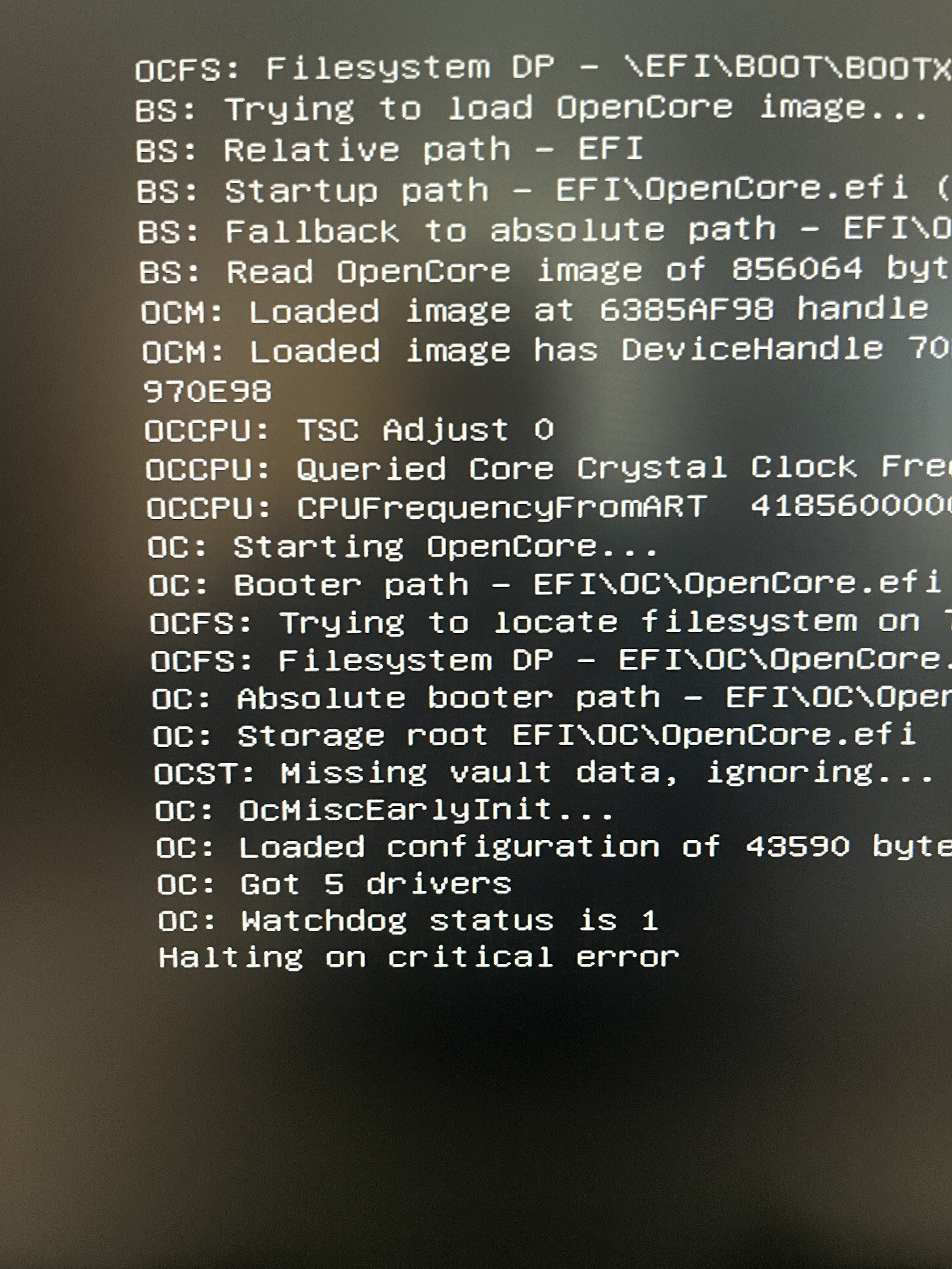

Andriy B. Posted February 20, 2025 Share Posted February 20, 2025 Hello! Is anyone have luck with B860M chipset? Bacause I stuck after OpenCore loads from usb, i select image from usb and see on screen logo with loading progress.. but it stuck around middle... 60:465 00:017 AAPL: #[EB.BST.FBS|KSSZ] 0 60:483 00:018 AAPL: #[EB|SB:SBGMFNS] j160ap.im4m 60:503 00:019 AAPL: #[EB|RH:PF] usr\standalone\OS.dmg.root_hash 60:524 00:021 AAPL: #[EB|RH:MF] <"usr\\standalone\\OS.dmg.root_hash.j160ap.im4m"> 60:545 00:021 AAPL: #[EB.LD.LF|IN] 0 1 <"usr\\standalone\\OS.dmg.root_hash"> <"0"> 60:571 00:025 AAPL: #[EB.LD.OFS|OPEN!] Err(0xE) <"usr\\standalone\\OS.dmg.root_hash"> 60:590 00:018 AAPL: #[EB.RH.LRH|P!] Err(0xE) <- EB.LD.LF 60:609 00:019 AAPL: #[EB.BST.FBS|!] Err(0xE) <- EB.RH.LRH 60:624 00:015 OCSMC: SmcReadValue Key 4D535463 Size 1 60:640 00:015 OCSMC: SmcReadValue Key 4D534163 Size 2 60:659 00:018 AAPL: #[EB|LOG:DT] 2025-02-09T15:30:49 60:679 00:019 AAPL: #[EB|LOG:EXITBS:START] 2025-02-09T15:30:49 Thanks! opencore-2025-02-09-152948.txt EFI.zip Quote Link to comment https://www.insanelymac.com/forum/topic/360705-heed-help-with-asus-prime-b860m-a-intel-core-ultra-5-245k-radeon-rx-6700-xt/ Share on other sites More sharing options...
MaLd0n Posted February 20, 2025 Share Posted February 20, 2025 Disable VT-d and secure boot, if need disable IGPU too. Quote Link to comment https://www.insanelymac.com/forum/topic/360705-heed-help-with-asus-prime-b860m-a-intel-core-ultra-5-245k-radeon-rx-6700-xt/#findComment-2830511 Share on other sites More sharing options...
LockDown Posted February 21, 2025 Share Posted February 21, 2025 Fixed mine by toggling RebuildAppleMemory 1 Quote Link to comment https://www.insanelymac.com/forum/topic/360705-heed-help-with-asus-prime-b860m-a-intel-core-ultra-5-245k-radeon-rx-6700-xt/#findComment-2830512 Share on other sites More sharing options...
Andriy B. Posted February 21, 2025 Author Share Posted February 21, 2025 5 hours ago, LockDown said: Fixed mine by toggling RebuildAppleMemory Can you please attach EFI please? Quote Link to comment https://www.insanelymac.com/forum/topic/360705-heed-help-with-asus-prime-b860m-a-intel-core-ultra-5-245k-radeon-rx-6700-xt/#findComment-2830514 Share on other sites More sharing options...
Andriy B. Posted February 21, 2025 Author Share Posted February 21, 2025 5 hours ago, LockDown said: Fixed mine by toggling RebuildAppleMemory RebuildAppleMemory - do not helps (checked with true/false ) Vt-d - disabled IGPU - disabled Secure boot - disabled but still with same error Can you please attach EFI please? Quote Link to comment https://www.insanelymac.com/forum/topic/360705-heed-help-with-asus-prime-b860m-a-intel-core-ultra-5-245k-radeon-rx-6700-xt/#findComment-2830515 Share on other sites More sharing options...

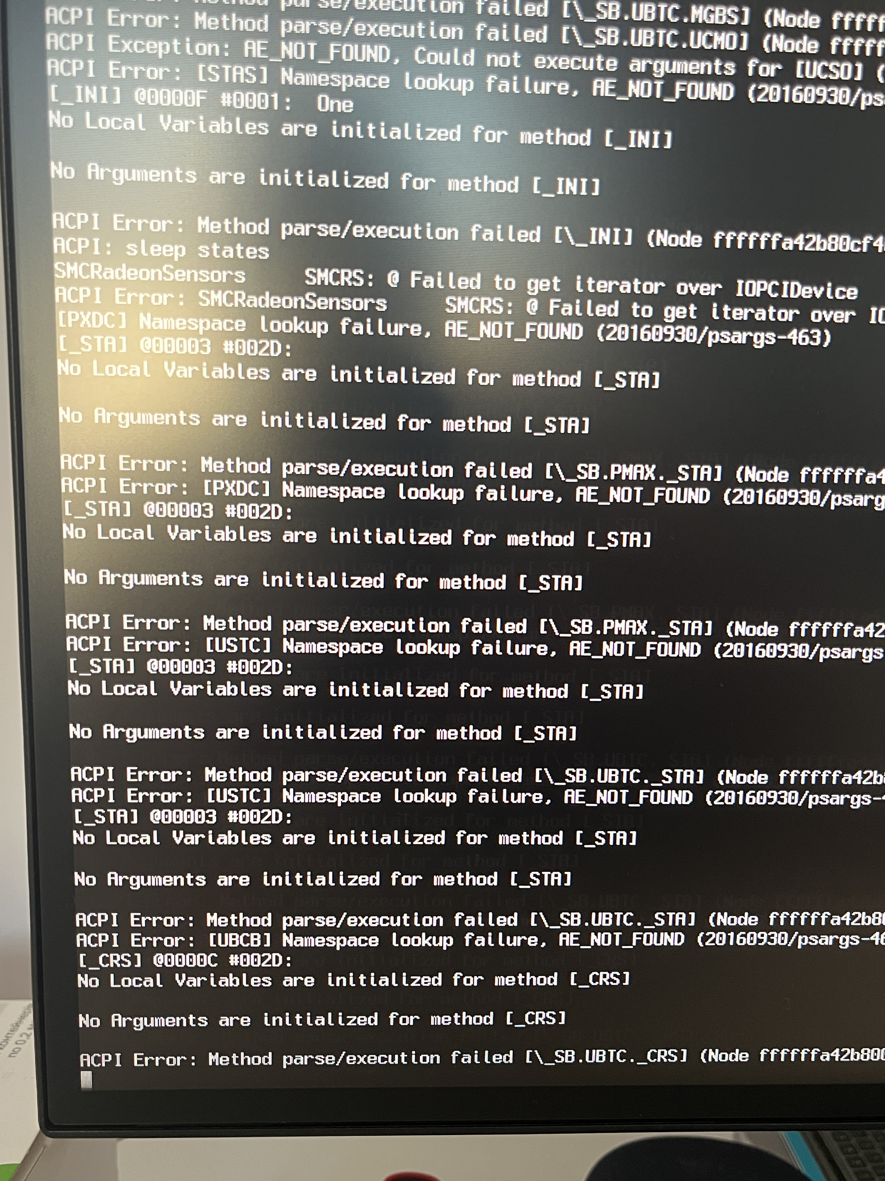

iaihc Posted February 21, 2025 Share Posted February 21, 2025 Please extract the DSDT file from your motherboard BIOS and debug these error codes. PXDC USTC UBCB Quote Link to comment https://www.insanelymac.com/forum/topic/360705-heed-help-with-asus-prime-b860m-a-intel-core-ultra-5-245k-radeon-rx-6700-xt/#findComment-2830518 Share on other sites More sharing options...
LockDown Posted February 21, 2025 Share Posted February 21, 2025 4 hours ago, Andriy B. said: but still with same error Your're not getting the same error anymore. You are now having another issue Quote Link to comment https://www.insanelymac.com/forum/topic/360705-heed-help-with-asus-prime-b860m-a-intel-core-ultra-5-245k-radeon-rx-6700-xt/#findComment-2830519 Share on other sites More sharing options...
Andriy B. Posted February 21, 2025 Author Share Posted February 21, 2025 3 hours ago, iaihc said: Please extract the DSDT file from your motherboard BIOS and debug these error codes. PXDC USTC UBCB Hello! any instructions how I can do this? Quote Link to comment https://www.insanelymac.com/forum/topic/360705-heed-help-with-asus-prime-b860m-a-intel-core-ultra-5-245k-radeon-rx-6700-xt/#findComment-2830520 Share on other sites More sharing options...

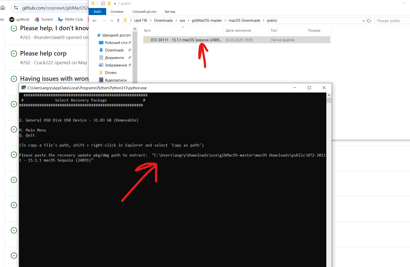

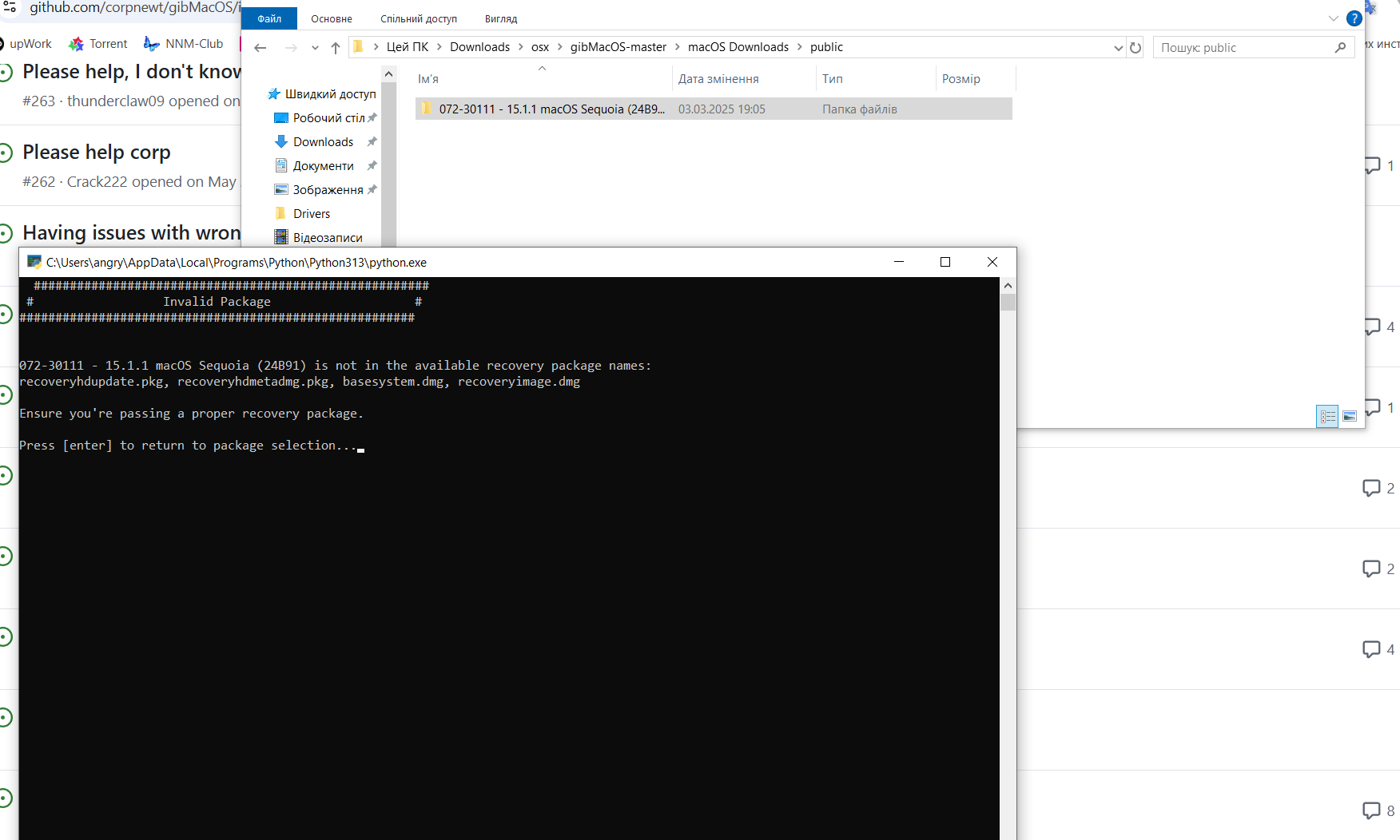

Andriy B. Posted March 3, 2025 Author Share Posted March 3, 2025 (edited) 4 hours ago, MaLd0n said: Some lan card dont work. Use one USB WIFI for now like t2u nano If u need connection to installer, use offline installer. Hello! I already wait on some simple RTL8111C, hope this be supported (i saw kext for it). Also can you provide bit more details about offline install? UPD: i try going over gibMacOS scrypt, but do not ge luck to create full install image Edited March 3, 2025 by Andriy B. Quote Link to comment https://www.insanelymac.com/forum/topic/360705-heed-help-with-asus-prime-b860m-a-intel-core-ultra-5-245k-radeon-rx-6700-xt/#findComment-2830681 Share on other sites More sharing options...

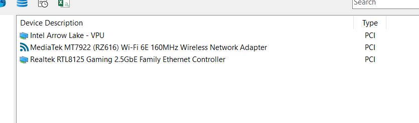

carlo_67 Posted March 3, 2025 Share Posted March 3, 2025 you should see the device id and vendor of your network card Realtek RTL8125? Quote Link to comment https://www.insanelymac.com/forum/topic/360705-heed-help-with-asus-prime-b860m-a-intel-core-ultra-5-245k-radeon-rx-6700-xt/#findComment-2830683 Share on other sites More sharing options...
Andriy B. Posted March 4, 2025 Author Share Posted March 4, 2025 18 hours ago, MaLd0n said: Some lan card dont work. Use one USB WIFI for now like t2u nano If u need connection to installer, use offline installer. Hello! So, in this moment i found way to pull full image, and looks system is up (still need make post install things, load without usb etc). Quote Link to comment https://www.insanelymac.com/forum/topic/360705-heed-help-with-asus-prime-b860m-a-intel-core-ultra-5-245k-radeon-rx-6700-xt/#findComment-2830704 Share on other sites More sharing options...

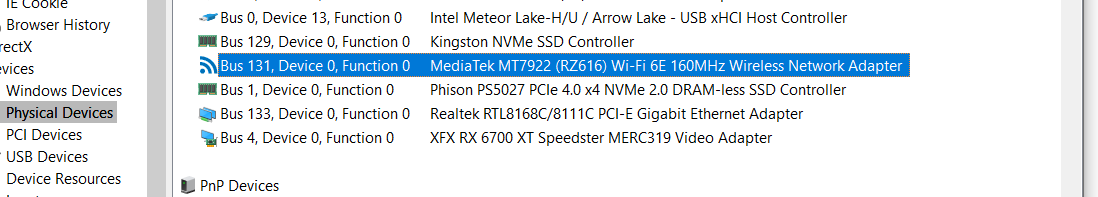

Andriy B. Posted March 16, 2025 Author Share Posted March 16, 2025 Hello! Still do not run Bluetooth & WIFi (( can any help with? Thanks! 2 Quote Link to comment https://www.insanelymac.com/forum/topic/360705-heed-help-with-asus-prime-b860m-a-intel-core-ultra-5-245k-radeon-rx-6700-xt/#findComment-2830931 Share on other sites More sharing options...
MaLd0n Posted March 16, 2025 Share Posted March 16, 2025 4 hours ago, Andriy B. said: Still do not run Bluetooth & WIFi (( can any help with? What card? 1 Quote Link to comment https://www.insanelymac.com/forum/topic/360705-heed-help-with-asus-prime-b860m-a-intel-core-ultra-5-245k-radeon-rx-6700-xt/#findComment-2830937 Share on other sites More sharing options...
Andriy B. Posted March 22, 2025 Author Share Posted March 22, 2025 Hello MaLdOn! MediaTek MT7922 (RZ616) Wi-Fi 6E 160MHz Wireless Network Adapter PCI 2 Quote Link to comment https://www.insanelymac.com/forum/topic/360705-heed-help-with-asus-prime-b860m-a-intel-core-ultra-5-245k-radeon-rx-6700-xt/#findComment-2831056 Share on other sites More sharing options...
MaLd0n Posted March 22, 2025 Share Posted March 22, 2025 No support for this 2 Quote Link to comment https://www.insanelymac.com/forum/topic/360705-heed-help-with-asus-prime-b860m-a-intel-core-ultra-5-245k-radeon-rx-6700-xt/#findComment-2831058 Share on other sites More sharing options...
