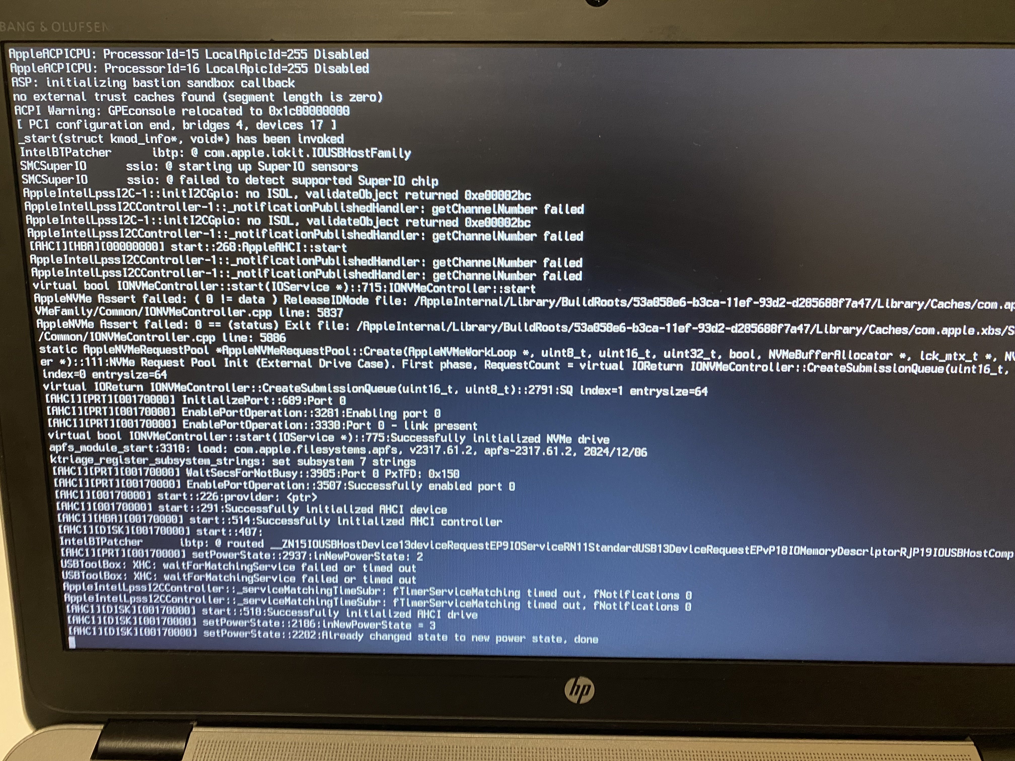

Flaffycowboy Posted February 7, 2025 Share Posted February 7, 2025 Hi everyone, I’m new to installing macOS on a non-Mac machine and need assistance with a problem I'm facing. I have created a config.plist file and an EFI folder, but every time I attempt to install any version of macOS, I encounter an error screen. Does anyone have suggestions on how to resolve this issue? I tried removing the Voodoo kext, but it didn't fix the problem. My notebook spec. HP EliteBook 850 G4 <<< CPU >>> CPU Model: Intel(R) Core(TM) i5-7300U CPU @ 2.60GHz CPU Codename: Kaby Lake-U/Y Thank you for your help! Quote Link to comment https://www.insanelymac.com/forum/topic/360646-help-needed-with-macos-installation-on-non-mac-machine/ Share on other sites More sharing options...

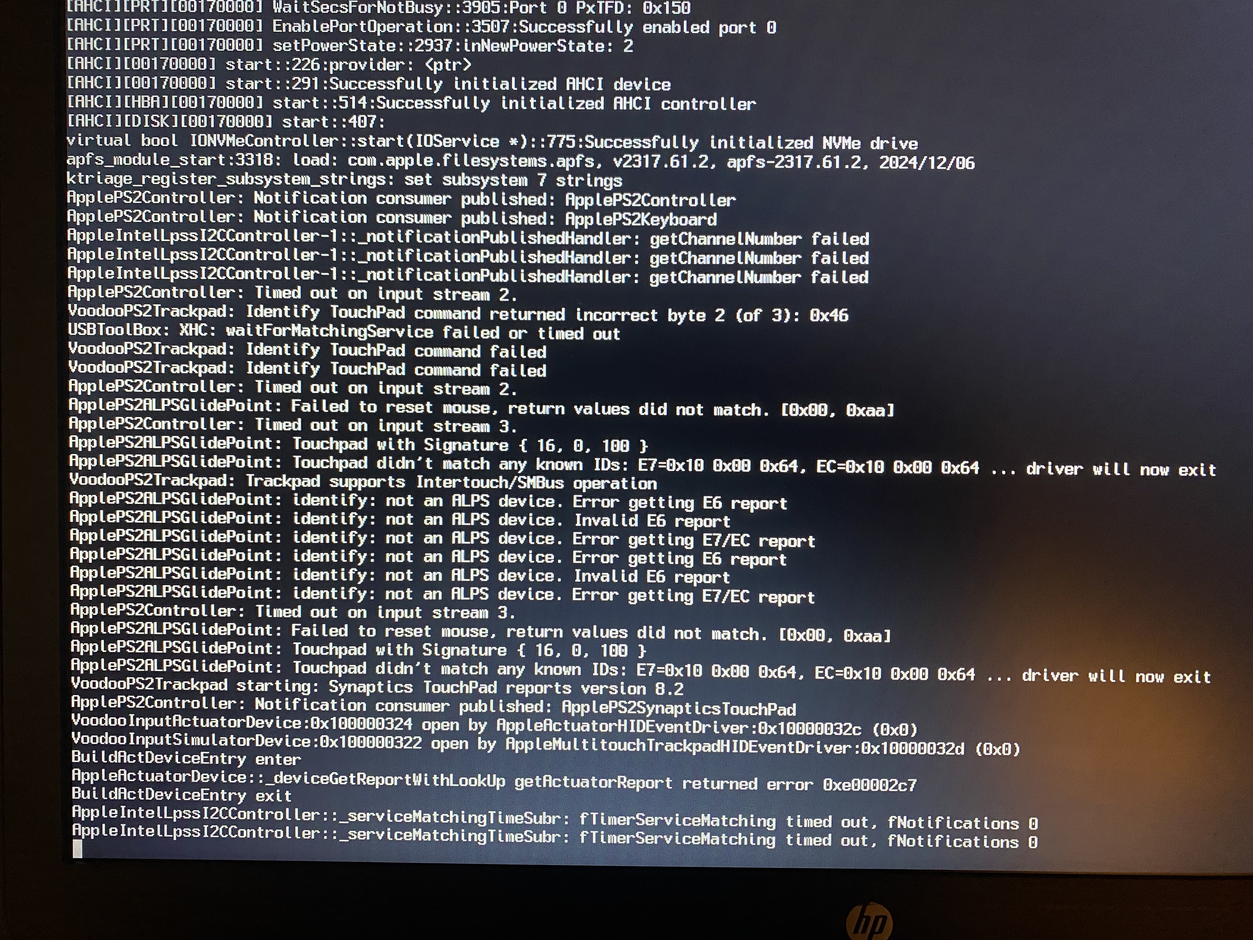

Slice Posted February 9, 2025 Share Posted February 9, 2025 First, you should remove VoodooPS2* kexts. It looks the stop is here. I see you have ALPS trackpad. Take the driver from my signature. You need a keyboard to install macOS. Take temporary any USB keyboard. Quote Link to comment https://www.insanelymac.com/forum/topic/360646-help-needed-with-macos-installation-on-non-mac-machine/#findComment-2830293 Share on other sites More sharing options...
Flaffycowboy Posted February 9, 2025 Author Share Posted February 9, 2025 (edited) 10 hours ago, Slice said: First, you should remove VoodooPS2* kexts. It looks the stop is here. I see you have ALPS trackpad. Take the driver from my signature. You need a keyboard to install macOS. Take temporary any USB keyboard. I have removed the VoodooPS2* kext now appears another problem i have attached photo below the text… Edited February 9, 2025 by Flaffycowboy Another problem appears Quote Link to comment https://www.insanelymac.com/forum/topic/360646-help-needed-with-macos-installation-on-non-mac-machine/#findComment-2830307 Share on other sites More sharing options...
