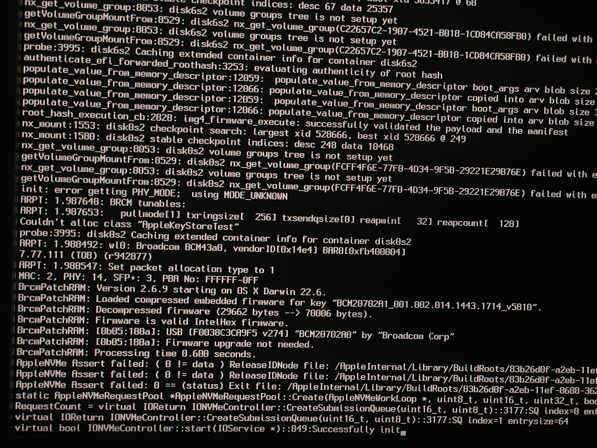

NeXtor Posted December 21, 2024 Author Share Posted December 21, 2024 I'm doing some tests with the two MaLd0n' EFIs. With VT-D ON and 4G decoding ON, no audio and no Intensity Pro 4K. With VT-D ON and 4G decoding OFF, no audio and no Intensity Pro 4K, but the first EFI won't boot the system. With VT-D OFF and 4G decoding ON, audio ok, synchronized with the video, all high and low audio frequencies excellent, but still no Intensity Pro 4K. With this smbios and VT-D off the PC performance seems good (compared to iMacPro1,1). With both EFIs at the first boot the system freezes during loading, almost always like in the attached photo, then it restarts and starts. Link to comment https://www.insanelymac.com/forum/topic/360395-alc1150-not-working-on-macos-ventura-x99/#findComment-2829069 Share on other sites More sharing options...
