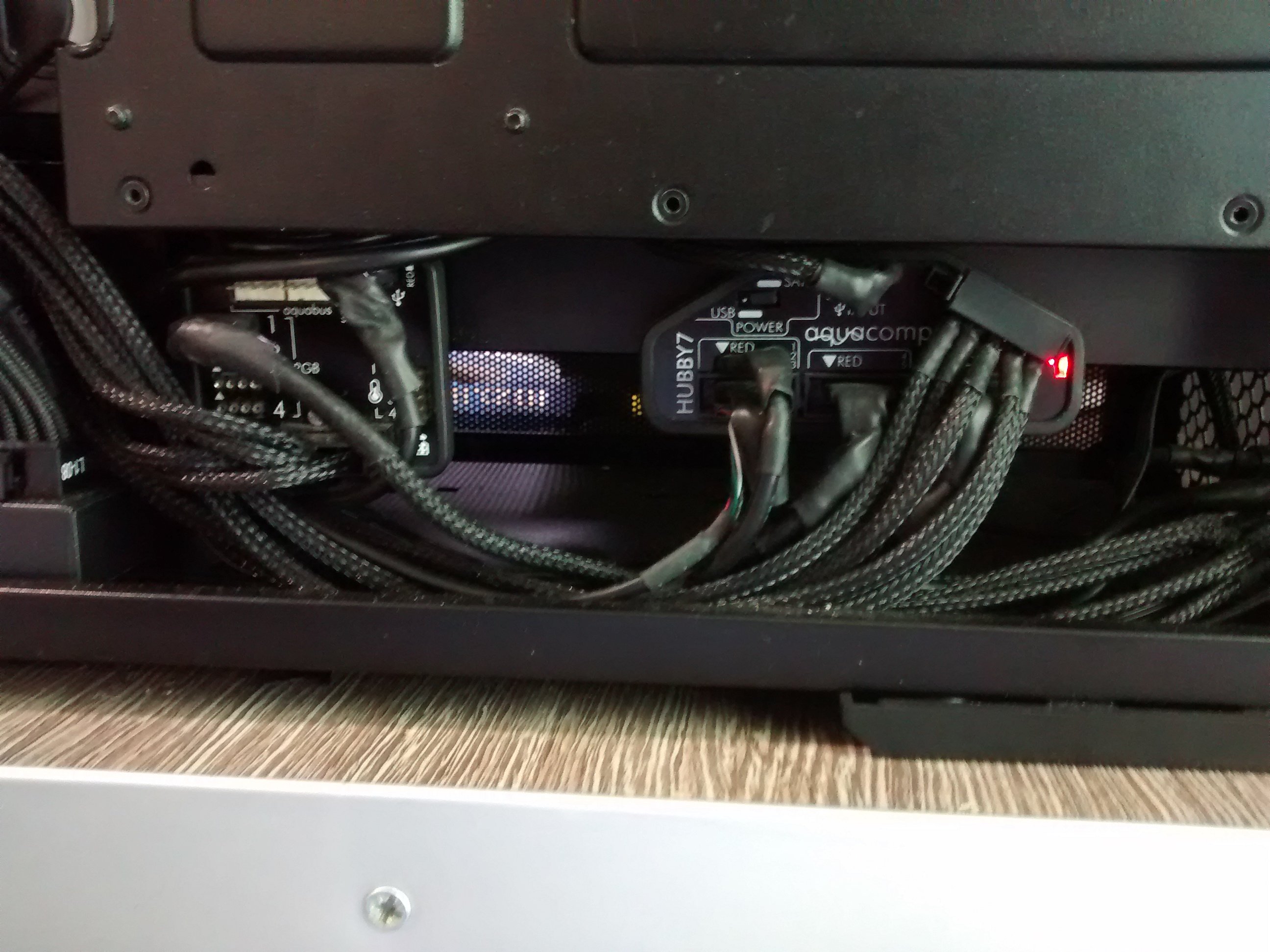

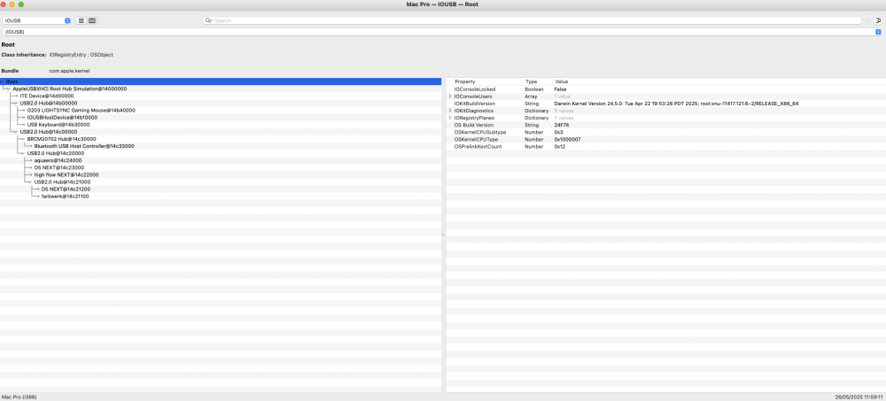

BALDY_MAN Posted May 26, 2025 Author Share Posted May 26, 2025 (edited) 18 minutes ago, BALDY_MAN said: @MaLd0n thank you for your time and kindness. I have just tried to efi file you made. still no sleep. (shuts down and reboots) but I have a setup using a splity 7 powered hub for the aqua computer and farbwerks. added screen shot from IORegisterry explorer update I managed to connect the blue tooth. here's a pic of my usb hub. Edited May 26, 2025 by BALDY_MAN Link to comment https://www.insanelymac.com/forum/topic/360231-patched-wifi-but-no-blue-toothsolved-by-mald0n-thank-you/#findComment-2832607 Share on other sites More sharing options...
