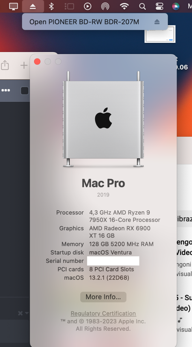

fabiosun Posted October 20, 2024 Share Posted October 20, 2024 @CC_333 it is a problem with some OSX version and it was a problem with different recorder brand (Pioneer for sure because i had it in the past) here to some infos: https://macos86.it/topic/6145-build-ryzen-9-79950x-asus-rog-x670e-hero/?do=findComment&comment=138608 here my old ventura with Pioneer BD recorder: Link to comment https://www.insanelymac.com/forum/topic/360133-my-sata-optical-drive-wont-work/#findComment-2826701 Share on other sites More sharing options...
