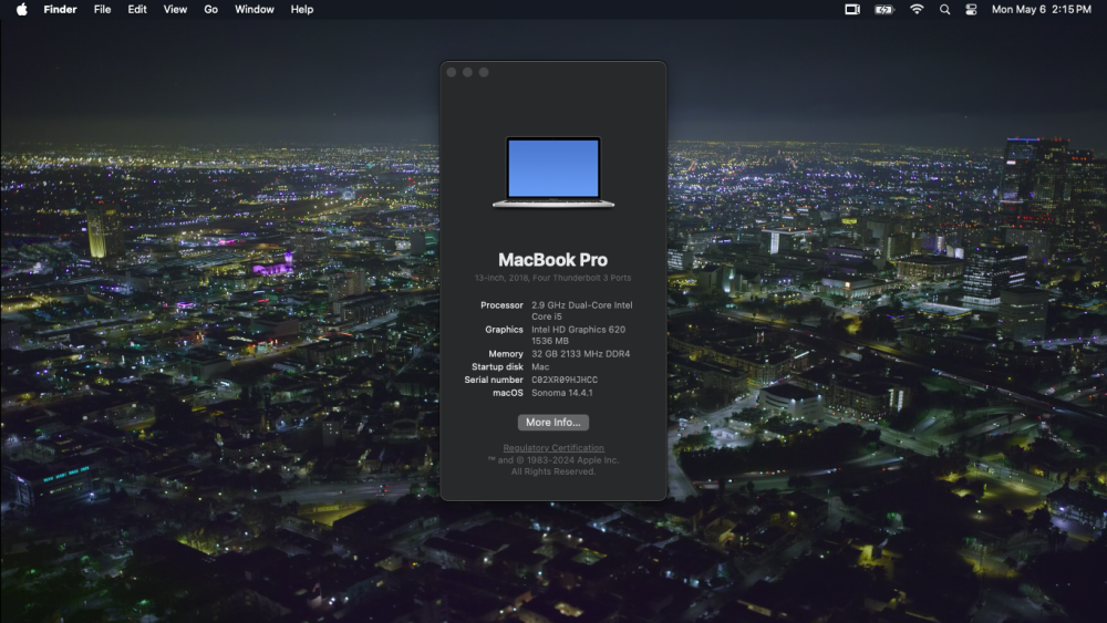

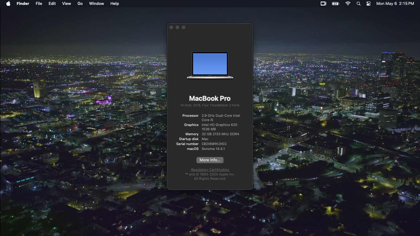

IHeartMacs Posted May 4, 2024 Author Share Posted May 4, 2024 (edited) Ok so I I updated my SMBIOS on Big Sur to 15,2 and was able to get the Sonoma installer after doing so. I remade the installer using chris111’s installer then replaced the EFI made with the installer with my updated EFI. I’m installing right now. Will report back soon. 🤞🏽 edit installed fine. Now I have to get WiFi to work. edit added kext BrcmFirmwareData BcrmPatchRam3 RealtekCardReader RealtekCardReaderFriend wifi not working edit added kext AirportBcrmFixup adding that kext makes the boot time longer Still no luck with WiFi edit removing 5 kext and installing OCLP edit resulting in boot loops Edited May 4, 2024 by IHeartMacs Quote Link to comment https://www.insanelymac.com/forum/topic/358875-i-need-help-building-efi-folder-for-sonoma-installer-i-just-created/#findComment-2819644 Share on other sites More sharing options...

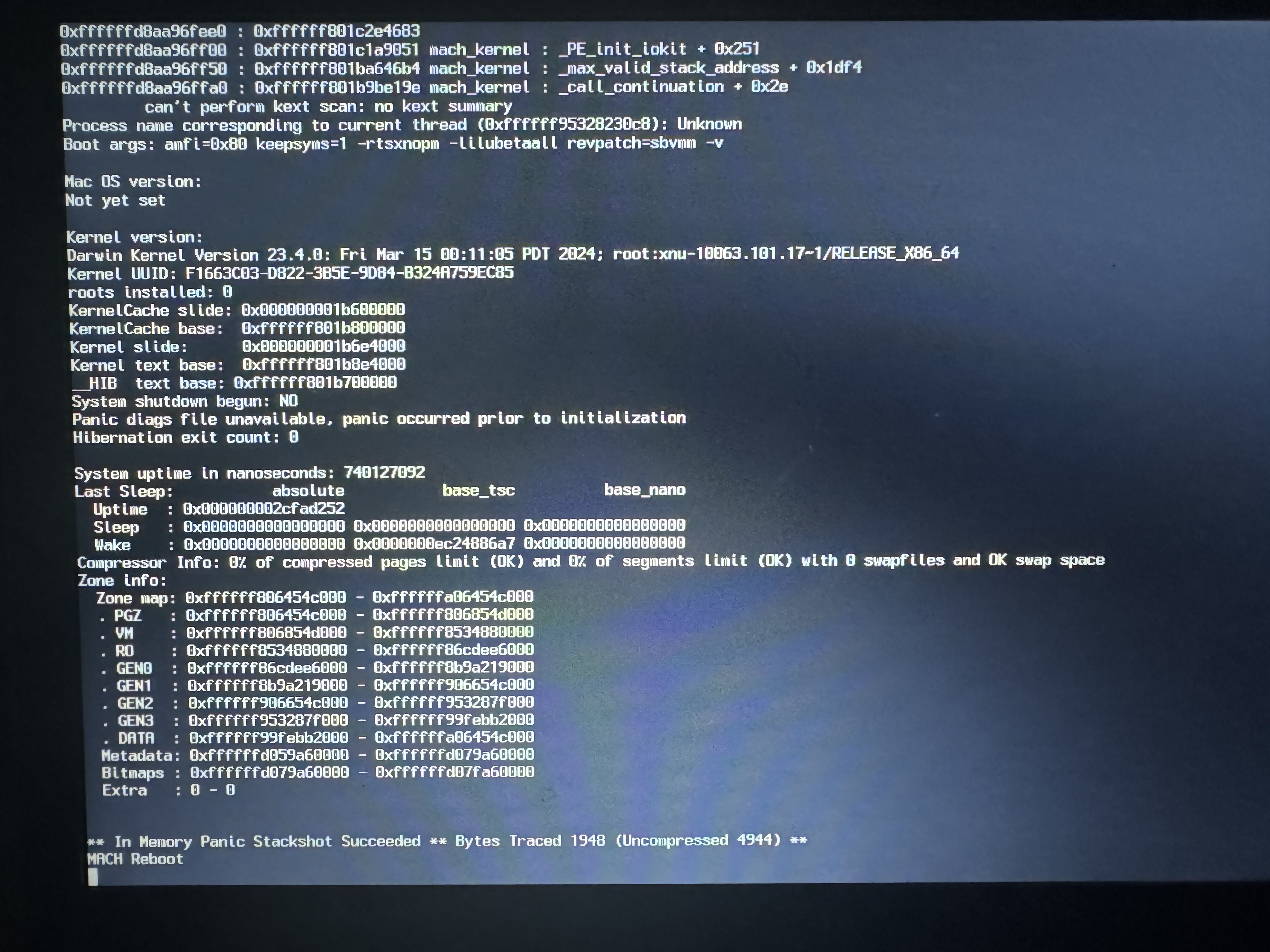

IHeartMacs Posted May 4, 2024 Author Share Posted May 4, 2024 Yeah that’s been saving my butt 31 minutes ago, eSaF said: Keep going, you'll get there eventually. A good tip is, when you have a good booting system, copy the bootable EFI to the EFI Partition of a spare USB Drive so that if/when you make changes and have a panic like a boot loop as you described, that USB Drive will rescue your system to a bootable state again. Good luck. So I installed Sonoma again then used Chris1111’s EFI and used my update SMBIOS and I’m getting a kernel panic Quote Link to comment https://www.insanelymac.com/forum/topic/358875-i-need-help-building-efi-folder-for-sonoma-installer-i-just-created/#findComment-2819660 Share on other sites More sharing options...

IHeartMacs Posted May 6, 2024 Author Share Posted May 6, 2024 (edited) On 5/4/2024 at 5:07 PM, chris1111 said: Hey your not need to modify the EFI if your use the good branch for Sonoma and BCM94360NG git clone --branch Broadcom-Wifi-Sonoma https://github.com/chris1111/HP-EliteBook-840-G4.git Wifi Bluetooth will work after installing OCLP Post an issue on github for any support of this program so I've tried copying HP-EliteBook-840-G4>Packages>OC-EFI>EFI over to my EFI and when booting it never gets passed all the coding. I've tried making OC from HP-EliteBook-840-G4>Create_App.command and when booting it never gets passed all the coding. I've tried making OC from HP-EliteBook-840-G4>Packages>OC-Package and when booting it never gets passed all the coding. I can only boot from my original EFI folder that was successful making Big Sur. and when I install OCLP I can’t even make it to the Apple logo. Last edit. For whatever reason resetting the ram breaks the installer. All I had to do to my old EFI folder was get the 2 kext for Broadcom wifi and put those in my kext folder change some things in OpenCore config and presto. Reached the promise land. Edited May 6, 2024 by IHeartMacs 1 Quote Link to comment https://www.insanelymac.com/forum/topic/358875-i-need-help-building-efi-folder-for-sonoma-installer-i-just-created/#findComment-2819743 Share on other sites More sharing options...
