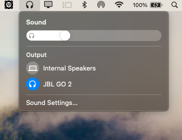

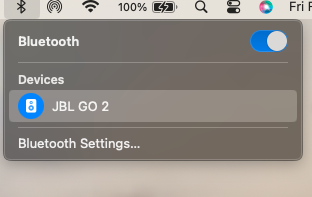

chris1111 Posted February 9, 2024 Share Posted February 9, 2024 @miliuco I dont have issue Sleep/Wake with AX200NGW -Wifi Bluetooth is also sleep from Lid HP EliteBook 840 G4 My JBL GO 2 turn to sleep I sse blinkin light on the speeker 1 Link to comment https://www.insanelymac.com/forum/topic/358671-sleep-instant-wake-when-using-intel-ax210-bluetooth/#findComment-2816613 Share on other sites More sharing options...

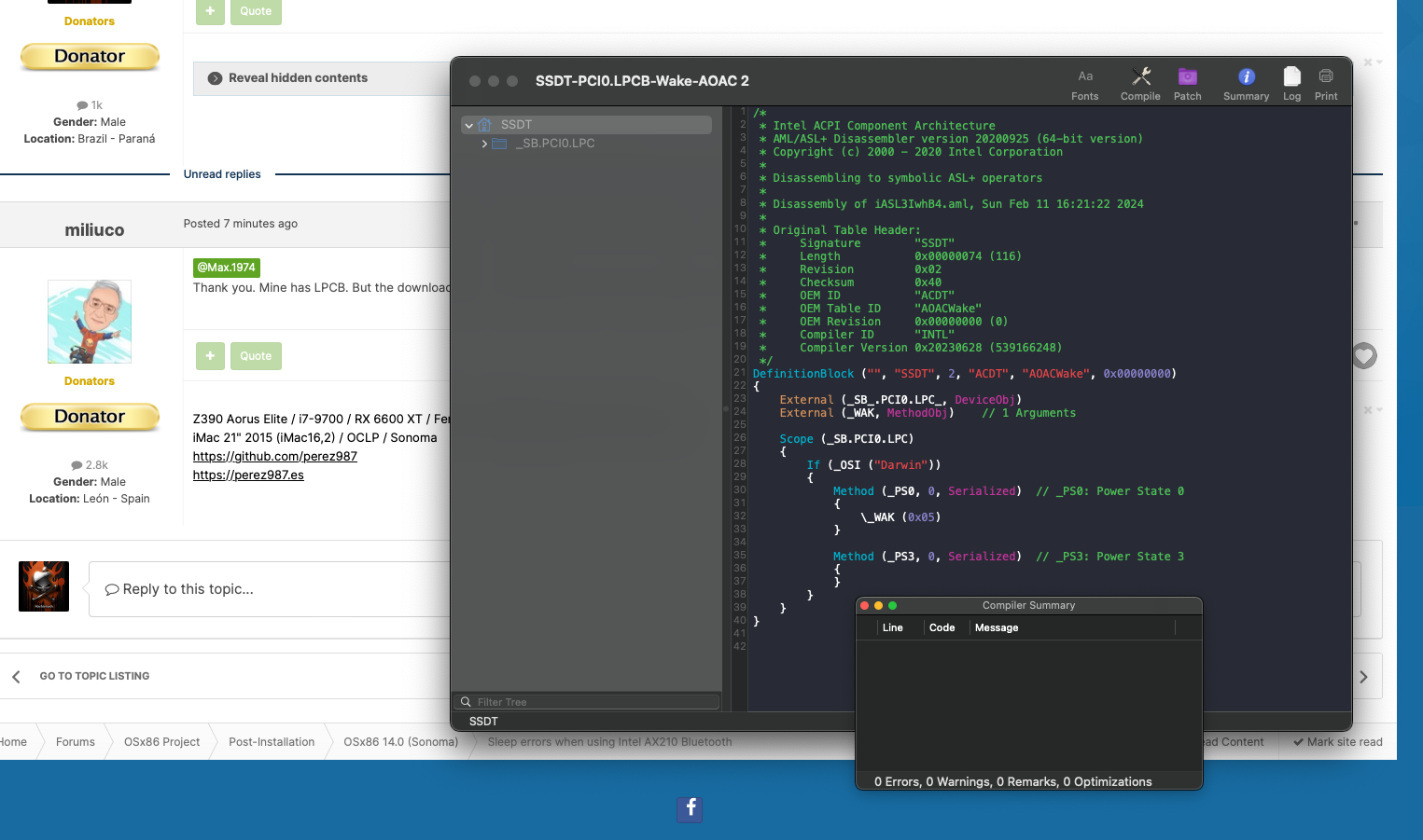

Max.1974 Posted February 11, 2024 Share Posted February 11, 2024 (edited) HI @miliuco my Master, so glad to help you. If you want check more SSDT patches of mine, this S3 that you refer im extract from my MacBook Air 2020 intel i7 Im sure that you fix that soon Im not use GPRW or UPRW on Laptop, because mine is _PRW. Im find another way. You can try use this too SSDT-PCI0.LPCB-Wake-AOAC.zip Edited February 11, 2024 by Max.1974 2 Link to comment https://www.insanelymac.com/forum/topic/358671-sleep-instant-wake-when-using-intel-ax210-bluetooth/#findComment-2816741 Share on other sites More sharing options...
Max.1974 Posted February 11, 2024 Share Posted February 11, 2024 Only need check if you DSDT declare LPCB or LPC Link to comment https://www.insanelymac.com/forum/topic/358671-sleep-instant-wake-when-using-intel-ax210-bluetooth/#findComment-2816753 Share on other sites More sharing options...
miliuco Posted February 11, 2024 Author Share Posted February 11, 2024 @Max.1974 Thank you. Mine has LPCB. But the downloaded ZIP is corrupted and I can't open the aml. Please redownload it. Before of this, test if it compiles right on your system. Link to comment https://www.insanelymac.com/forum/topic/358671-sleep-instant-wake-when-using-intel-ax210-bluetooth/#findComment-2816759 Share on other sites More sharing options...

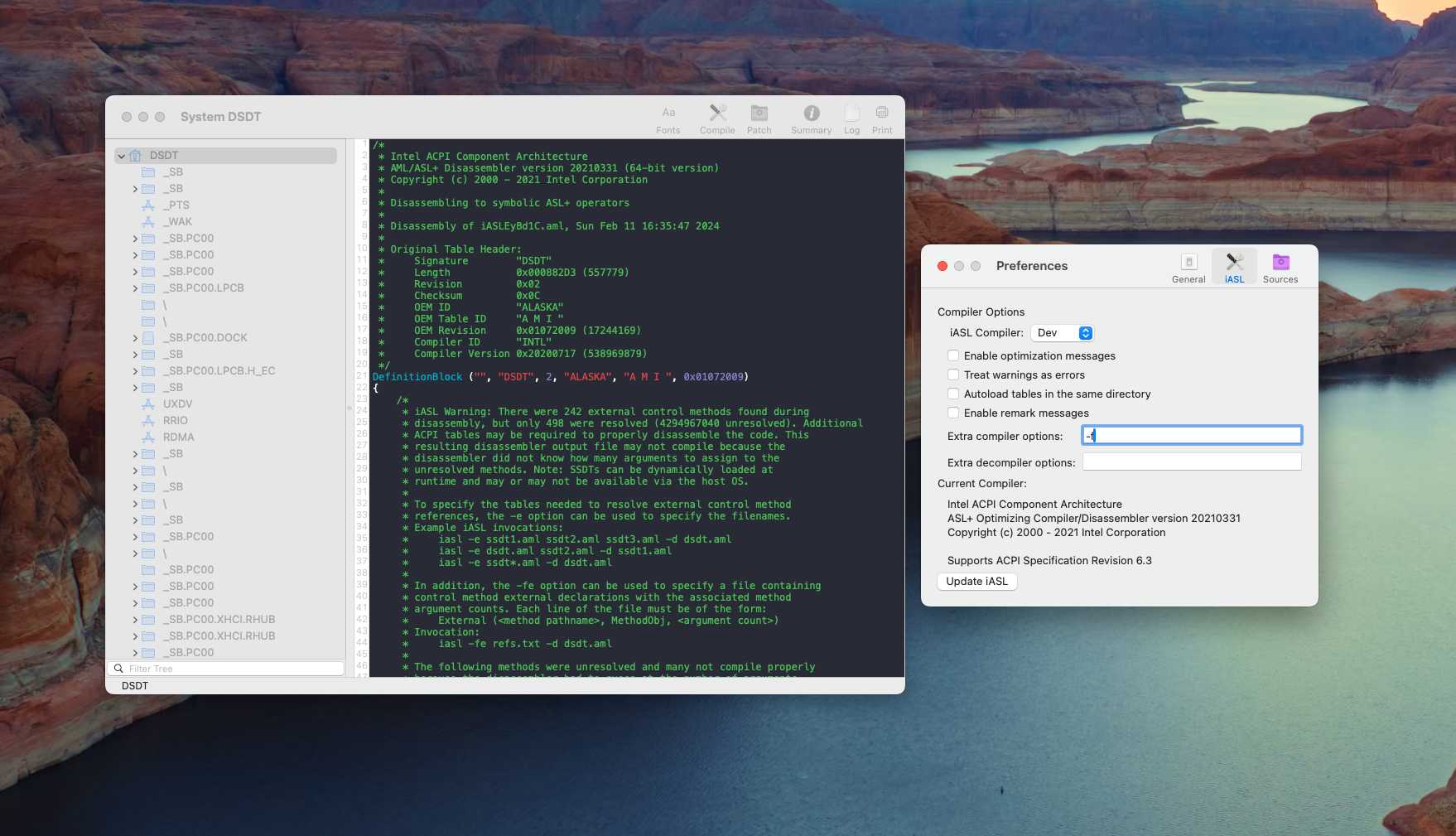

Max.1974 Posted February 11, 2024 Share Posted February 11, 2024 8 minutes ago, miliuco said: @Max.1974 Thank you. Mine has LPCB. But the downloaded ZIP is corrupted and I can't open the aml. Please redownload it. Before of this, test if it compiles right on your system. Hi my friend, here is all right but im sendo .dsl decompiled Spoiler SSDT-PCI0.LPCB-Wake-AOAC DSL.zip Link to comment https://www.insanelymac.com/forum/topic/358671-sleep-instant-wake-when-using-intel-ax210-bluetooth/#findComment-2816763 Share on other sites More sharing options...

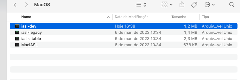

Max.1974 Posted February 11, 2024 Share Posted February 11, 2024 (edited) You can pass a few hours with fun reading here on source my friend https://github.com/jsassu20/OpenCore-HotPatching-Guide/tree/master/01-About AOAC If I can help you, just call me ok ? God job !! Im forgot said im using MaciAsl with DEV Mode Edited February 11, 2024 by Max.1974 1 Link to comment https://www.insanelymac.com/forum/topic/358671-sleep-instant-wake-when-using-intel-ax210-bluetooth/#findComment-2816767 Share on other sites More sharing options...
Max.1974 Posted February 11, 2024 Share Posted February 11, 2024 Im downloaded compile directly from ACPICA.ORG Spoiler Spoiler Link to comment https://www.insanelymac.com/forum/topic/358671-sleep-instant-wake-when-using-intel-ax210-bluetooth/#findComment-2816769 Share on other sites More sharing options...

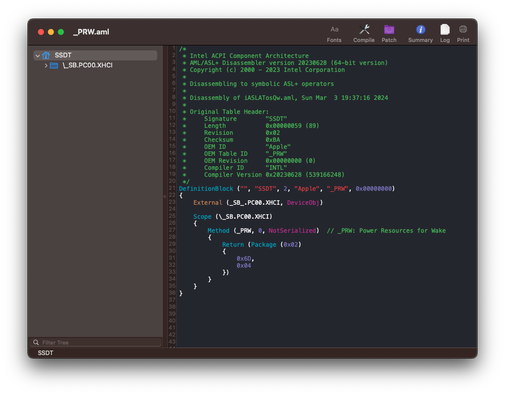

miliuco Posted March 3, 2024 Author Share Posted March 3, 2024 @MaLd0n Hello, I'm asking you without any obligation on your part, of course. About the summary I wrote in the linked post, do you know any way to have SSDT-GPRW to be able to properly sleep but without loosing the ability to wake up from mouse or keyboard? Note that I've tried too a DSDT made by you for my system a time ago, without success (no sleep as is or no wake from mouse or keyboard when adding SSDT-GPRW). Thank you very much. Link to comment https://www.insanelymac.com/forum/topic/358671-sleep-instant-wake-when-using-intel-ax210-bluetooth/#findComment-2817594 Share on other sites More sharing options...

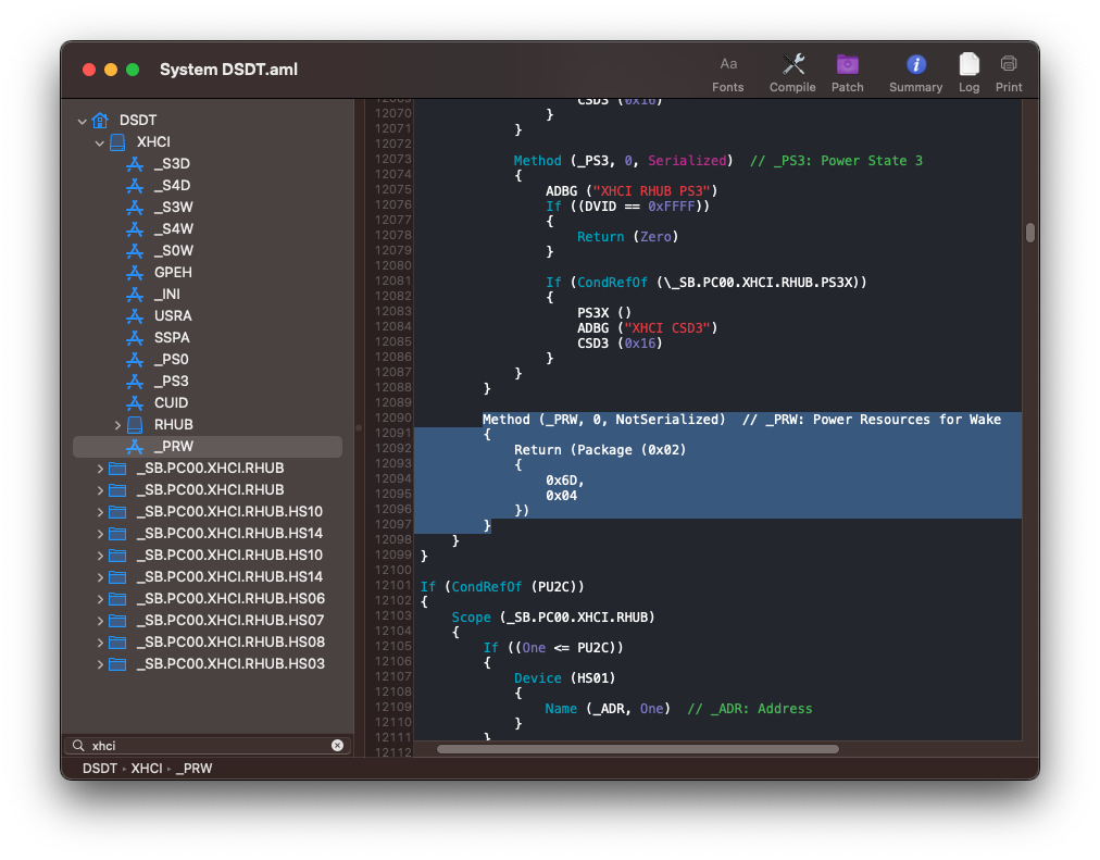

MaLd0n Posted March 3, 2024 Share Posted March 3, 2024 Try to kill all _PRWs with SSDT and ACPI Rename or DSDT and add new _PRW. -SSDT ACPI Rename _PRW to XPRW Quote <dict> <key>Base</key> <string></string> <key>BaseSkip</key> <integer>0</integer> <key>Comment</key> <string>_PRW to XPRW</string> <key>Count</key> <integer>0</integer> <key>Enabled</key> <true/> <key>Find</key> <data>X1BSVw==</data> <key>Limit</key> <integer>0</integer> <key>Mask</key> <data></data> <key>OemTableId</key> <data></data> <key>Replace</key> <data>WFBSVw==</data> <key>ReplaceMask</key> <data></data> <key>Skip</key> <integer>0</integer> <key>TableLength</key> <integer>0</integer> <key>TableSignature</key> <data></data> </dict> and SSDT with this Quote Scope (\_SB.PC00.XHCI) <--- (Need correct adress) { Method (_PRW, 0, NotSerialized) // _PRW: Power Resources for Wake { Return (Package () { 0x6D, 0x04 }) } } _PRW.aml.zip Spoiler -DSDT U can use this to remove all _PRWs (If u using WAKE from LAN for example u need stay with _PRW inside Ethernet device Quote into_all method label _PRW remove_entry; into_all all code_regex Name.*_PRW.*\n.*\n.*\n.*\n.*\}\) remove_matched And this to add new _PRW into XHCI device @14 Quote into device name_adr 0x00140000 insert begin Method(_PRW) { Return(Package() { 0x6D, 4 }) } end Spoiler 3 Link to comment https://www.insanelymac.com/forum/topic/358671-sleep-instant-wake-when-using-intel-ax210-bluetooth/#findComment-2817597 Share on other sites More sharing options...
