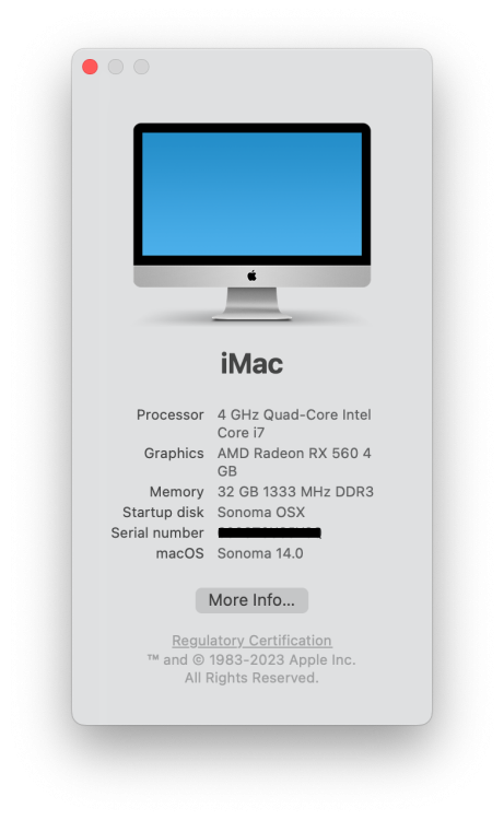

vamose Posted December 29, 2023 Share Posted December 29, 2023 (edited) Unable to pass the apple logo screen. Reboots itself. SMBIOS - iMac 19,1 Gigabyte MOBO: B85M-D3H Bios Ver: F15 BIOS Date: 08/20/2015 BIOS ID 8A02AG0C Intel ® Core TM i7-4790K CPU @ 4.00 Ghz. GPU XFX RX580 8GB Able to boot with XFX RX 560 - flashed with Sapphire RX560 Using OpenCore Kext used: Lilu.kext RealtekRTL8111.kext VirtualSMC.kext Whatever Green.Kext Any possible solution? Attached is the EFI folder copy. EFI.zip Edited December 29, 2023 by vamose additional information added Link to comment https://www.insanelymac.com/forum/topic/358365-xfx-rx580-sonoma-140/ Share on other sites More sharing options...

vamose Posted December 30, 2023 Author Share Posted December 30, 2023 Thanks for your help. Rx580 works, after the VBIOS upgrade. Request if you can check the attached EFI (in the first message) and help remove unnecessary line items. Link to comment https://www.insanelymac.com/forum/topic/358365-xfx-rx580-sonoma-140/#findComment-2814979 Share on other sites More sharing options...
