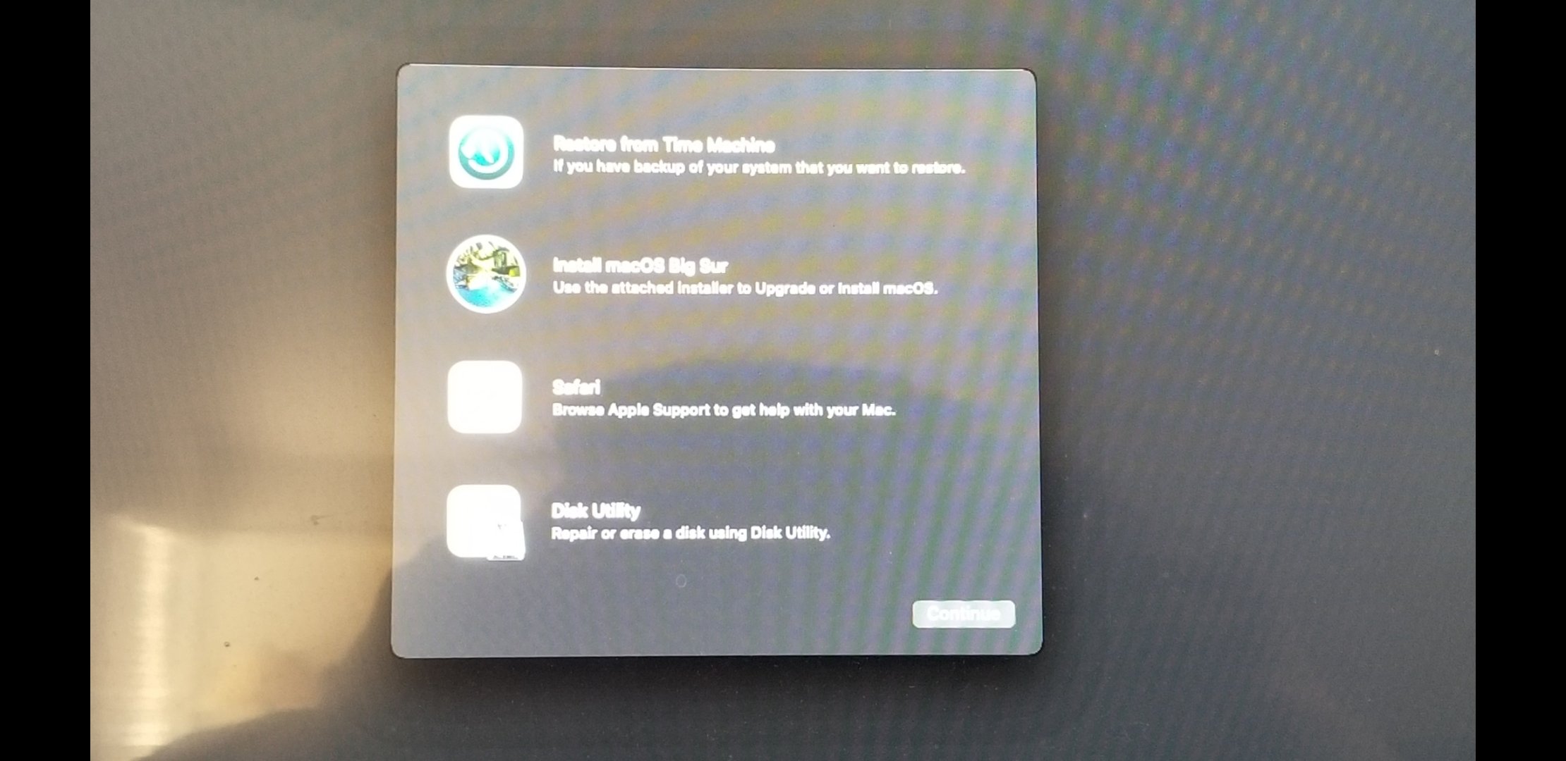

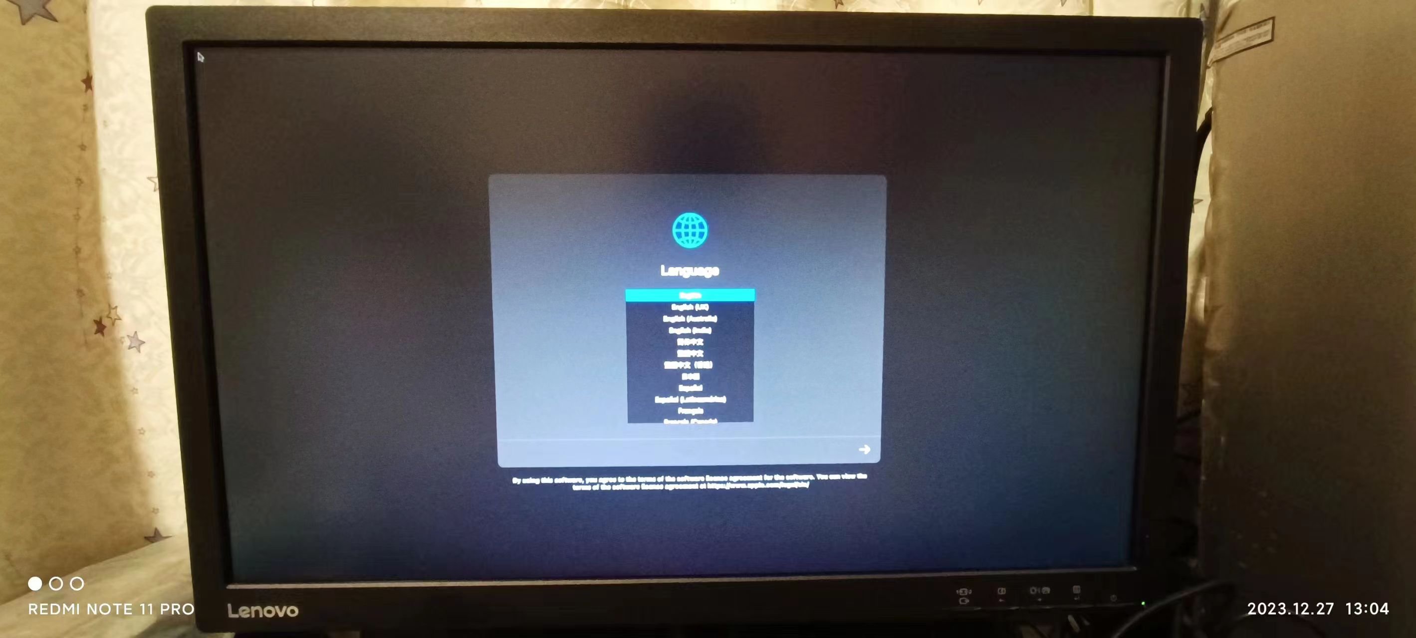

lscn Posted December 28, 2023 Share Posted December 28, 2023 Hello, everyone! I also have an hp z800, and I successfully installed 10.13.6 with clover two years ago. Recently it was having some problems and I decided to use opencore to install Big Sur (since my graphics card is 650ti and seems to only support macOS 11). After reading various materials, I made it smoothly to the language selection interface, where the mouse and keyboard failed . I tried to customize the usb interface but failed, and various methods were ineffective. Like Keyboard and Mouse broken in Big Sur What's the problem? Thank you very much! 1. Machine configuration HP Z800 Workstation Mini Tower CPU: Intel Xeon E5540@2.53GHz (X2) Motherboard: HP 0AECh (ICH10R) Graphics card: NVIDIA GeForce GTX 650 Ti BOOST (2GB/Colorful) Memory: 16 GB (FLASH 2MB/Samsung DDR3 1333MHz 2GB x 2/ Unknown DDR3 1333MHz 2GB x 4/Micron DDR3 1333MHz 2GB x 2) Hard Drive:Western Digital WD10EZEX-08M2NA0 (1 TB)/Windows 7 Ultimate 64-bit SP1 (DirectX 11),The Seagate ST3500418AS(500 GB)X3 does not use raid Display: Lenovo LEN60EA T2224r (21.5-inch) Optical drive: HP DVD A DH16AAL DVD burner Sound card: Realtek ALC262 @ Intel ICH10 hi-fi audio Network card: Broadcom BCM5764 NetXtreme Gigabit Ethernet/HP 2. Software version opencore 0.9.6 debug lilu, virtualsmc, whatevergreen, applealc are all the latest debug versions 3, bios 786G5 v03.61- should be the latest version 4. EFIEFI.rar Quote Link to comment https://www.insanelymac.com/forum/topic/358353-problem-big-sur-intallation-on-hp-z800/ Share on other sites More sharing options...
Slice Posted December 28, 2023 Share Posted December 28, 2023 I encountered such problem on my X79: keyboard and mouse works until language chooser. Resolved by DSDT correction. Quote Link to comment https://www.insanelymac.com/forum/topic/358353-problem-big-sur-intallation-on-hp-z800/#findComment-2814913 Share on other sites More sharing options...
lscn Posted December 28, 2023 Author Share Posted December 28, 2023 22 minutes ago, Slice said: I encountered such problem on my X79: keyboard and mouse works until language chooser. Resolved by DSDT correction. Thank you for your reply! Should I modify the usb interface in dsdt? Quote Link to comment https://www.insanelymac.com/forum/topic/358353-problem-big-sur-intallation-on-hp-z800/#findComment-2814914 Share on other sites More sharing options...
Slice Posted December 28, 2023 Share Posted December 28, 2023 Yes, part of ACPI describing USB interfaces. Quote Link to comment https://www.insanelymac.com/forum/topic/358353-problem-big-sur-intallation-on-hp-z800/#findComment-2814921 Share on other sites More sharing options...

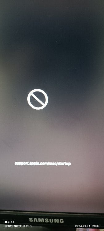

lscn Posted January 4, 2024 Author Share Posted January 4, 2024 On 12/29/2023 at 11:00 AM, sok5 said: You may try my efi preinstall Big Sur preinstall _big Sur 2.zip 9.1 MB · 4 downloads According to the steps you explained in another topic, I made the big sur installation USB disk, and used the pre install EFI you provided here, the mouse and keyboard can work. After the first and second phases (29 minutes left...), The screen turned black, the system had no signal output to the monitor, and after manual restart, this interface appeared. Because my hardware is different from yours, such as the graphics card is not 580, and there is no usb3.0 expansion card installed, I modified the config.list with OCC to disable some drivers and kexts, but it seems that these actions did not work. So, the key problem I want to solve now is how to drive the mouse and keyboard in the language selector interface, and figure out which drivers and kext drive them here. With that out of the way, I might be able to install the system in minimal mode first and then improve it. This is probably better than using your EFI directly. Can you give me some help? For example, in order to drive a usb mouse and usb keyboard in the language selector interface, which drivers and kext in your EFI must be included? Thank you very much! Quote Link to comment https://www.insanelymac.com/forum/topic/358353-problem-big-sur-intallation-on-hp-z800/#findComment-2815181 Share on other sites More sharing options...
Slice Posted January 4, 2024 Share Posted January 4, 2024 No drivers, no kexts. You have to fix DSDT or write new SSDT. Else your USB keyboard and mouse will freeze at language chooser. Quote Link to comment https://www.insanelymac.com/forum/topic/358353-problem-big-sur-intallation-on-hp-z800/#findComment-2815183 Share on other sites More sharing options...

sok5 Posted January 4, 2024 Share Posted January 4, 2024 (edited) you may try this latest EFI (OpenCore 0.9.7) install Big Sur & Monterey. I removed usb3(XhciDxe.efi) to make usb1 working. Big Sur USB1.zip Edited January 4, 2024 by sok5 Quote Link to comment https://www.insanelymac.com/forum/topic/358353-problem-big-sur-intallation-on-hp-z800/#findComment-2815188 Share on other sites More sharing options...

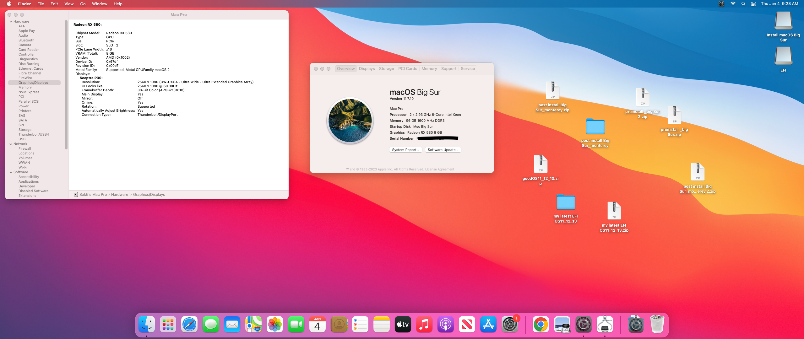

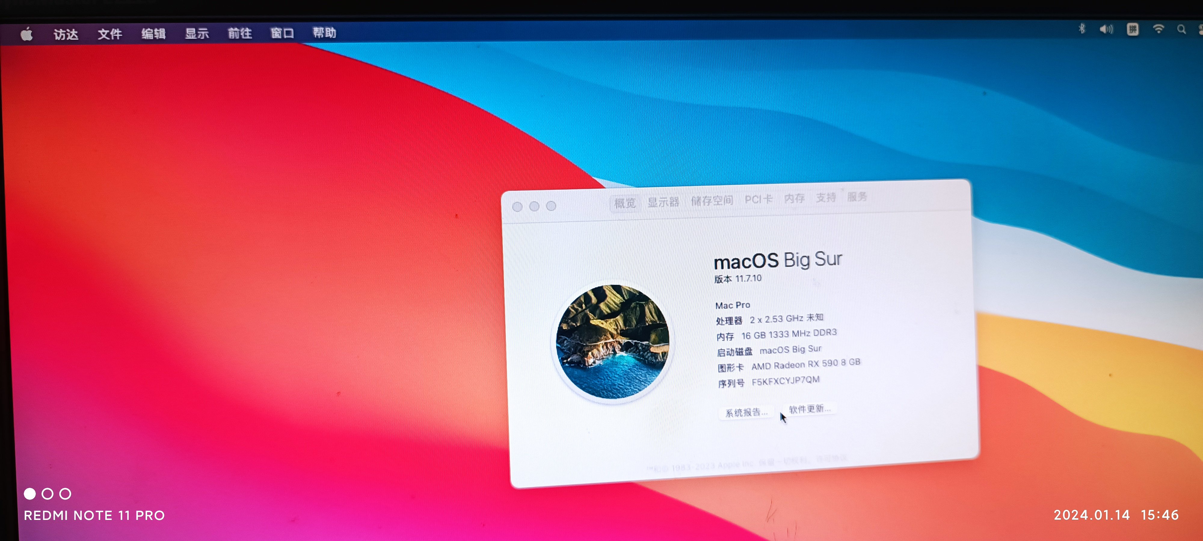

lscn Posted January 8, 2024 Author Share Posted January 8, 2024 I have successfully installed Big Sur and the graphics card is Colorful gtx 650ti boost. Today, I tried to use the newly bought sapphire rx590 8g 12nm, and then I couldn't enter the desktop, and the screen was black. Quote Link to comment https://www.insanelymac.com/forum/topic/358353-problem-big-sur-intallation-on-hp-z800/#findComment-2815313 Share on other sites More sharing options...
lscn Posted January 8, 2024 Author Share Posted January 8, 2024 On 1/5/2024 at 12:07 AM, Slice said: No drivers, no kexts. You have to fix DSDT or write new SSDT. Else your USB keyboard and mouse will freeze at language chooser. Thank you! I used sok5's efi directly and solved the problem. Quote Link to comment https://www.insanelymac.com/forum/topic/358353-problem-big-sur-intallation-on-hp-z800/#findComment-2815314 Share on other sites More sharing options...

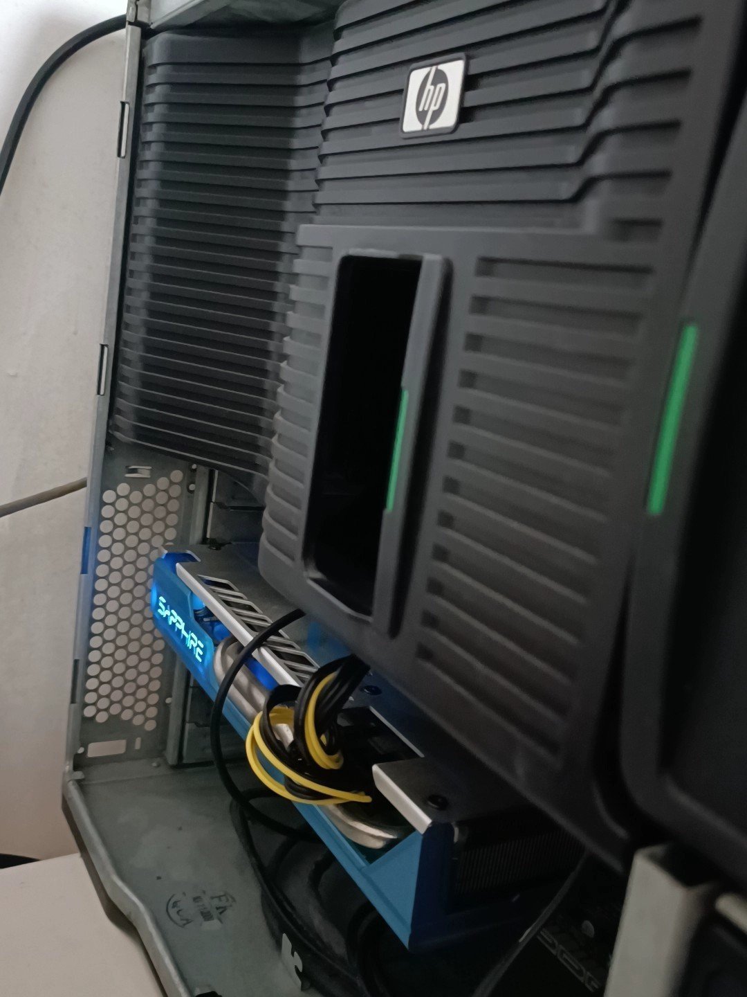

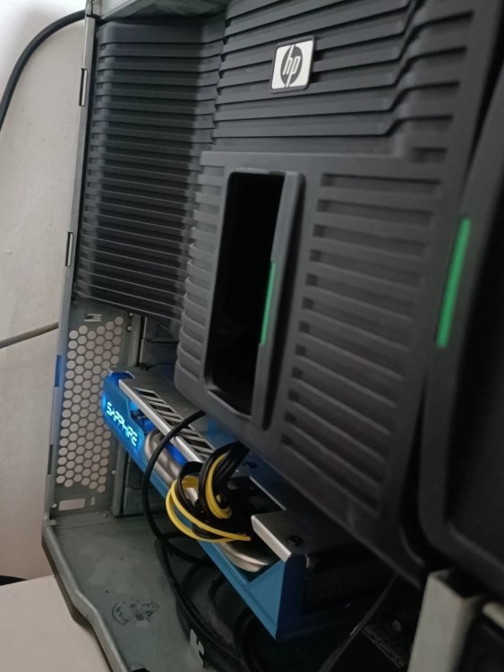

lscn Posted January 13, 2024 Author Share Posted January 13, 2024 On 1/9/2024 at 2:04 AM, sok5 said: I tried pci m.2 nvme, it doesn't work. Z800 doesn't support m.2. A few days passed and I still couldn't drive the rx590. Whenever you get close to the desktop, the screen goes black, and the system seems to be responsive. Quote Link to comment https://www.insanelymac.com/forum/topic/358353-problem-big-sur-intallation-on-hp-z800/#findComment-2815497 Share on other sites More sharing options...
lscn Posted January 13, 2024 Author Share Posted January 13, 2024 17 minutes ago, lscn said: A few days passed and I still couldn't drive the rx590. Whenever you get close to the desktop, the screen goes black, and the system seems to be responsive. I noticed that the official documentation list of gpu support includes Polaris 10,20, but not Polaris 30, which happens to be the rx590 core. Is this the cause?Shall I write the rx580 bios to the graphics card? Quote Link to comment https://www.insanelymac.com/forum/topic/358353-problem-big-sur-intallation-on-hp-z800/#findComment-2815498 Share on other sites More sharing options...

lscn Posted January 14, 2024 Author Share Posted January 14, 2024 13 hours ago, sok5 said: May be you should try Os Ventura https://youtu.be/C0le0DwSTmM?si=1cjp_8DZQ0rxQgG7 Today, the last time I tried to enter big sur, it was the same black screen. When I came back from doing other things, I clicked the mouse, and then the login interface was displayed. Yes, the mouse woke up after the login interface was hibernated. What is the reason for this? Quote Link to comment https://www.insanelymac.com/forum/topic/358353-problem-big-sur-intallation-on-hp-z800/#findComment-2815522 Share on other sites More sharing options...
lscn Posted January 25, 2024 Author Share Posted January 25, 2024 I used a DP to DVI cable, problem solved. Quote Link to comment https://www.insanelymac.com/forum/topic/358353-problem-big-sur-intallation-on-hp-z800/#findComment-2815864 Share on other sites More sharing options...
