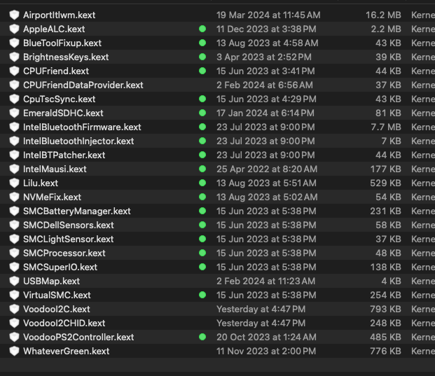

the new i2c kexts dont work for me,

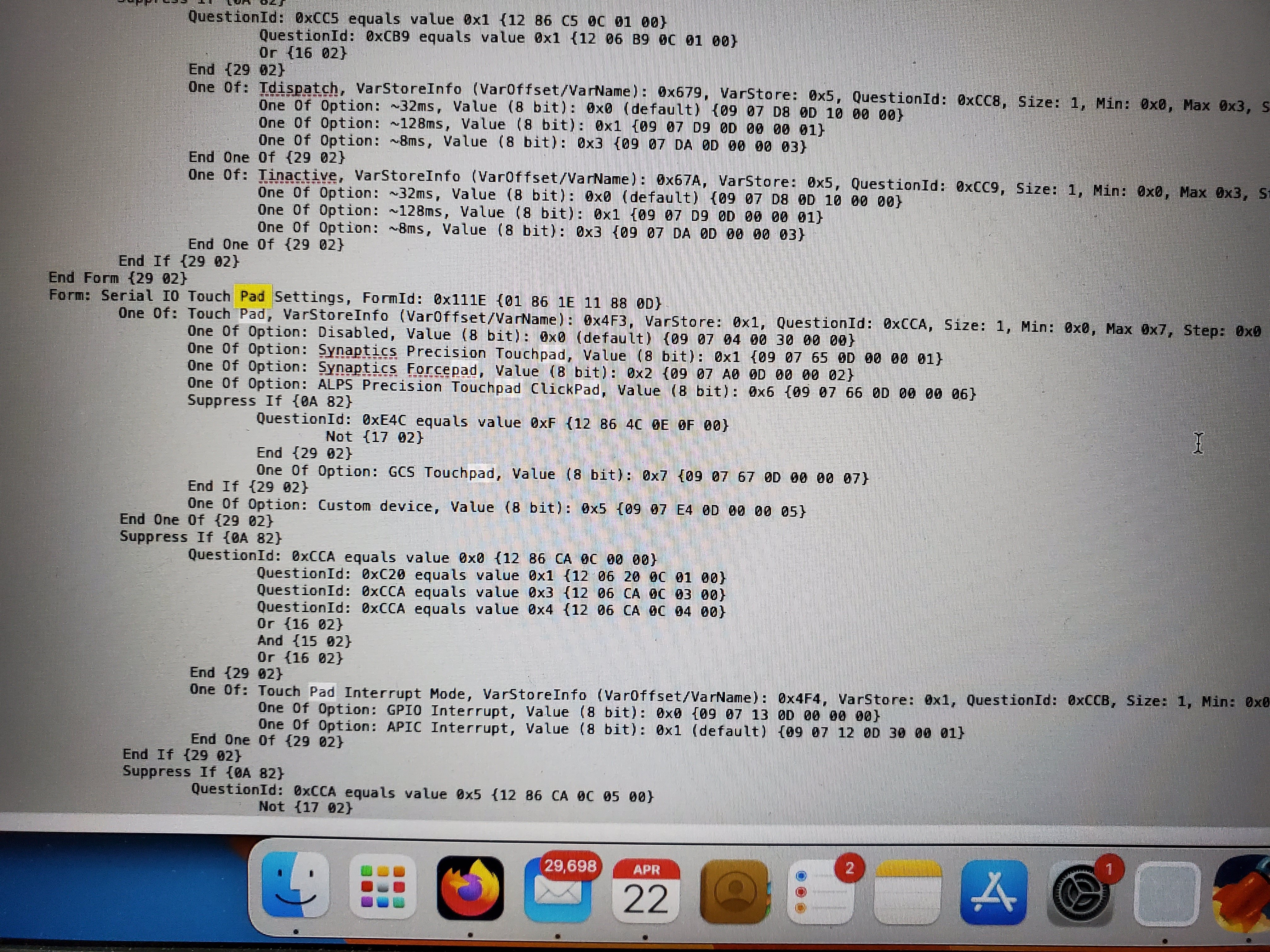

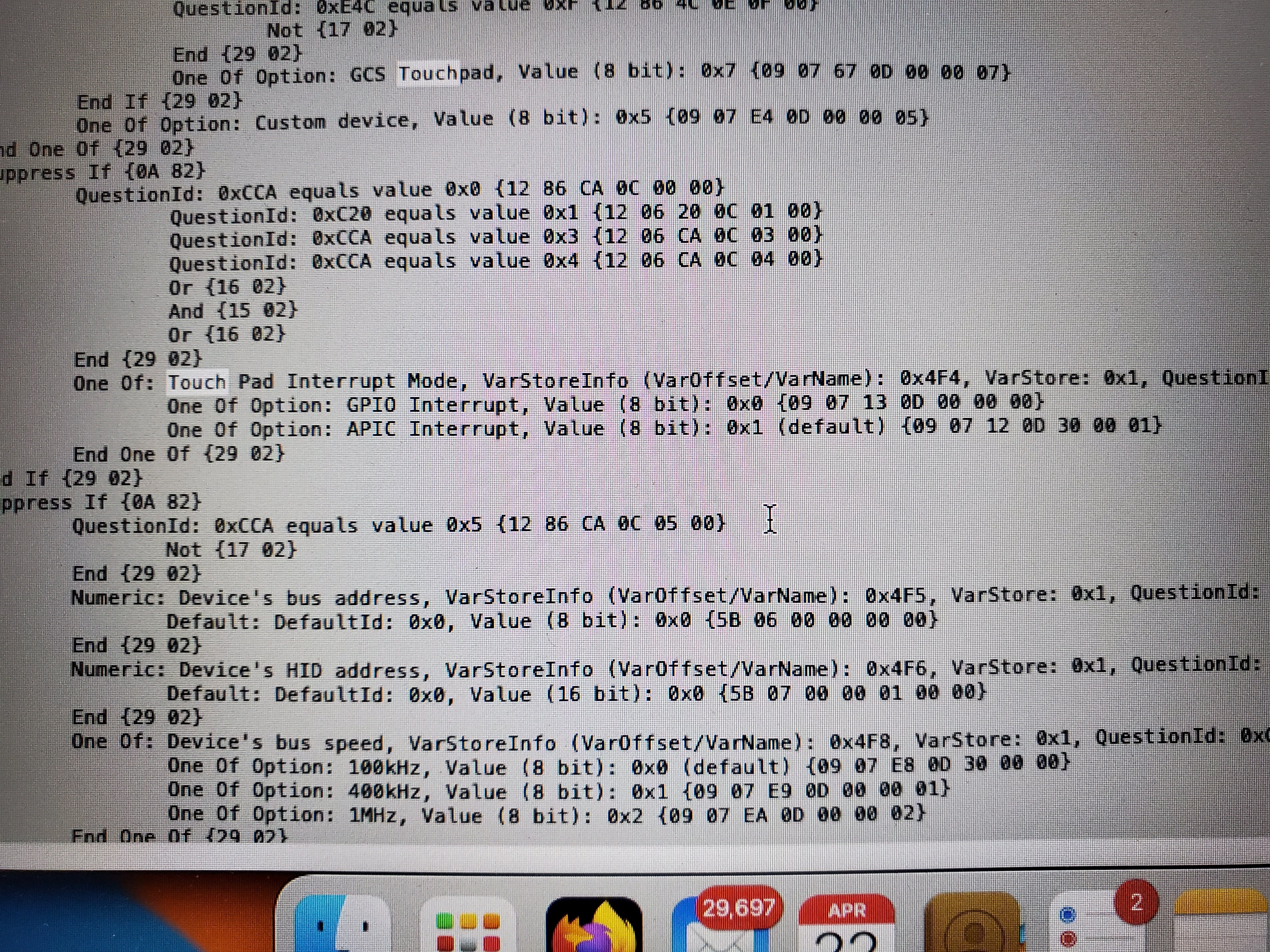

is it using GPIO or APIC interrupts? I may have to mod Bios to enable either.

I have tried by using ssdt time and then trying to edit the below section, see my striped down efi attached as well.

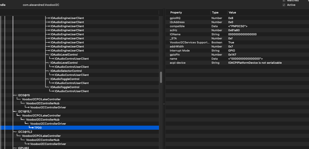

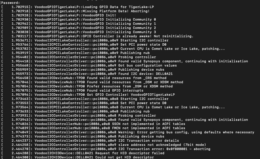

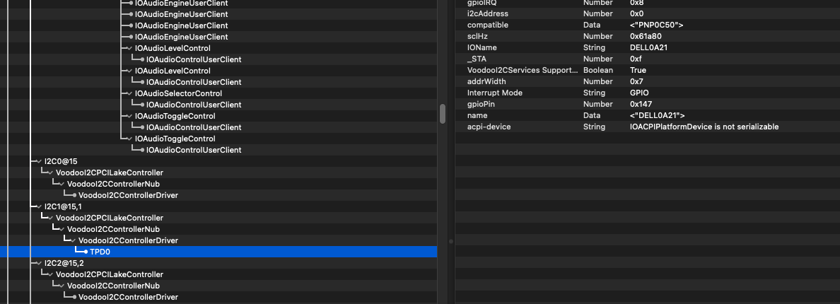

Not sure if its because its a dell machine and its PC00 instead of PCI0, but the I2C kexts are not showing up in the dmesg log. as being loaded, ioreg reports the device attaching though....
Big-MacBook-Air ~ % sudo dmesg | grep -i I2C
Password:
[  168.038813]: 1 duplicate report for Sandbox: airportd(219) deny(1) file-read-xattr /usr/sbin/bluetoothdSandbox: com.apple.quicklook.ThumbnailsAg(432) deny(1) file-read-xattr /Users/big/Library/Mobile Documents3 duplicate reports for Sandbox: com.apple.quicklook.ThumbnailsAg(432) deny(1) file-read-xattr /Users/big/Library/Mobile DocumentsSandbox: com.apple.quicklook.ThumbnailsAg(432) deny(1) file-read-xattr /Users/big/Downloads/VoodooI2CHID.kextSandbox: com.apple.quicklook.ThumbnailsAg(432) deny(1) file-read-xattr /Users/big/Downloads/VoodooI2C.kextSandbox apply: CSExattrCryptoService[694] <bytes>LQM-WiFi: BE : Count: 0 avgLatencyMs:0 maxLatencyMs:0

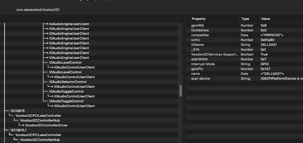

kext view
@Mastachief
Try using the SSDT I created below.
SSDT-TPD0.aml

And, DebugEnhancer.kext is required to print VoodooI2C's Dmesg log on the terminal.
With DebugEnhancer.kext applied, run the command below in the terminal.
sudo dmesg | grep "Voodoo"
Edited by shl628
See below;
Last login: Tue Apr 30 00:40:07 on console
big@Big-MacBook-Air ~ % sudo dmesg | grep "Voodoo"
Password:
[    1.557693]: VoodooGPIOTigerLakeLP::Loading GPIO Data for TigerLake-LP
[    1.557696]: VoodooGPIOTigerLakeLP::Missing Platform Data! Aborting!
[    1.557706]: VoodooGPIOTigerLakeLP::VoodooGPIO Init!
[    1.557708]: VoodooGPIOTigerLakeLP::VoodooGPIO Initializing Community 0
[    1.557741]: VoodooGPIOTigerLakeLP::VoodooGPIO Initializing Community 1
[    1.557768]: VoodooGPIOTigerLakeLP::VoodooGPIO Initializing Community 2
[    1.557790]: VoodooGPIOTigerLakeLP::VoodooGPIO Initializing Community 3
[    1.558822]: VoodooGPIOTigerLakeLP::GPIO Controller is already awake! Not reinitializing.
[    1.804204]: VoodooI2CPCILakeController::pci8086,a0e9 Starting I2C controller
[    1.804729]: VoodooI2CPCILakeController::pci8086,a0ea Starting I2C controller
[    1.804757]: VoodooI2CPCILakeController::pci8086,a0ea Set PCI power state D0
[    1.804760]: VoodooI2CPCILakeController::pci8086,a0ea Current CPU is Comet Lake or Ice Lake, patching...
[    1.804829]: VoodooI2CPCILakeController::pci8086,a0ea Publishing nub
[    1.804877]: VoodooI2CPCILakeController::pci8086,a0e8 Starting I2C controller
[    1.804942]: VoodooI2CPCILakeController::pci8086,a0e8 Set PCI power state D0
[    1.804964]: VoodooI2CPCILakeController::pci8086,a0e8 Current CPU is Comet Lake or Ice Lake, patching...
[    1.805012]: VoodooI2CPCILakeController::pci8086,a0e8 Publishing nub
[    1.805979]: VoodooI2CControllerDriver::pci8086,a0ea Probing controller
[    1.805982]: VoodooI2CControllerDriver::pci8086,a0e8 Probing controller
[    1.805984]: VoodooI2CControllerDriver::pci8086,a0ea Found valid Synopsys component, continuing with initialisation
[    1.805990]: VoodooI2CControllerDriver::pci8086,a0e8 Found valid Synopsys component, continuing with initialisation
[    1.806015]: VoodooI2CControllerNub::pci8086,a0ea SSCN not implemented in ACPI tables
[    1.806021]: VoodooI2CControllerNub::pci8086,a0e8 SSCN not implemented in ACPI tables
[    1.806140]: VoodooI2CControllerNub::pci8086,a0ea FMCN not implemented in ACPI tables
[    1.806148]: VoodooI2CControllerDriver::pci8086,a0ea Warning: Error getting bus config, using defaults where necessary
[    1.806209]: VoodooI2CControllerNub::pci8086,a0e8 FMCN not implemented in ACPI tables
[    1.806232]: VoodooI2CControllerDriver::pci8086,a0e8 Warning: Error getting bus config, using defaults where necessary
[    1.806236]: VoodooI2CControllerDriver::pci8086,a0ea Publishing device nubs
[    1.806336]: VoodooI2CControllerDriver::pci8086,a0e8 Publishing device nubs
[    5.184218]: VoodooI2CPCILakeController::pci8086,a0e9 Set PCI power state D0
[    7.013802]: VoodooI2CPCILakeController::pci8086,a0e9 Current CPU is Comet Lake or Ice Lake, patching...
[    7.013831]: VoodooI2CPCILakeController::pci8086,a0e9 Publishing nub
[    7.013942]: VoodooI2CControllerDriver::pci8086,a0e9 Probing controller
[    7.013949]: VoodooI2CControllerDriver::pci8086,a0e9 Found valid Synopsys component, continuing with initialisation
[    7.014154]: VoodooI2CControllerDriver::pci8086,a0e9 Got bus configuration values
[    7.014192]: VoodooI2CControllerDriver::pci8086,a0e9 Publishing device nubs
[    7.014194]: VoodooI2CControllerDriver::pci8086,a0e9 Found I2C device: DELL0A21
[    7.014341]: VoodooI2CDeviceNub::TPD0 Found valid resources from _CRS method
[    7.014480]: VoodooI2CDeviceNub::TPD0 Found valid resources from _DSM or XDSM method
[    7.014482]: VoodooI2CDeviceNub::TPD0 Prefer resources from _DSM or XDSM method
[    7.014487]: VoodooI2CDeviceNub::TPD0 Found valid GPIO interrupts
[    7.014492]: VoodooI2CDeviceNub::TPD0 Got GPIO Controller! VoodooGPIOTigerLakeLP
[    7.517294]: VoodooI2CControllerDriver::pci8086,a0e9 I2C Transaction error details
[    7.517299]: VoodooI2CControllerDriver::pci8086,a0e9 slave address not acknowledged (7bit mode)
[    7.517301]: VoodooI2CControllerDriver::pci8086,a0e9 I2C Transaction error: 0x0f800001 - aborting
[    7.517303]: VoodooI2CHIDDevice::DELL0A21 Request for HID descriptor failed
[    7.517305]: VoodooI2CHIDDevice::DELL0A21 Could not get HID descriptor
shl628

There are only two major settings I see, aside from force unlock all gpio pads, which I enabled.
In the first image, I enabled 0x1 under VarOffset: 0x4F3
Currently This is set to APIC interrupt, should I change to GPIO?
Does anyone recall what there bios has enabled?
Edited by Mastachief
Also, try changing to GPIO Interrupt in BIOS settings.

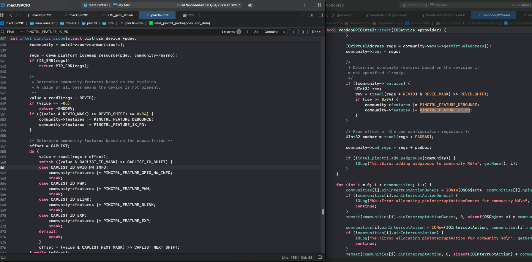

added the linux code for i2c
changed
if (value == ~0u)
            continue;

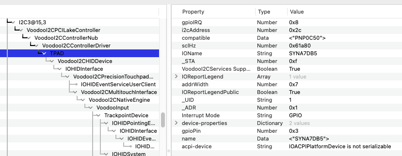

tpad  config settings in dsdt.aml are tricky but there are a few posts online about irq setup and pin configs
Edited by jalavoui

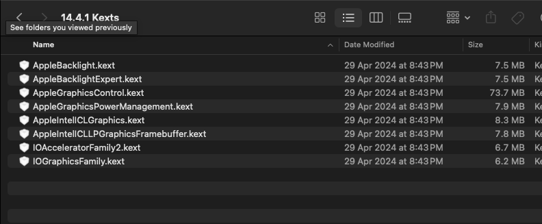

can you get the iclgraph and framebuffer kexts also ?
this pic shows gpio but altough its working im not sure about the errors you get on start()
i just cant get those logs during boot
Yes, the iclgraph and framebuffer kexts are in the mfire link on my most recent post. All files are from 14.4.1
Only the companion bundles are uploaded here, and those were taken not from kernel cache but from the /System/Library/Extensions folder.
I still have not been able to implement GPIO on the TPD0 device for now.

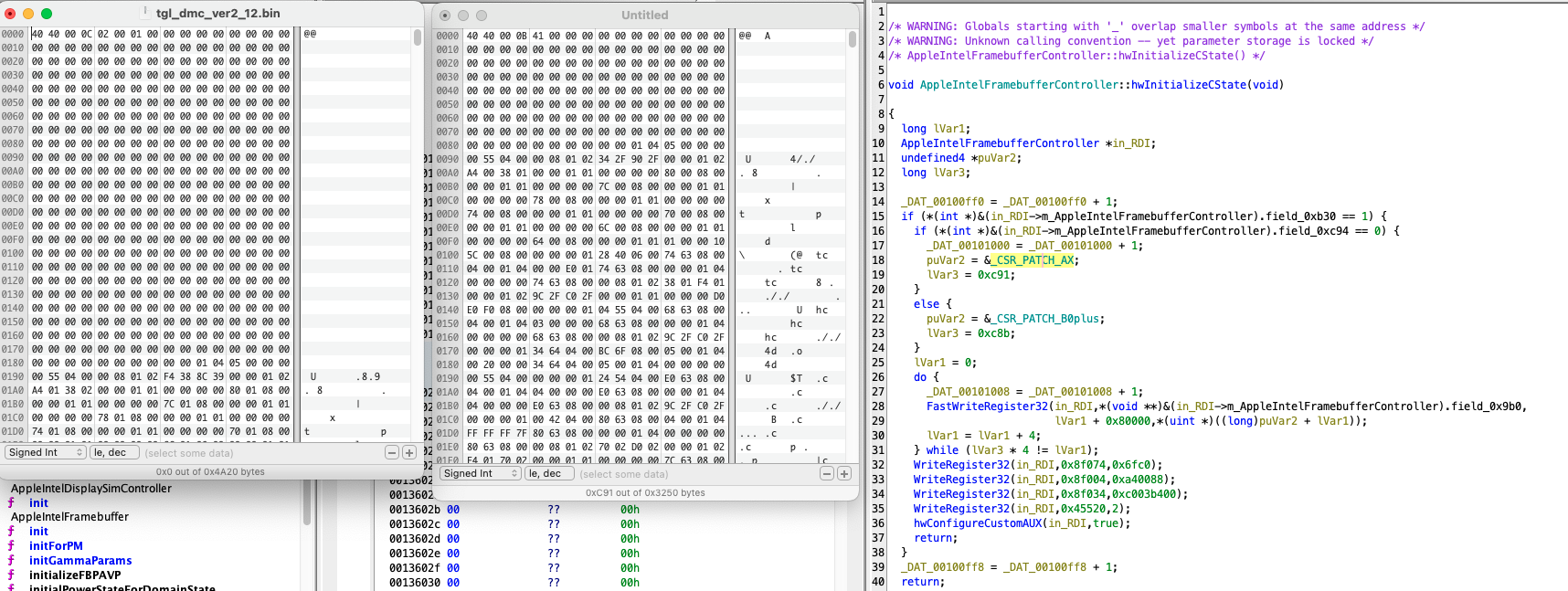

tgl dmc vs csr_patch_ax
var3= 0xc91 maybe array size ?
the linux bin as extra bytes that i remove
got it
0xc91 * 0x4 = 0x3244 bytes
that matches the apple file
modded tgl bin as 0x4a20 bytes so v3= 0x1288
i doubt this will load on sonoma as the patches are all tested on ventura
and for sure they will fail and give kp

I imported the scheduler and TGL DMC-related patches from the most recently uploaded NBlue to WEG and applied them.
And, the part that calls the solveRequest or routeRequest function for getGPUInfo and _CSR_PATCH uses the SYSLOG syntax to output a log to check whether it was applied properly.
// kern_igfx.hpp
const unsigned char tgl_dmc_ver2_12_bin[] = {
const long int tgl_dmc_ver2_12_bin_size = sizeof(tgl_dmc_ver2_12_bin);
	class ForceCompleteModeset: public FramebufferModifer {
	public:
		// MARK: Patch Submodule IMP
		const uint8_t *_CSR_PATCH_B0plus;
		const uint8_t *_CSR_PATCH_AX;
		void init() override;
		void processKernel(KernelPatcher &patcher, DeviceInfo *info) override;
		void processFramebufferKext(KernelPatcher &patcher, size_t index, mach_vm_address_t address, size_t size) override;
	} modForceCompleteModeset;
		KernelPatcher::RouteRequest request("__ZN16IntelAccelerator10getGPUInfoEv", getGPUInfo, ogetGPUInfo);
		if (patcher.routeMultiple(index, &request, 1, address, size))
			SYSLOG("igfx", "[TGL+] getGPUInfo: Functions have been routed successfully.");
		else
			SYSLOG("igfx", "[TGL+] getGPUInfo: Failed to route functions.");
	// TGL_DMC_ver2_12.bin
	static const uint8_t f9[] = {0x83, 0xbf, 0x9c, 0x0c, 0x00, 0x00, 0x00, 0x74, 0x1f, 0x4c, 0x8d, 0x35, 0x7c, 0xab, 0x0e, 0x00, 0x41, 0xbf, 0x8b, 0x0c, 0x00, 0x00};
	static const uint8_t r9[] = {0x83, 0xbf, 0x9c, 0x0c, 0x00, 0x00, 0x00, 0x74, 0x1f, 0x4c, 0x8d, 0x35, 0x7c, 0xab, 0x0e, 0x00, 0x41, 0xbf, 0x88, 0x18, 0x00, 0x00};
	static const uint8_t f9b[] = {0x48, 0xff, 0x05, 0xed, 0x28, 0x0b, 0x00, 0x4c, 0x8d, 0x35, 0x06, 0x79, 0x0e, 0x00, 0x41, 0xbf, 0x91, 0x0c, 0x00, 0x00};
	static const uint8_t r9b[] = {0x48, 0xff, 0x05, 0xed, 0x28, 0x0b, 0x00, 0x4c, 0x8d, 0x35, 0x06, 0x79, 0x0e, 0x00, 0x41, 0xbf, 0x88, 0x12, 0x00, 0x00};
	KernelPatcher::SolveRequest solveRequest = { "_CSR_PATCH_AX", this->_CSR_PATCH_AX };
	KernelPatcher::SolveRequest solveRequest2 = { "_CSR_PATCH_B0plus", this->_CSR_PATCH_B0plus };
	if (patcher.solveMultiple(index, &solveRequest, 1, address, size) && patcher.solveMultiple(index, &solveRequest2, 1, address, size))
		SYSLOG("igfx", "[TGL+] _CSR_PATCH: Functions have been routed successfully.");
	else
		SYSLOG("igfx", "[TGL+] _CSR_PATCH: Failed to route functions.");
	this->_CSR_PATCH_AX = tgl_dmc_ver2_12_bin;
	this->_CSR_PATCH_B0plus = tgl_dmc_ver2_12_bin;

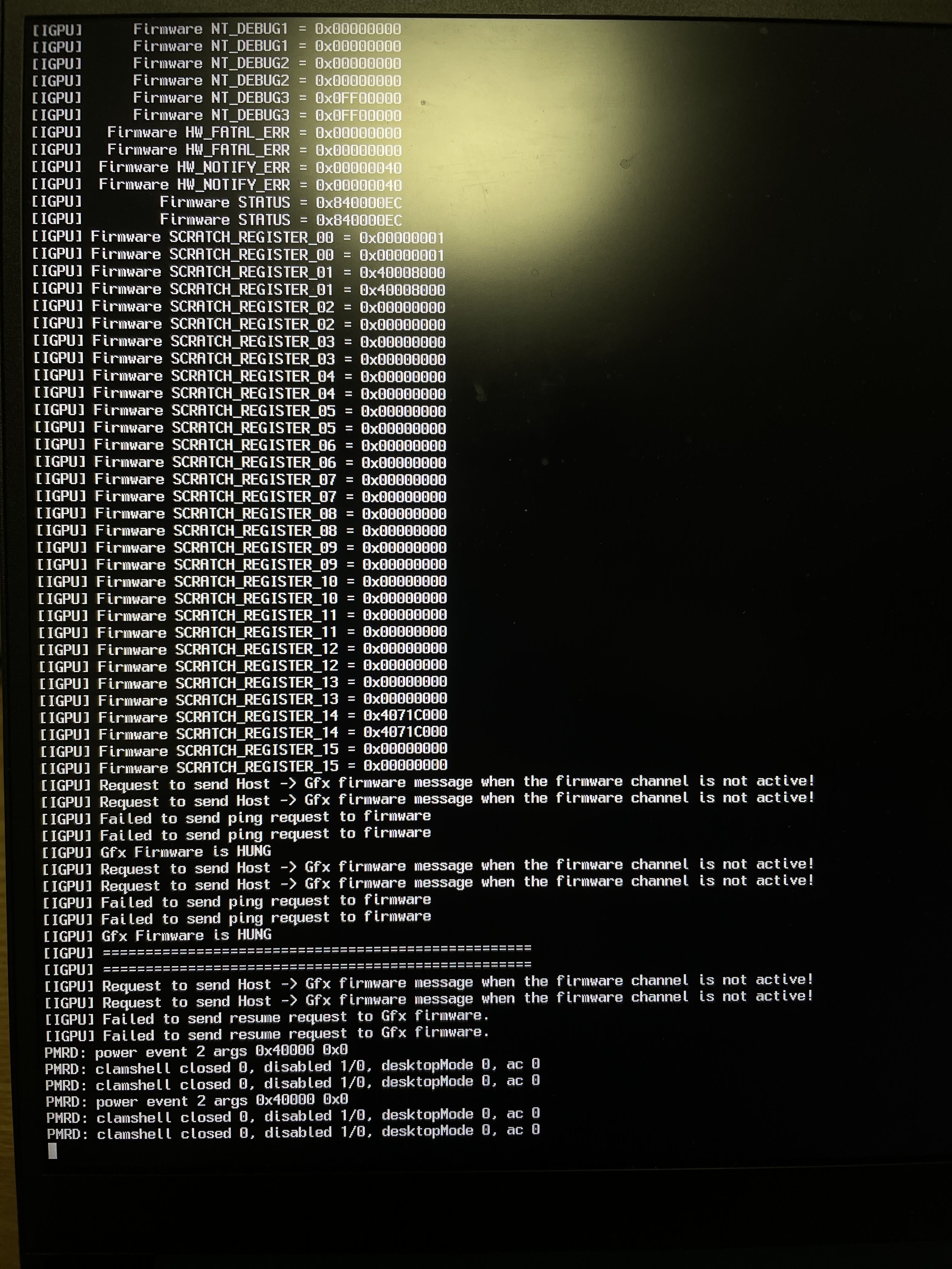

Test 1
- NootedBlue : Disabled
- WhenverGreen : Enabled
- IGPU Device Properties : Injected (Platform ID 0x8A5C0002)
- boot-args : -v keepsyms=1 debug=0x100 -wegdbg
- macOS Version : macOS Ventura 13.6.5 (22G621)
Result : Booting was successful, but graphics acceleration did not work.
And, I confirmed that the log below was output in the Dmesg log.
WhateverGreen      igfx: @ [TGL+] getGPUInfo: Functions have been routed successfully.
WhateverGreen      igfx: @ [TGL+] _CSR_PATCH: Functions have been routed successfully.
Test 2
- boot-args : -v keepsyms=1 debug=0x100 -wegdbg -allow3d igfxfw=2
Result : While trying to accelerate graphics, the log "Gfx Firmware is HUNG" is displayed infinitely.
Can someone please check if I modified WhateverGreen correctly?
WhateverGreen.zip
WhateverGreen-Sources.zip

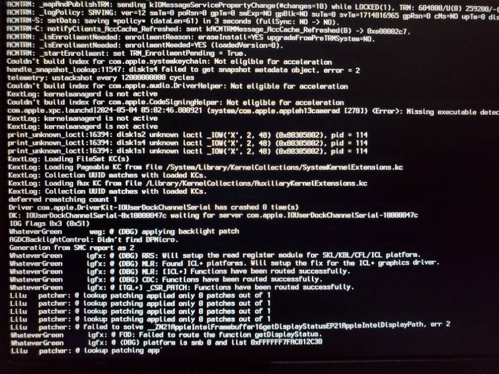

I just tried your modified WhenverGreen without the -allow3d flag and it allows me to boot without the blackscreen issue on 14.4.1, framebuffer is enabled, if using 8a71, you get 2048MB, commands below
-v keepsyms=1 debug=0x100 -wegdbg igfxfw=2
The Blackscreen after Sleep issue is still there, i have my correct efis configs on usb's, so i use the internal ssd efi for testing, it doesnt actually enter sleep
When I use the -allow3d along with the commands above, the screen stops at the below.
WhateverGreen igfx: @ FOD: Failed to route function the function getDisplayStatus
WhateverGreen igfx: @ (DBG) platform is snb 0 and list 0XFFFFFF7FAC812C30
