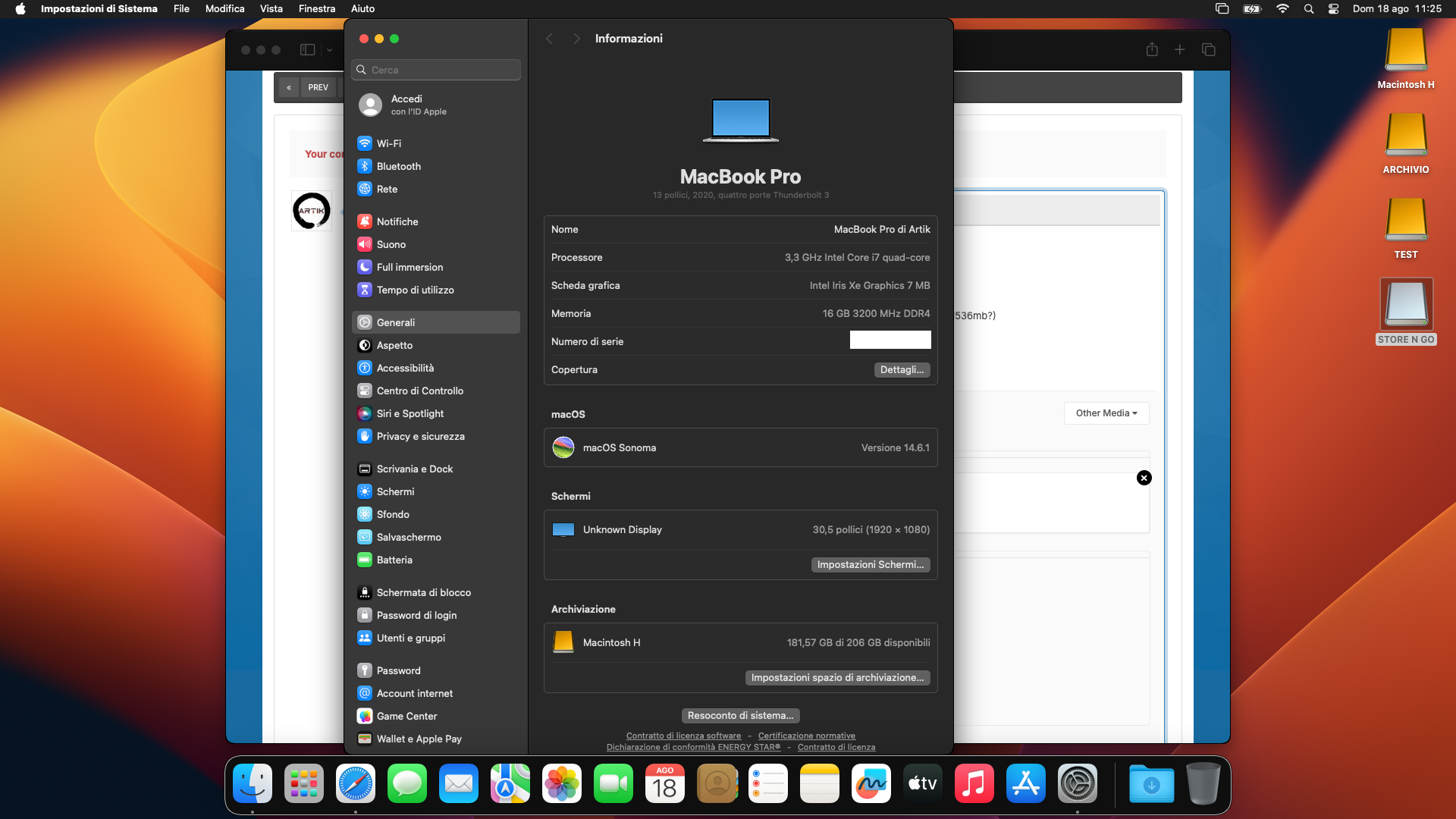

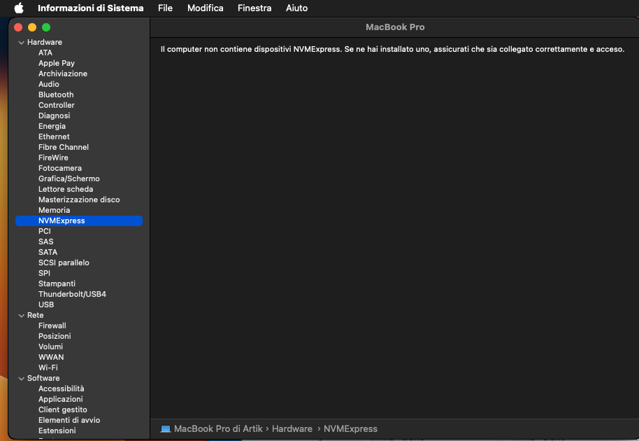

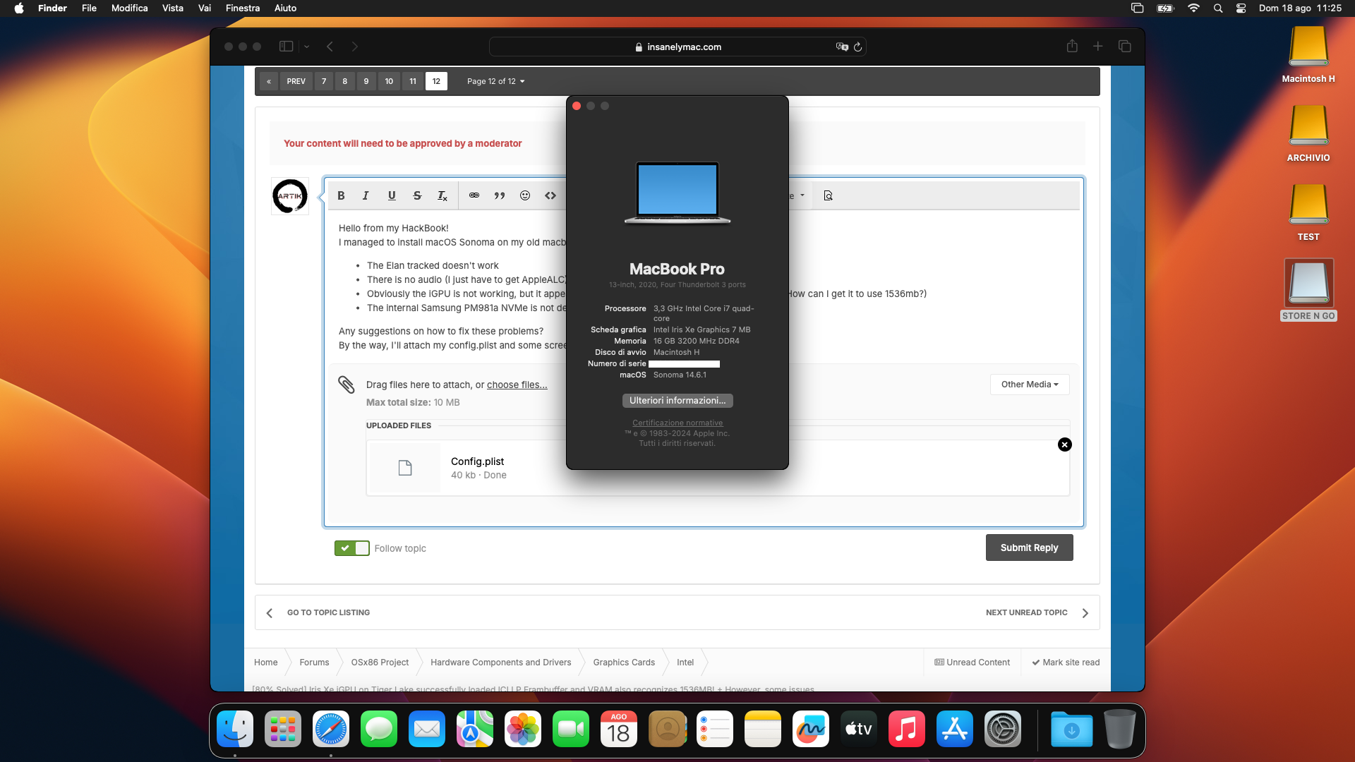

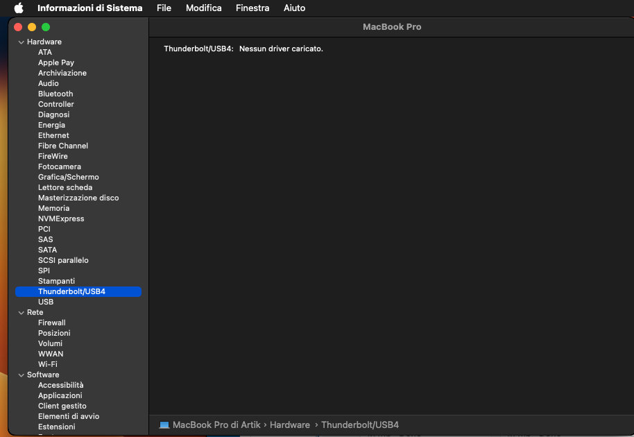

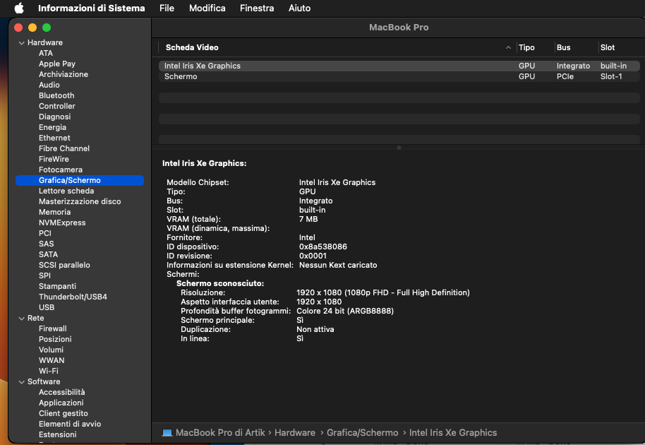

I managed to install macOS Sonoma on my old macbook's NVMe, but there are still some problems:
  • The Elan trackpad doesn't work
  • There is no audio (I just have to get AppleALC) Edit: I can't manage to make it work!
  • Obviously the iGPU is not working, but it appears as an Intel Iris XE Graphics with 7mb of VRAM (How can I get it to use 1536mb?)
  • The internal Samsung PM981a NVMe is not detected (oof)
Any suggestions on how to fix these problems?
By the way, I'll attach my config.plist and some screenshots ;)
Config.plist

9 hours ago, ArtikDiamond said:
Hello from my HackBook!

14 hours ago, benmacfreak said:
im having the same issue except my nvme ssd works both of them, just the other 3 issues i also have.
Is your NVMe a PM981a?
If so, what did you do to make it work? I currently have Windows 11 Pro and EndeavourOS installed, and I'd like to resize the Windows partition to install Sonoma, rather than using an external NVMe disk.
As for the audio, I've tried every possible combination with AppleALC and a DSTD suggested by the Dortania guide (my codec is ALC295). However, I suspected that my NVIDIA GPU, a 3060 laptop, might be causing issues with the audio, as I still haven't been able to get any sound.
Regarding the trackpad, I'm not too concerned since I have a working mouse. Since I'm currently just testing macOS, I'll focus on fixing issues like VRAM and Hardware Acceleration first. In my opinion, trying to resolve minor details like the trackpad before HA is working is probably just a waste of time.

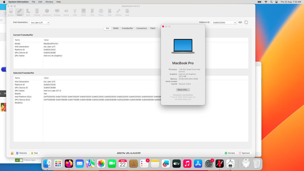

On 5/14/2024 at 6:37 PM, Mastachief said:
Okay here is the result of using the following config using the attached whenvergreen. im using my EDID in the config below, so modify to yours if needs be. its now being listed under index 0 instead of 2 in hackintool. Now it connects to display0 under framebuffer@0. You can also use AAPL,ig-platform-id 00008A52 and device-id 8A530000 as well to achieve the result if you want, you can also see the previous log.
Boot args: -v keepsyms=1 debug=0x100 -wegdbg igfxfw=2 -liludbg
Right now I'm using this, I'll attach my config.plist.
I have the same issue as Benmacfreak: 7mb VRAM
Is there a list of AAPL,ig-platform-id and device-ids to try? Also, would it be ok if I switched to Opencore Release instead of Debug? It takes an absurdly long amount of time to boot...
Config.plist
Edited by ArtikDiamond

I thought you meant the device-id in my config.plist, and reading the thread I just found out that it's not what you meant, but how can I find out which model is my iGPU? And also, which logs should I get (and how)?
Also, what do you mean by etc?

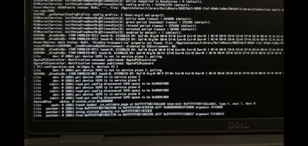

booting gets stuck at;
pci device IGPU is not in service plane 2, polling
pci device IGPU is in service plane 0
read pci config discovered IGPU space to be 0x00001000
NootedBlue nblue: @stolen_size 0xa000000
OpenCore Debug result
opencore-2024-08-21-150128.txt

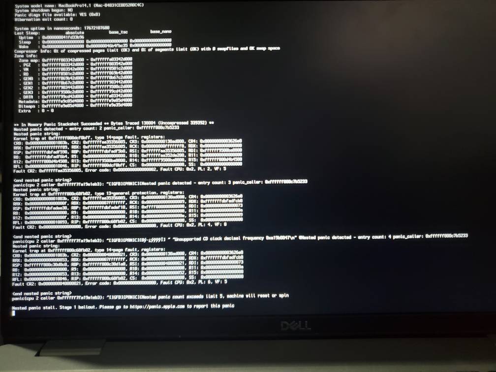

my laptop has a 9a68 i checked in lspci on ubuntu and device manager on windows and i used nblue and whatevergreen fork with many device properties idk how to make it work tbh.
doing a fresh nblue version with less PANIC_COND macros (i think this is Mastachief crash error - a lilu patch error)
disable if using mac os installer then reenable.
get lilu.kext from github or from previous post. old versions wont work
Edited by jalavoui

I updated my EFI using parts of Mastachief's latest EFI, and both the gpu name and the VRAM are now recognised. Also, before updating my EFI, I couldn't get my internal display to be recognised in Hackintool. Now it works, but there are still some minor problems (Trackpad/Audio and Bluetooth with BlueToolFixup)
Here's the config if you want to take a look and see if you can solve the problems :)

When testing nblue on Ventura 13.6.9 using macbookpro14,1
"[IGFB][PANIC][......] " "Unsupported CD clock decimal frequency 0x19b8847\n"
I already set my cd clock frequency using ru.efi to 652.8 MHz.
I'm booting from the internal efi using nblue, with the working whatevergreen on the usb.
Edited by Mastachief
Thank you, it works when booting from the internal EFI now.
