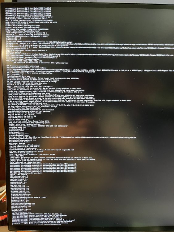

I am trying to install macOS Ventura 13.6.1 on a HP 800 G6 Mini PC. The hardware setup is as below:
CPU: i5-10600
iGPU: UHD 630
RAM: Crucial 32GB DDR4-3200MHz *1
Motherboard: HP EliteDesk 800 G6 Mini PC
SSD: SN850X *1
Wifi/Bluetooth: None
Ethernet: Realtek RTL8125B
OpenCore: OC 0.9.6
macOS: Ventura 13.6.1
Config.plist: config.plist
EFI layout:
I was stuck at the installation message "SMCSuperIO    ssio: @ failed to detect supported SuperIO chip". Also, "AppleNVMe Assert failed: ( 0 != data )" showed up earlier. A log screenshot is posted as below.
I did some research, and I thought this was caused by mismatched SSDTs. So, I tried to create the custom SSDTs by using SSDTTime. Unfortunately, same errors popped up again.
Appreciate any help.

6 hours ago, Slice said:
It looks like you have no supported graphics.
I do not have a dGPU installed, but I think the iGPU is fine.
