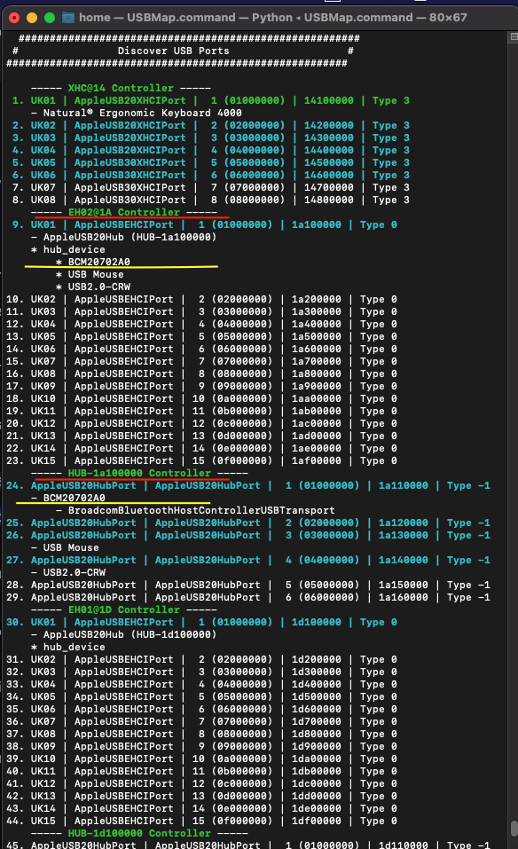

I'm using OpenCore 0.9.4 bootloader with BigSur.

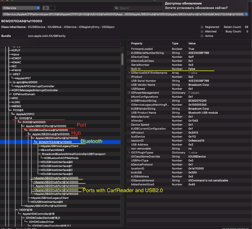

I'm trying to register an internal port for Bluetooth, which hangs on USB 2.0.

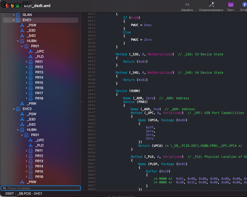

The difficulty is that the hub comes first, then the controller, then the hub again and it has six USB 2.0 ports (with Bluetooth, a Cardreader, and two regular USB outputs).
The settings are applied to the controller on the first hub, and the child ones are ignored.
As a result, sleep does not work (initiative awakening).
I found a similar problem on the forum, but without a solution.
What can you try to do?
USBMap.kext.zip DSDT.aml.zip
