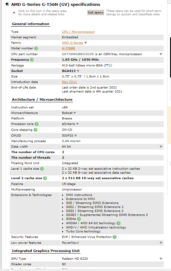

I have a computer that has an AMD G-T56N CPU. I want to install Catalina inside VirtualBox. What am I going to need?
Since your CPU does not support the SSE4.1 instruction set, you can only install up to El Capitan. Your intention to install Catalina on your PC is absolutely unrealistic

Then what are the threads I'm seeing about XNU patches and MouSSE?
Also, this would be a virtual machine, not bare metal.

Currently, there is no way to emulate the missing SSE4.1 instruction set. Give up hope, as we had to bury that hope many years ago.
