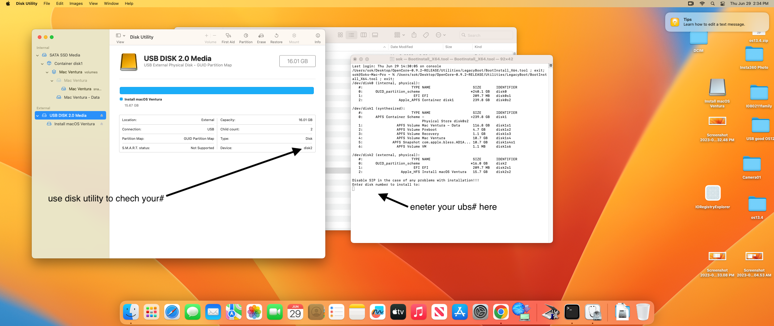

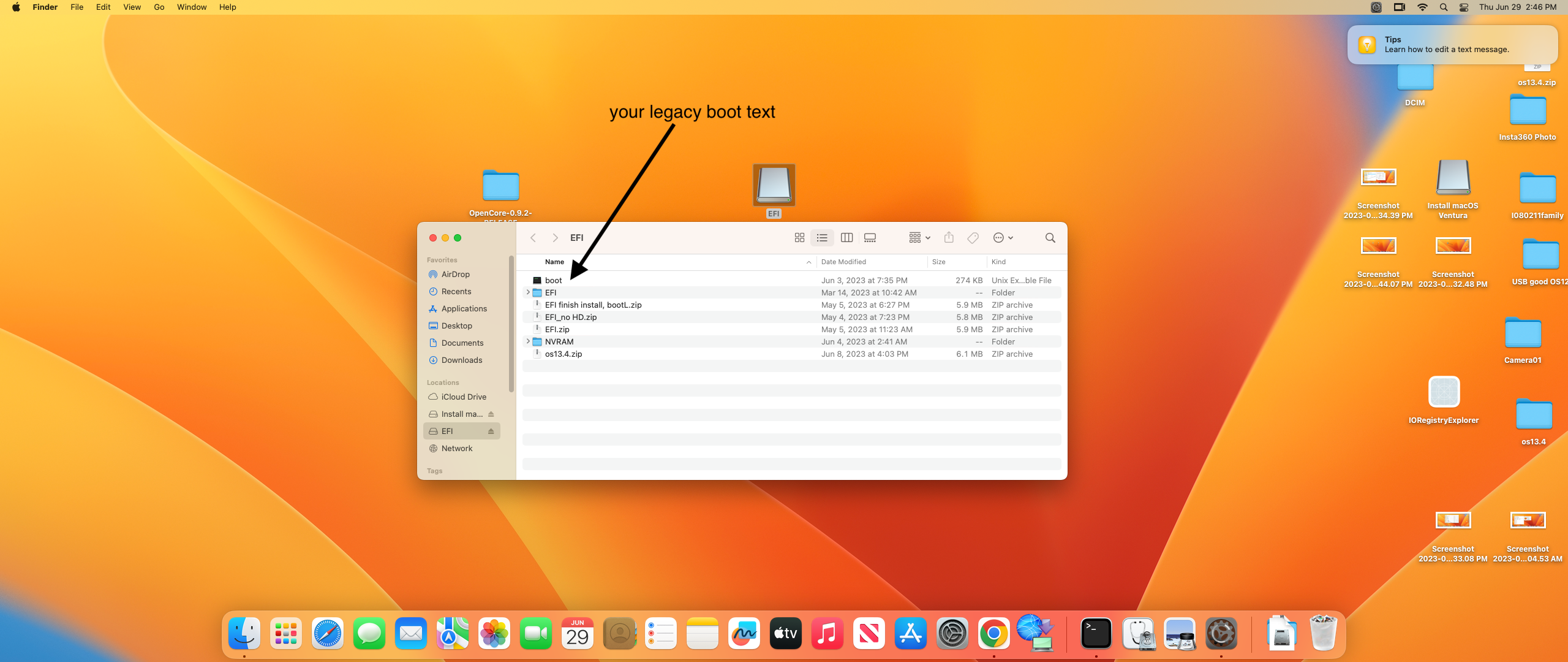

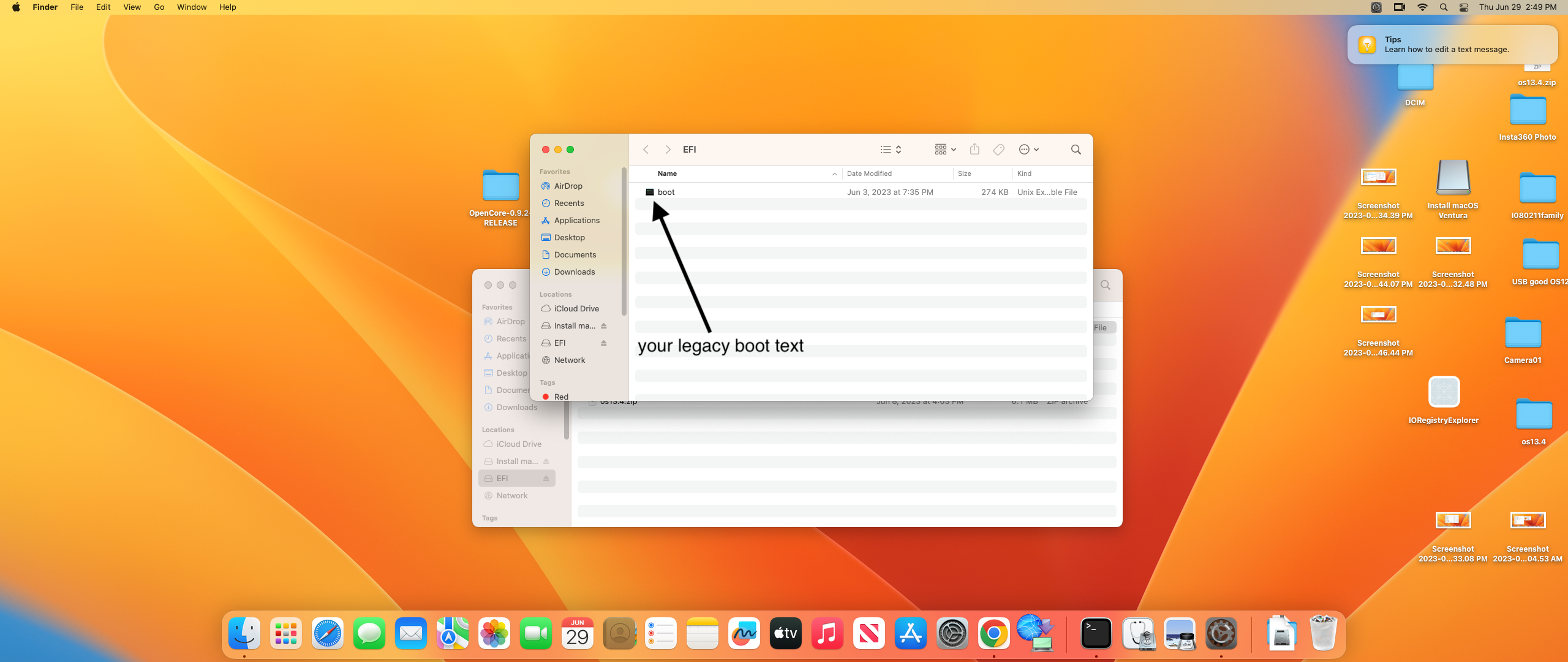

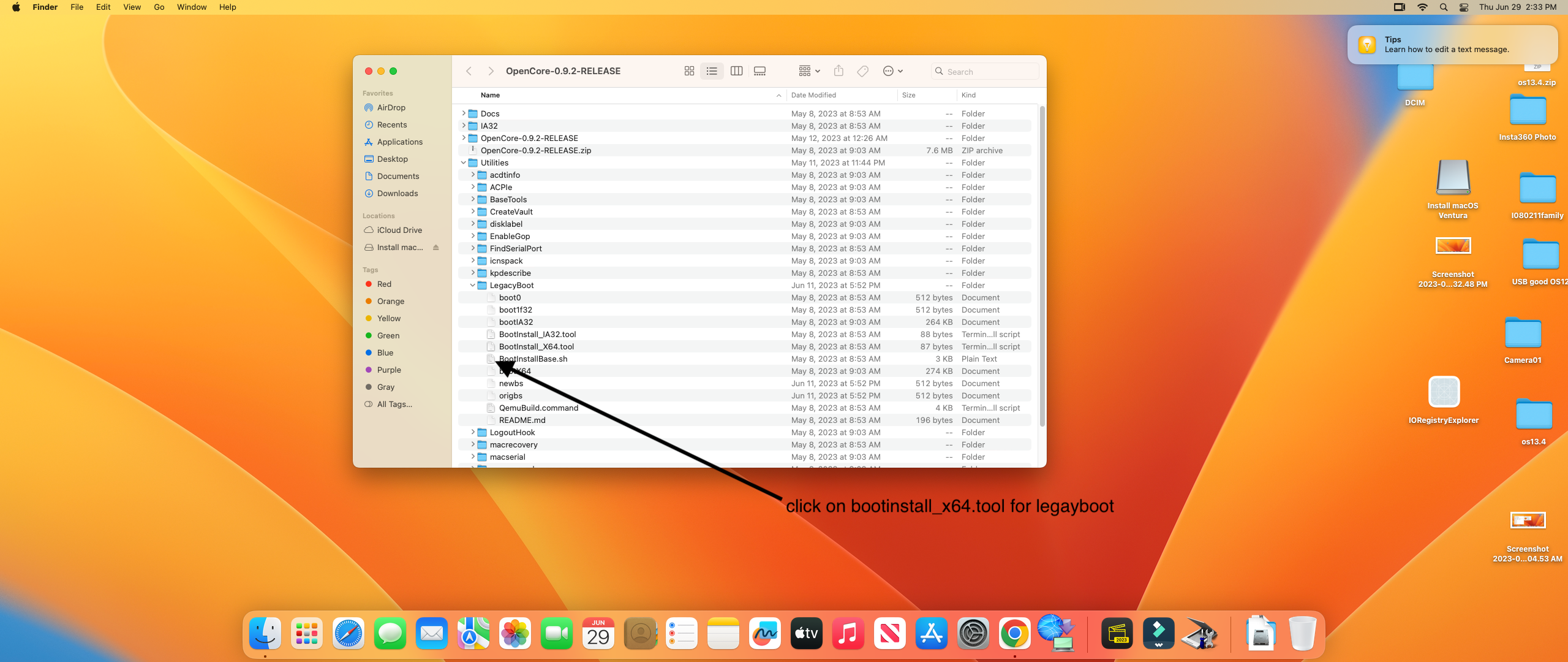

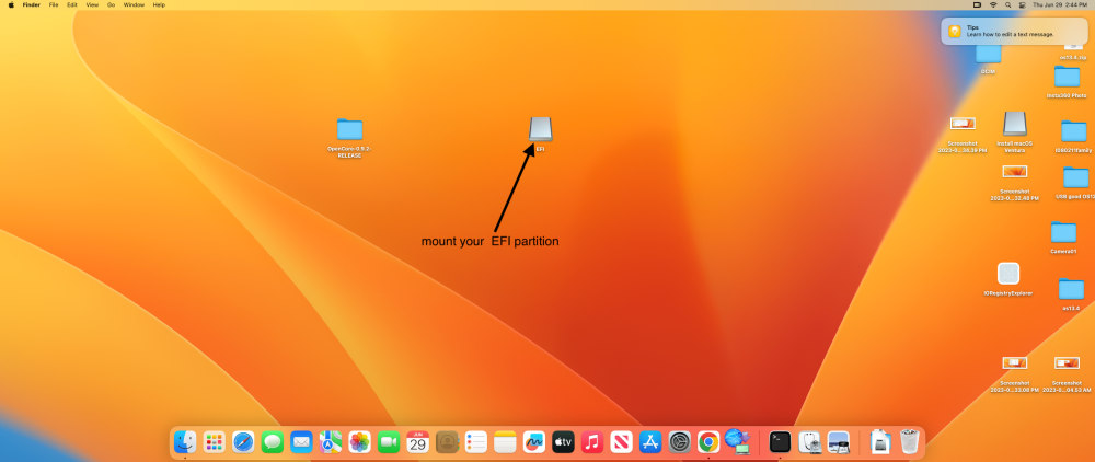

sok5 Posted June 29, 2023 Share Posted June 29, 2023 (edited) How to make your USB legacyBootable 1.use OpenCore 0.9 Utilities ==>LegacyBoot =>BootInstall_X64 =>open with terminal 2.use apple Disk Utilities to check your UBS# 3.enter your USB # in terminal, when it finish 4. mount your EFI partition, you should see Boot, if it does not saw repeat #1 5. move your EFI folder into EFI partition. I have better luck with Ventura then Monterey Os. Hope this help Edited July 1, 2023 by sok5 Quote Link to comment https://www.insanelymac.com/forum/topic/357055-hp-z800-open-core-install-i-cant-get-the-open-core-usb-to-boot-even-though-it-shows-in-bios-please-can-anyone-help-me/#findComment-2807510 Share on other sites More sharing options...
