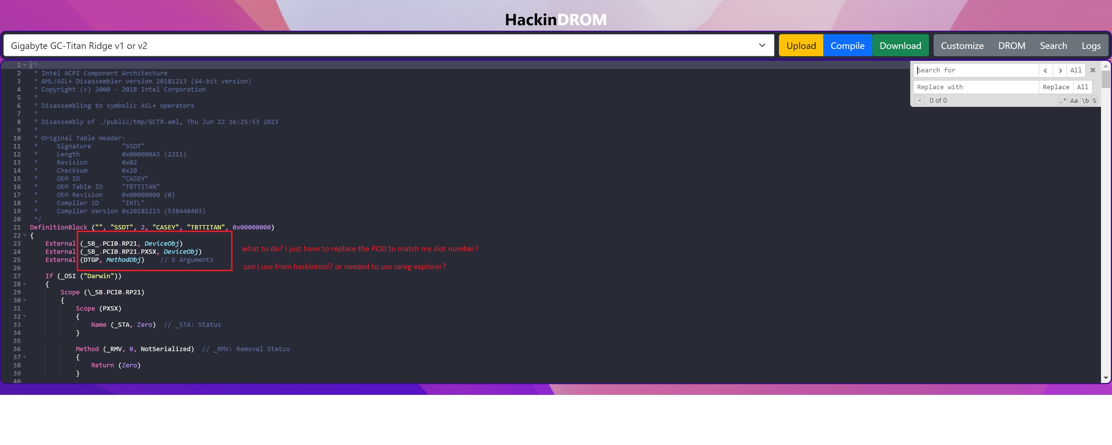

hotbullet Posted June 22, 2023 Share Posted June 22, 2023 Dear gurus, and friends. could you please help me to understand the value and what and where needs to be replaced. at the moment i have flashed card aic gigabyte titan v2. my hackintosh could see the thunderbolt in systemreport. however i have connected thunderbolt dock and tb ssd.the device never showed up. i could boot with the ssd that is conncted to the port(this boot drive is usb 10.) the thunderbolt disk i connected via usb 4 enclosure. it would mount after boot but as usb drive. the test speed just 1000MB. i have attached the ioreg file and my screenshots of doubt. how can i replace value from hackindrom ssdt to match my system? can i use hackintool pcie menu where there is ioregname and pcie path instead of values from ioreg? i have tried researching on youtube i could not find any video or similar topics in English. thank you. proart.zip Link to comment https://www.insanelymac.com/forum/topic/357026-thunderbolt-flashed-card-and-ssdt/ Share on other sites More sharing options...

hotbullet Posted June 26, 2023 Author Share Posted June 26, 2023 On 6/23/2023 at 12:50 PM, Baio77 said: TB3 is connected to Peg2 hi thanks for replay in this case. if this case if the original before modifying is ---------------------------------------------------------------------------------------------- DefinitionBlock ("", "SSDT", 2, "CASEY", "TBTTITAN", 0x00000000) { External (_SB_.PCI0.RP21, DeviceObj) External (_SB_.PCI0.RP21.PXSX, DeviceObj) External (DTGP, MethodObj) // 5 Arguments ----------------------------------------------------------------------------------------------- i will have to replace External (_SB_.PCI0.RP21, DeviceObj) =====> to ??? how do i put peg2 in ssdt? where thanks. Link to comment https://www.insanelymac.com/forum/topic/357026-thunderbolt-flashed-card-and-ssdt/#findComment-2807252 Share on other sites More sharing options...

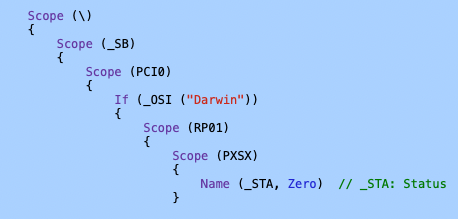

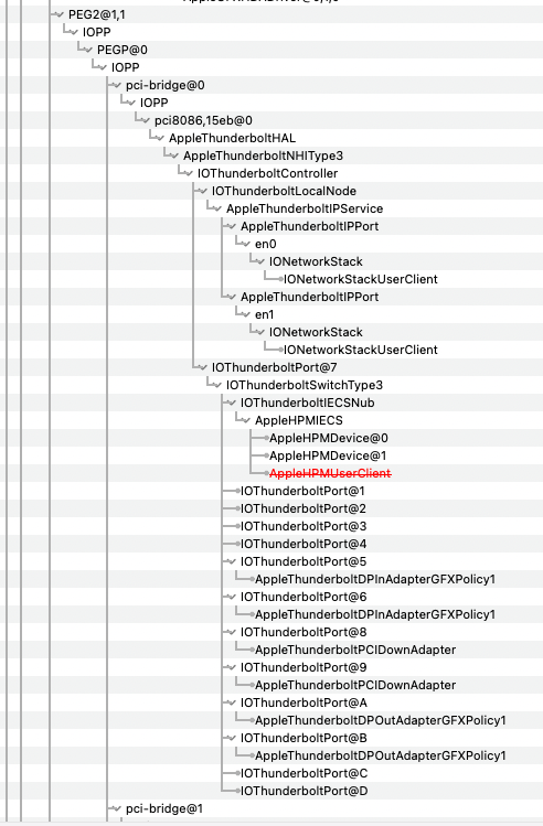

Baio77 Posted June 26, 2023 Share Posted June 26, 2023 (edited) External (_SB_.PCI0.PEG2, DeviceObj) and External (_SB_.PCI0.PEG2.PEGP, DeviceObj) . In theory you need to disable the native device and then use SSDT Hack well configured, I need SSDT-TB3 + DSDT origin to be able to set everything correctly. PXSX is disabling the native device. SSDT-TB3-HackinDROM.aml Test this SSDT , post ioreg Edited June 26, 2023 by Baio77 Link to comment https://www.insanelymac.com/forum/topic/357026-thunderbolt-flashed-card-and-ssdt/#findComment-2807306 Share on other sites More sharing options...
hotbullet Posted July 5, 2023 Author Share Posted July 5, 2023 On 6/27/2023 at 1:47 AM, Baio77 said: External (_SB_.PCI0.PEG2, DeviceObj) and External (_SB_.PCI0.PEG2.PEGP, DeviceObj) . In theory you need to disable the native device and then use SSDT Hack well configured, I need SSDT-TB3 + DSDT origin to be able to set everything correctly. PXSX is disabling the native device. SSDT-TB3-HackinDROM.aml 2.04 kB · 5 downloads Test this SSDT , post ioreg thanks workes perfect. what is the difference between pxsx and pegp? how do i know when to use what Link to comment https://www.insanelymac.com/forum/topic/357026-thunderbolt-flashed-card-and-ssdt/#findComment-2807723 Share on other sites More sharing options...
Baio77 Posted July 6, 2023 Share Posted July 6, 2023 After reading Ioreg it is easy to intercept the device name to rename or patch. Link to comment https://www.insanelymac.com/forum/topic/357026-thunderbolt-flashed-card-and-ssdt/#findComment-2807820 Share on other sites More sharing options...
