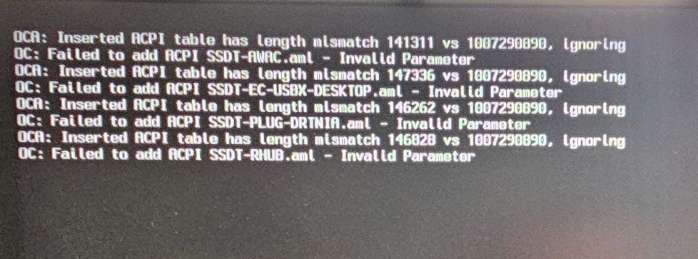

zeos_ar Posted June 16, 2023 Share Posted June 16, 2023 (edited) Hi I also got some ACPI error before the menu to select install, adding it for context but it goes through it. Setup: Mother: gigabyte z490-UD Micro: i7 10700 Video : RX 6900 XT Edited June 16, 2023 by fantomas It is so hard to say Hello ? Quote Link to comment https://www.insanelymac.com/forum/topic/356981-help-stucked-at-smcsuperio-ssio-detected-device-ite-it8688e/ Share on other sites More sharing options...

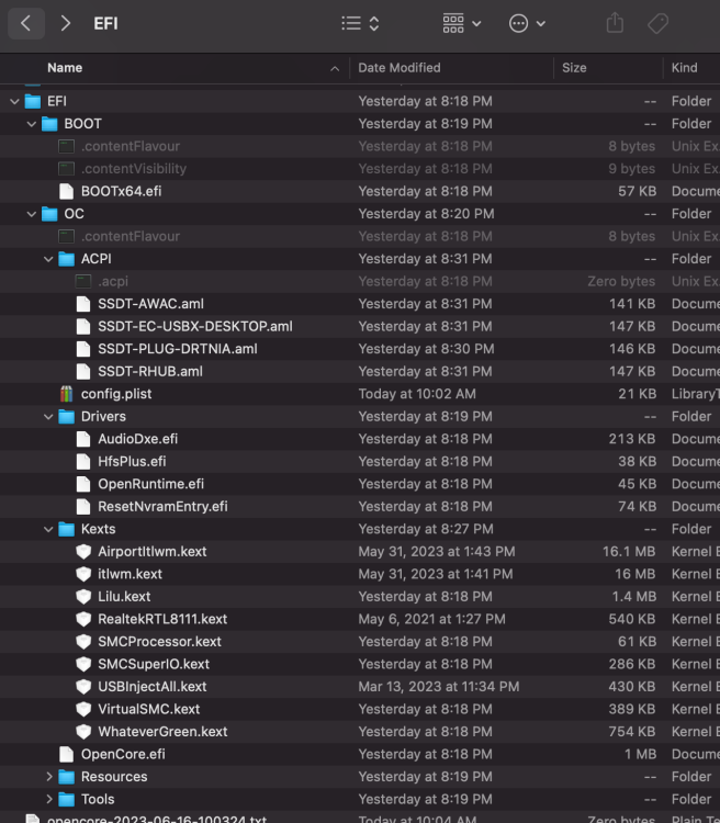

cankiulascmnfye Posted June 16, 2023 Share Posted June 16, 2023 (edited) @zeos_ar Uhm, 140+ kilobytes for ACPI tables like these is waaaaaaay too much. AWAC is about 70… bytes… delete them get fresh ones from opencore install package Edited June 16, 2023 by cankiulascmnfye Quote Link to comment https://www.insanelymac.com/forum/topic/356981-help-stucked-at-smcsuperio-ssio-detected-device-ite-it8688e/#findComment-2806625 Share on other sites More sharing options...
zeos_ar Posted June 16, 2023 Author Share Posted June 16, 2023 2 hours ago, cankiulascmnfye said: @zeos_ar Uhm, 140+ kilobytes for ACPI tables like these is waaaaaaay too much. AWAC is about 70… bytes… delete them get fresh ones from opencore install package Downloaded https://github.com/dortania/Getting-Started-With-ACPI/blob/master/extra-files/compiled/SSDT-AWAC.aml and its 146kb 2 hours ago, Cyberdevs said: Is CFGLock disabled in BIOS? have you set the BIOS properly? Yup, the only option that I couldn't find on my bios is Vd-x Quote Link to comment https://www.insanelymac.com/forum/topic/356981-help-stucked-at-smcsuperio-ssio-detected-device-ite-it8688e/#findComment-2806627 Share on other sites More sharing options...
zeos_ar Posted June 17, 2023 Author Share Posted June 17, 2023 @cankiulascmnfye I anyway downloaded it again and actually I got progress, BUT now I get this: 79:586 00:126 AAPL: #[EB.LD.OFS|OPEN!] Err(0xE) <"usr\\standalone\\OS.dmg.root_hash"> 79:630 00:043 AAPL: #[EB.RH.LRH|P!] Err(0xE) <- EB.LD.LF 79:766 00:135 AAPL: #[EB.BST.FBS|!] Err(0xE) <- EB.RH.LRH 79:809 00:043 OCSMC: SmcReadValue Key 4D535463 Size 1 79:938 00:129 OCSMC: SmcReadValue Key 4D534163 Size 2 79:981 00:043 AAPL: #[EB.B.WFDW|!WF] Err(0xE) 0 80:115 00:133 AAPL: #[EB|LOG:DT] 2023-06-16T19:56:42 80:159 00:043 AAPL: #[EB|LOG:EXITBS:START] 2023-06-16T19:56:42 Quote Link to comment https://www.insanelymac.com/forum/topic/356981-help-stucked-at-smcsuperio-ssio-detected-device-ite-it8688e/#findComment-2806630 Share on other sites More sharing options...
cankiulascmnfye Posted June 17, 2023 Share Posted June 17, 2023 Please uee the ACPI files that come with the OpenCorePKG! Located under Docs/AcpiSamples! The AWAC SSDT is 70 bytes in size, not 146 kb. Whatever your system does when downloadung these files, it's wrong. Next: - Create an OC Snapshot of your config using ProperTree - Check your config for errors online: https://sanitychecker.ocutils.me/ - Try again - If the issue does not diappear, refer to the Troubleshooting guide: https://dortania.github.io/OpenCore-Install-Guide/troubleshooting/extended/kernel-issues.html#stuck-on-eb-log-exitbs-start Quote Link to comment https://www.insanelymac.com/forum/topic/356981-help-stucked-at-smcsuperio-ssio-detected-device-ite-it8688e/#findComment-2806638 Share on other sites More sharing options...
