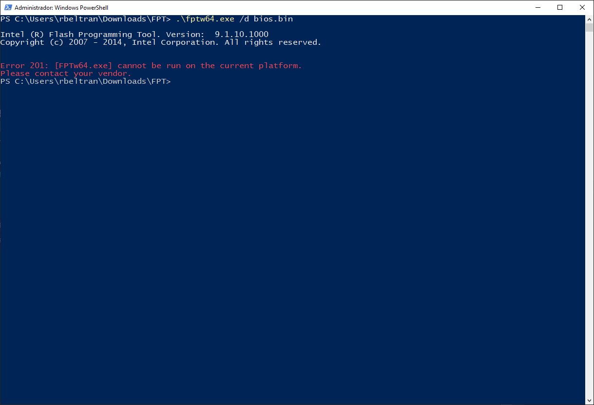

anerik70 Posted April 18, 2023 Share Posted April 18, 2023 Let`s start: Download file attached. Extract. Open cmd as admin. cd to the folder FPT_X79_DOS Do a bios backup with this Command: fptw64 -d backup.bin. Report here the process with image captures and the file backup.bin FPT_X79_DOS.zip Quote Link to comment https://www.insanelymac.com/forum/topic/356076-ventura-1321-installed-and-booting-without-turbo-boost-xeon-e5-2690v2-chinese-x79/page/2/#findComment-2803810 Share on other sites More sharing options...

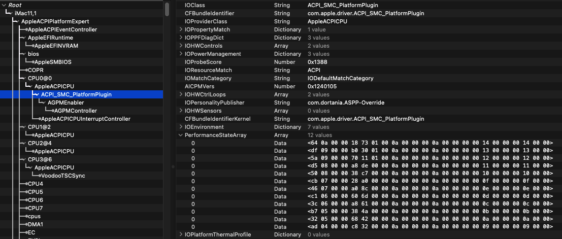

aben Posted April 21, 2023 Share Posted April 21, 2023 (edited) @rbeltran Hi - you can actually opt to skip unlocking MSR 0xE2 register the hard way (which involves BIOS payload extraction, then find and modify MSR/CFG variable via shell command, eg. GRUB). As detailed above, part of your issue is that recent OpenCore's release binaries has a kernel/OS check which blocks legacy-power-management kexts (AICPUPM) from being patched for the locked MSR 0xE2 bypass in Ventura (quirk: AppleCpuPmCfgLock), which is why you're having trouble getting your Ivy-Bridge CPU to run in non-XCPM mode in Ventura. Assuming that your machine is currently running Ventura with OpenCore, I've attached below recompiled OpenCore binaries (with check removed), and legacy-power-management kexts, which you can use to successfully force non-XCPM power-management mode for your Ivy-Bridge CPU in Ventura. Before you proceed, remember to create backups of your current EFI config targeted for Ventura, then follow the steps below: Copy/replace OpenCore.efi, OpenRuntime.efi and BOOTx64.efi binaries (from EFI.zip attached below to your EFI) Add legacy-power-management kexts: AppleIntelCPUPowerManagement.kext + AppleIntelCPUPowerManagementClient.kext (also included in same EFI.zip below) to Kexts folder; also remember to include them to your kexts list in config.plist (under Kernel->Add) Once booted, you can confirm if the patch was successful by checking your CPU objects in ioreg; they should attach to ACPI_SMC_PlatformPlugin. Test and post your results. Good luck! N.B: Next OpenCore release 0.9.2 will be shipping with the above detailed kernel-check redacted, so legacy kexts AICPUPM can be conveniently injected/loaded successfully in macOS 13 for machines with locked MSR/CFG. EFI.zip Edited April 21, 2023 by aben Upload files 2 1 Quote Link to comment https://www.insanelymac.com/forum/topic/356076-ventura-1321-installed-and-booting-without-turbo-boost-xeon-e5-2690v2-chinese-x79/page/2/#findComment-2803908 Share on other sites More sharing options...

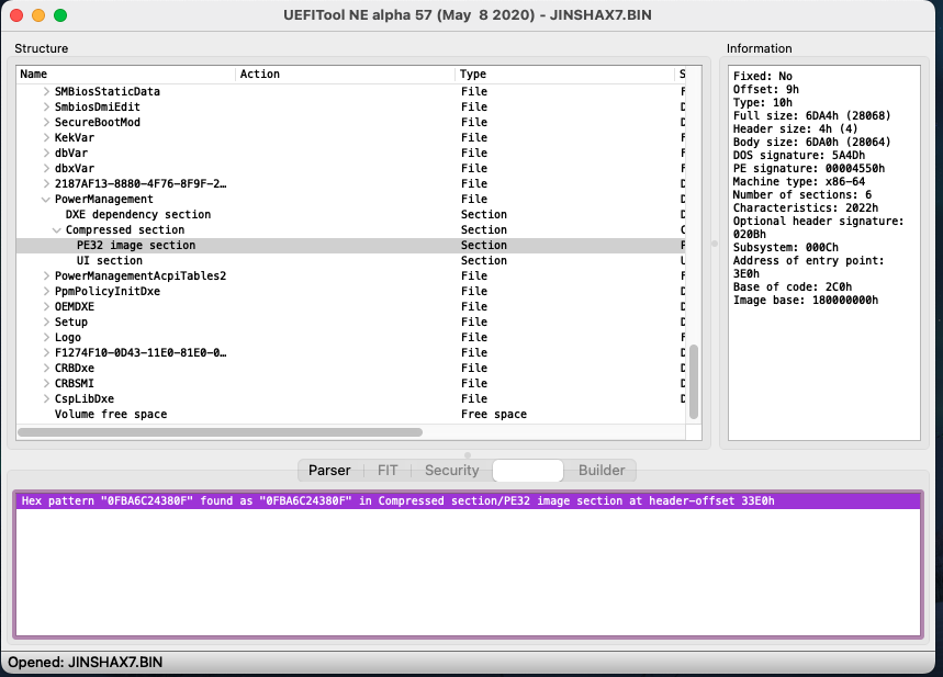

anerik70 Posted April 25, 2023 Share Posted April 25, 2023 (edited) 1 hour ago, rbeltran said: Ok @anerik70, i already made this with AFUDOS instead of FPT and with this guide, but there's no "CFG Lock" on my bios. By the way i have attached my bios dump. I hope there's another way to patch my bios to unlock CFG. JINSHAX7.BIN 4.5 MB · 0 downloads I need you do the process with FPT to get the entire bios (about 8mb). La mía tampoco tiene CFG Lock pero el valor está allí. Edited April 25, 2023 by anerik70 Quote Link to comment https://www.insanelymac.com/forum/topic/356076-ventura-1321-installed-and-booting-without-turbo-boost-xeon-e5-2690v2-chinese-x79/page/2/#findComment-2803986 Share on other sites More sharing options...
rbeltran Posted April 25, 2023 Author Share Posted April 25, 2023 4 hours ago, anerik70 said: I need you do the process with FPT to get the entire bios (about 8mb). La mía tampoco tiene CFG Lock pero el valor está allí. FPT gives me this "error 201", i tried from windows 10 CMD, Powershell, and with a flash drive with DOS, FreeDOS, all of them with the same error. It seems that my motherboard works only with AFUDOS. I'm using this method FPT from windows 10. (En los comentarios del link indica que, si no sirve FPT, lo más probable es que solo funcione con AFUDOS) Quote Link to comment https://www.insanelymac.com/forum/topic/356076-ventura-1321-installed-and-booting-without-turbo-boost-xeon-e5-2690v2-chinese-x79/page/2/#findComment-2803990 Share on other sites More sharing options...
anerik70 Posted April 25, 2023 Share Posted April 25, 2023 (edited) 8 hours ago, rbeltran said: FPT gives me this "error 201", i tried from windows 10 CMD, Powershell, and with a flash drive with DOS, FreeDOS, all of them with the same error. It seems that my motherboard works only with AFUDOS. I'm using this method FPT from windows 10. (En los comentarios del link indica que, si no sirve FPT, lo más probable es que solo funcione con AFUDOS) If you are on 32bit use fpt -d backup.bin Edited April 25, 2023 by anerik70 Quote Link to comment https://www.insanelymac.com/forum/topic/356076-ventura-1321-installed-and-booting-without-turbo-boost-xeon-e5-2690v2-chinese-x79/page/2/#findComment-2804005 Share on other sites More sharing options...
rbeltran Posted April 25, 2023 Author Share Posted April 25, 2023 9 hours ago, anerik70 said: If you are on 32bit use fpt -d backup.bin It's Windows10 64bit, nevertheless, i've tryed with FPT 32bit, 64bit, DOS and EFI version, and all of them give me the same error. On 4/21/2023 at 7:25 AM, aben said: @rbeltran Hi - you can actually opt to skip unlocking MSR 0xE2 register the hard way (which involves BIOS payload extraction, then find and modify MSR/CFG variable via shell command, eg. GRUB). As detailed above, part of your issue is that recent OpenCore's release binaries has a kernel/OS check which blocks legacy-power-management kexts (AICPUPM) from being patched for the locked MSR 0xE2 bypass in Ventura (quirk: AppleCpuPmCfgLock), which is why you're having trouble getting your Ivy-Bridge CPU to run in non-XCPM mode in Ventura. Assuming that your machine is currently running Ventura with OpenCore, I've attached below recompiled OpenCore binaries (with check removed), and legacy-power-management kexts, which you can use to successfully force non-XCPM power-management mode for your Ivy-Bridge CPU in Ventura. Before you proceed, remember to create backups of your current EFI config targeted for Ventura, then follow the steps below: Copy/replace OpenCore.efi, OpenRuntime.efi and BOOTx64.efi binaries (from EFI.zip attached below to your EFI) Add legacy-power-management kexts: AppleIntelCPUPowerManagement.kext + AppleIntelCPUPowerManagementClient.kext (also included in same EFI.zip below) to Kexts folder; also remember to include them to your kexts list in config.plist (under Kernel->Add) Once booted, you can confirm if the patch was successful by checking your CPU objects in ioreg; they should attach to ACPI_SMC_PlatformPlugin. Test and post your results. Good luck! N.B: Next OpenCore release 0.9.2 will be shipping with the above detailed kernel-check redacted, so legacy kexts AICPUPM can be conveniently injected/loaded successfully in macOS 13 for machines with locked MSR/CFG. EFI.zip 456.47 kB · 3 downloads Hi @aben i'm installing Ventura again to test with your files, thanks by the way. Quote Link to comment https://www.insanelymac.com/forum/topic/356076-ventura-1321-installed-and-booting-without-turbo-boost-xeon-e5-2690v2-chinese-x79/page/2/#findComment-2804028 Share on other sites More sharing options...

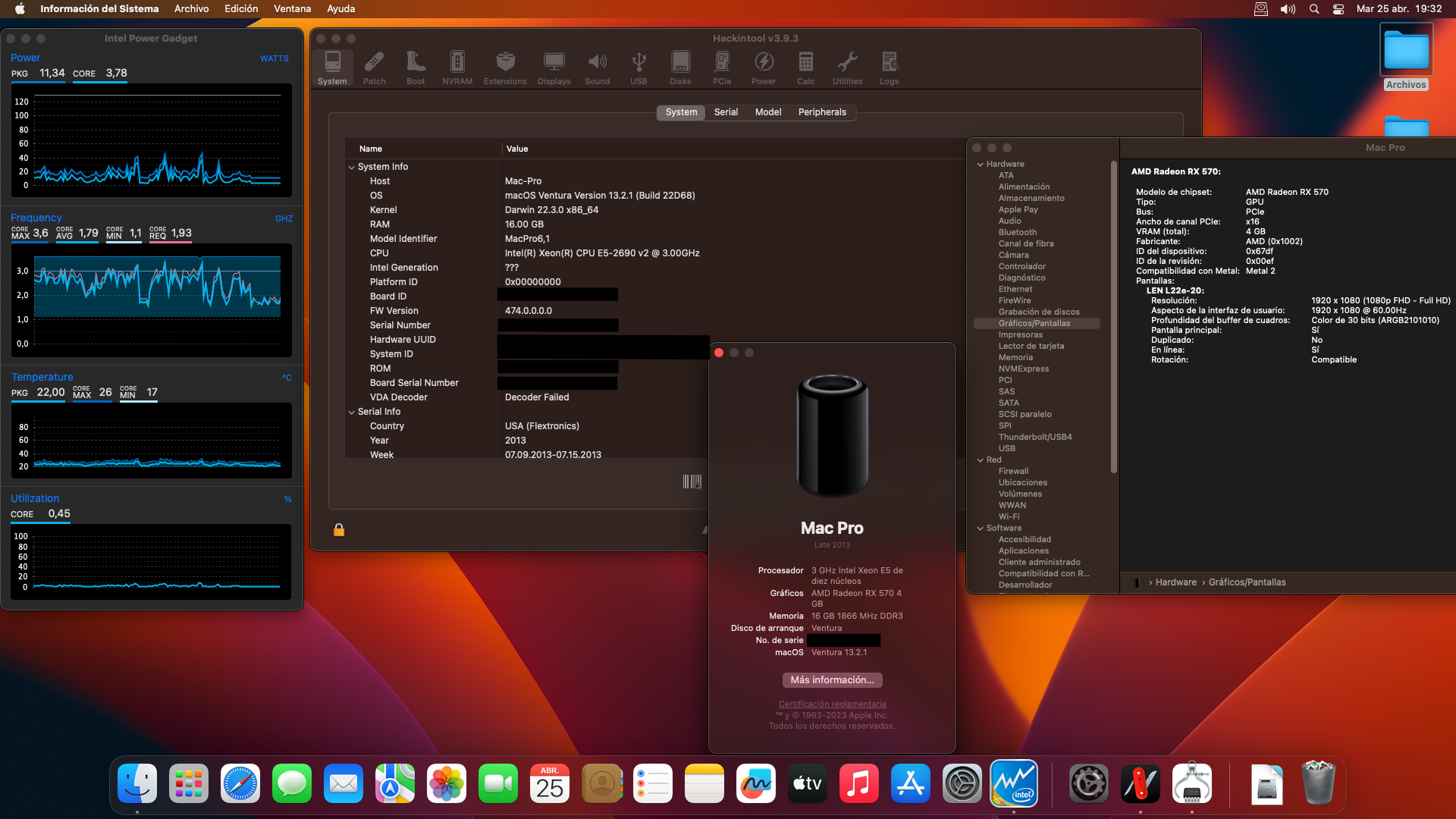

rbeltran Posted April 26, 2023 Author Share Posted April 26, 2023 4 hours ago, rbeltran said: It's Windows10 64bit, nevertheless, i've tryed with FPT 32bit, 64bit, DOS and EFI version, and all of them give me the same error. Hi @aben i'm installing Ventura again to test with your files, thanks by the way. @aben turbo boost it's now working normal with the files you gave to me, thank you very much for your help. 2 Quote Link to comment https://www.insanelymac.com/forum/topic/356076-ventura-1321-installed-and-booting-without-turbo-boost-xeon-e5-2690v2-chinese-x79/page/2/#findComment-2804033 Share on other sites More sharing options...
aben Posted April 26, 2023 Share Posted April 26, 2023 @rbeltran You’re welcome! Glad to see it worked out Quote Link to comment https://www.insanelymac.com/forum/topic/356076-ventura-1321-installed-and-booting-without-turbo-boost-xeon-e5-2690v2-chinese-x79/page/2/#findComment-2804034 Share on other sites More sharing options...

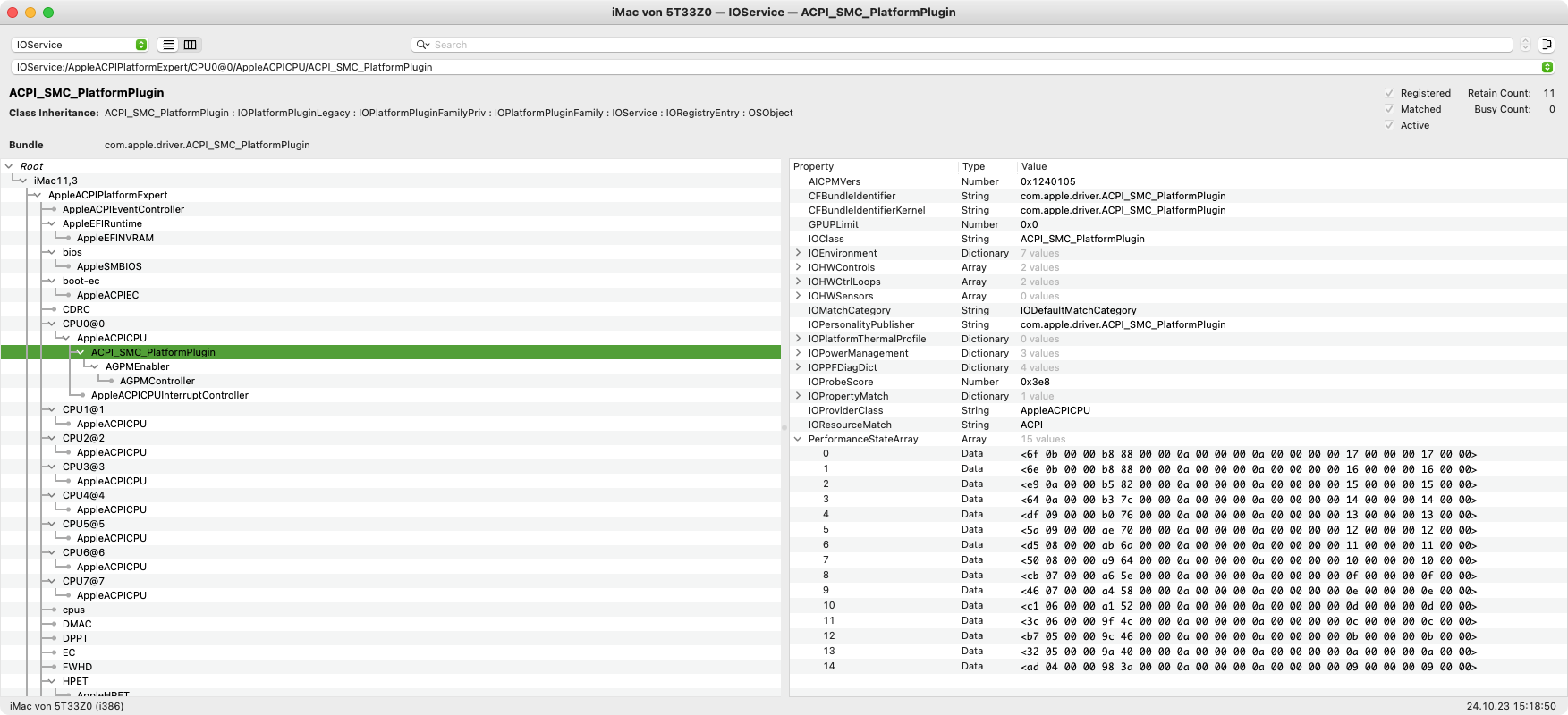

mrmacdi2 Posted October 24, 2023 Share Posted October 24, 2023 (edited) On 4/21/2023 at 2:25 PM, aben said: Once booted, you can confirm if the patch was successful by checking your CPU objects in ioreg; they should attach to ACPI_SMC_PlatformPlugin. I have overclocked Lynnfield CPU (3.6Ghz, stock 2.66Ghz) and PM works in very strange way: I have only the lowest multiplier x9 and the highest x20/21, no states in between. Also all cores adjust freq at the same time, so no cores with high and low freq mixed: Spoiler Low: High: The same behaviour when CPU runs at stock freq: 2.66Ghz. Additionally I use ASPP-Override.kext (prioritizes plugin-type 0 over plugin-type 1), DummyPowerManagement is off in OpenCore. My MB with Bios, so no CFG Lock: Quote 00:913 00:125 OCCPU: EIST CFG Lock 0 OC Log for CPU: Spoiler 00:663 00:124 OCCPU: Found Intel(R) Core(TM) i5 CPU 750 @ 2.67GHz 00:787 00:124 OCCPU: Signature 106E5 Stepping 5 Model 1E Family 6 Type 0 ExtModel 1 ExtFamily 0 uCode 4 CPUID MAX (B/80000008) 00:913 00:125 OCCPU: EIST CFG Lock 0 01:036 00:123 OCCPU: Timer address is 408 from LPC 01:160 00:123 OCCPU: Failed to get FSBFrequency data using Apple Platform Info - Not Found 01:385 00:225 OCCPU: Intel TSC: 3600001148Hz, 3600MHz; FSB: 180000057Hz, 180MHz; MaxBusRatio: 20 01:512 00:126 OCCPU: Detected Apple Processor Type: 06 -> 0602 01:637 00:125 OCCPU: CPUFrequencyFromTSC 3600001148Hz 3600MHz 01:761 00:124 OCCPU: CPUFrequency 3600001148Hz 3600MHz 01:885 00:124 OCCPU: FSBFrequency 180000057Hz 180MHz 02:009 00:124 OCCPU: Pkg 1 Cores 4 Threads 4 IOReg: Spoiler Edited October 24, 2023 by mrmacdi2 Quote Link to comment https://www.insanelymac.com/forum/topic/356076-ventura-1321-installed-and-booting-without-turbo-boost-xeon-e5-2690v2-chinese-x79/page/2/#findComment-2812742 Share on other sites More sharing options...
cankiulascmnfye Posted October 24, 2023 Share Posted October 24, 2023 I've noticed that for older CPU's IORegistryExplorer 2.1 works better. For P-States, for example, it lists the entries in a numbered fashion (and not just as entry "0"): 1 Quote Link to comment https://www.insanelymac.com/forum/topic/356076-ventura-1321-installed-and-booting-without-turbo-boost-xeon-e5-2690v2-chinese-x79/page/2/#findComment-2812743 Share on other sites More sharing options...
