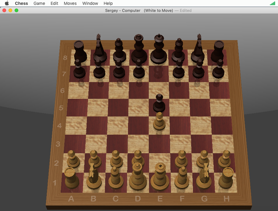

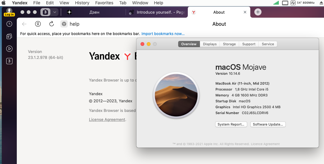

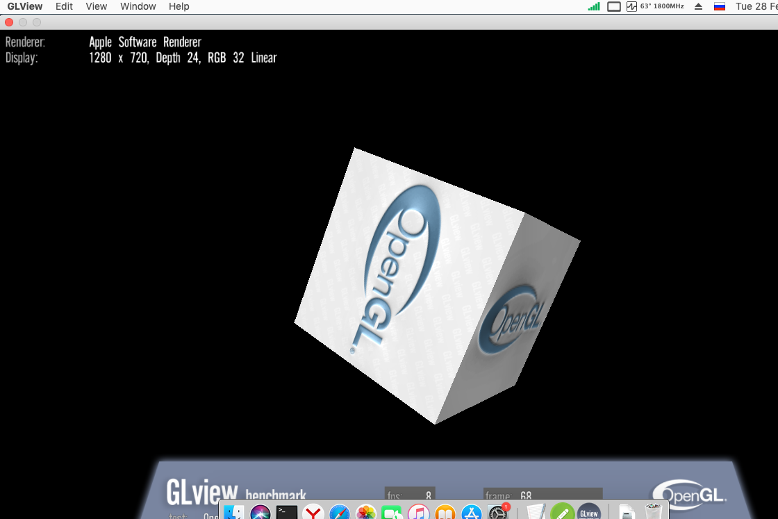

Slice Posted March 1, 2023 Share Posted March 1, 2023 Hey all, We are all very sure that without supported graphics card Hackintosh is impossible. But I want to say it is not a verdict. See. The notebook is ASUS X200CA with CPU Intel(R) Pentium(R) CPU 2117U @ 1.80GHz. No discrete video card. There is only HD2500 which is not supported whatever WEG setting you will use. I install here Mojave 10.14.6 and test. Yes, the graphics memory is 4Mb which mean unsupported. Safari is full of artefacts but I am using Yandex.Browser which is Chromium based. And it works as you see on the screenshot. It also shows video. QuickLook opens JPG files. Next test is Chess. It is playable and without artefacts. Remember this is OpenGL application. Next OpenGL Extensions Viewer. Yes, it is shown and the cube rotates with a framerate 8fps. Slow but works. The explanation is at a top of the picture. Apple has a technology of Software OpenGL and it is here. So.... the hackintosh on the hardware is possible and not so bad as we usually tell. 3 Link to comment https://www.insanelymac.com/forum/topic/355868-unsupported-graphics-is-not-death-warrant/ Share on other sites More sharing options...

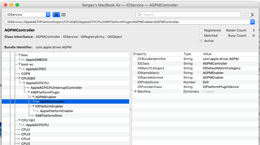

Badruzeus Posted March 1, 2023 Share Posted March 1, 2023 (edited) My question is still; does Graphics Power Management work? I doubt w/o it, the heat will shorten "Soldered CPU's" life.. but, #CMIIW Edited March 1, 2023 by Badruzeus Link to comment https://www.insanelymac.com/forum/topic/355868-unsupported-graphics-is-not-death-warrant/#findComment-2801931 Share on other sites More sharing options...
Slice Posted March 1, 2023 Author Share Posted March 1, 2023 1 hour ago, Badruzeus said: My question is still; does Graphics Power Management work? I doubt w/o it, the heat will shorten "Soldered CPU's" life.. but, #CMIIW Sleep is not working. Brightness is constant. But AGPM is attached 2 1 Link to comment https://www.insanelymac.com/forum/topic/355868-unsupported-graphics-is-not-death-warrant/#findComment-2801932 Share on other sites More sharing options...
