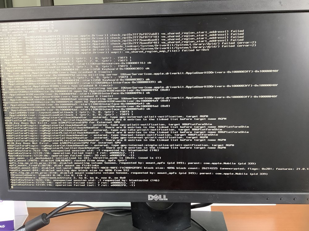

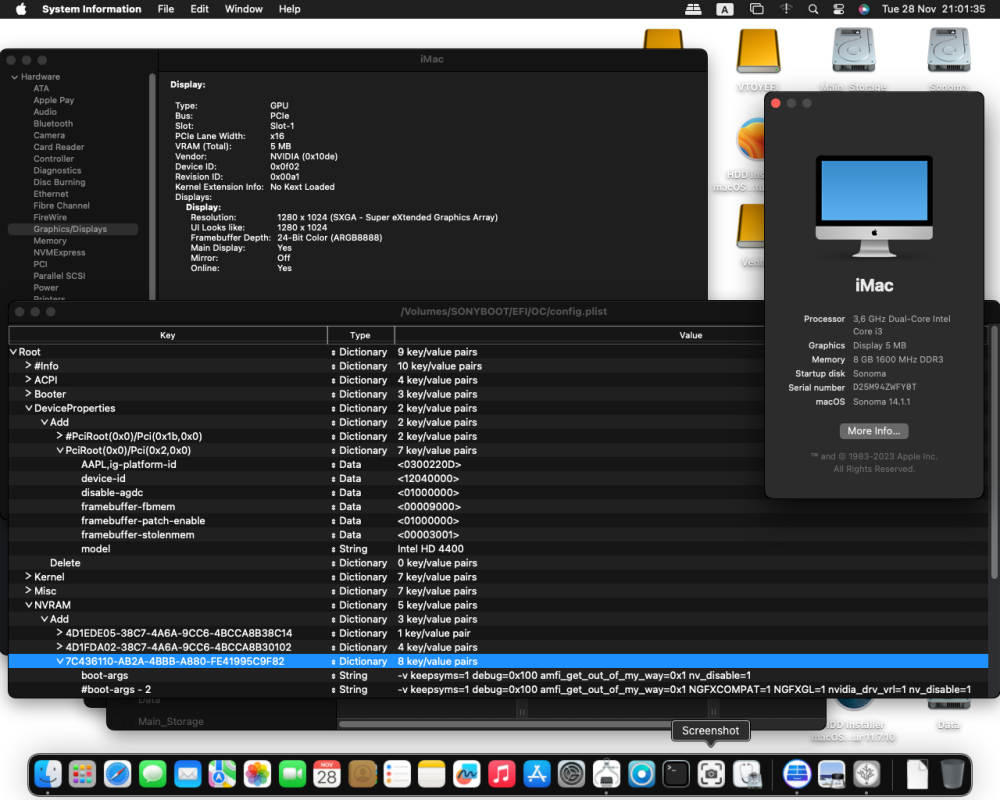

oldman20 Posted November 28, 2023 Share Posted November 28, 2023 On 11/27/2023 at 8:15 PM, ArcaneRhapsody said: I also think that the HD4400 can be made to work. Since you also have a laptop, you might find it useful for tasks that require more power or newer technology. Thank, i try it but still not working. I installed Sonoma on this, olcp patcheable but stuck when boot, need remove patched kext. I tried boot Big Sur or Catalina but cant bootable usb installer I want to use nvidia GT730 (kepler) on that hack. Any suggestions? Many thank Link to comment https://www.insanelymac.com/forum/topic/355531-can%E2%80%99t-patch-graphics-with-oclp-on-intel-intel-hd-graphics-4400-ventura/#findComment-2813997 Share on other sites More sharing options...
cankiulascmnfye Posted November 28, 2023 Share Posted November 28, 2023 1 minute ago, oldman20 said: Thank, i try it but still not working. I installed Sonoma on this, olcp patcheable but stuck when boot, need remove patched kext. I tried boot Big Sur or Catalina but cant bootable usb installer I want to use nvidia GT730 (kepler) on that hack. Any suggestions? Many thank OpenCore Legacy Patcher. Use an empty Framebuffer for the iGPU for IQSV. And use nv_disable=1 boot-arg, so the card runs in VESA mode. After applying root patches, you can remove the boot-arg 1 Link to comment https://www.insanelymac.com/forum/topic/355531-can%E2%80%99t-patch-graphics-with-oclp-on-intel-intel-hd-graphics-4400-ventura/#findComment-2813999 Share on other sites More sharing options...
oldman20 Posted November 29, 2023 Share Posted November 29, 2023 10 hours ago, cankiulascmnfye said: OpenCore Legacy Patcher. Use an empty Framebuffer for the iGPU for IQSV. And use nv_disable=1 boot-arg, so the card runs in VESA mode. After applying root patches, you can remove the boot-arg sorry, more clearly about empty framebuffer? what is IQSV? I using this boot for installing process (success) but failed when trying enable hd4400 or kepler gt730 on Sonoma -v keepsyms=1 debug=0x100 amfi_get_out_of_my_way=0x1 NGFXCOMPAT=1 NGFXGL=1 nvidia_drv_vrl=1 nv_disable=1 Tried boot Big Sur or Catalina but cant 10 hours ago, cankiulascmnfye said: OpenCore Legacy Patcher. Use an empty Framebuffer for the iGPU for IQSV. And use nv_disable=1 boot-arg, so the card runs in VESA mode. After applying root patches, you can remove the boot-arg must i need add anything in DeviceProperties in config.plist for nvidia card? Link to comment https://www.insanelymac.com/forum/topic/355531-can%E2%80%99t-patch-graphics-with-oclp-on-intel-intel-hd-graphics-4400-ventura/#findComment-2814031 Share on other sites More sharing options...
oldman20 Posted November 29, 2023 Share Posted November 29, 2023 (edited) 13 hours ago, cankiulascmnfye said: OpenCore Legacy Patcher. Use an empty Framebuffer for the iGPU for IQSV. And use nv_disable=1 boot-arg, so the card runs in VESA mode. After applying root patches, you can remove the boot-arg i tried olcp and cant boot, but system not freeze (Pic. 2) (keyboard Caps Lock still respon) must plugout power to reboot and restore snapshot to boot (Pic. 1) Edited November 29, 2023 by oldman20 Link to comment https://www.insanelymac.com/forum/topic/355531-can%E2%80%99t-patch-graphics-with-oclp-on-intel-intel-hd-graphics-4400-ventura/#findComment-2814034 Share on other sites More sharing options...
cankiulascmnfye Posted November 29, 2023 Share Posted November 29, 2023 (edited) @oldman20 Empty Framebuffer = iGPU is only used for computational tasks and not displaying a picture. IQSV (= Intel QuickSync Video) is a computational task, for example. And since you didn't follow my instructions your iGPU is now misconfigured. Because you have BOTH iGPU and GPU configured for displaying picture. So, change the following: AAPL,ig-platform-id to 04001204 Leave Device ID as is Disable framebuffer… entries (put # in front), dlete the agdc entry Delete nvidia_drv_vrl=1 >> Not required for kepler card. Otherwise you tell the system to load web drivers (which are not present anyway) while telling it to use VESA mode at the same ime. BTW: the correct boot-arg is nvda_drv_vrl=1 NOT nvidia_drv_vrl=1 Save the config.plist and Reboot. Edited November 30, 2023 by cankiulascmnfye 2 Link to comment https://www.insanelymac.com/forum/topic/355531-can%E2%80%99t-patch-graphics-with-oclp-on-intel-intel-hd-graphics-4400-ventura/#findComment-2814043 Share on other sites More sharing options...
ArcaneRhapsody Posted November 29, 2023 Share Posted November 29, 2023 21 hours ago, oldman20 said: Thank, i try it but still not working. I installed Sonoma on this, olcp patcheable but stuck when boot, need remove patched kext. I tried boot Big Sur or Catalina but cant bootable usb installer I want to use nvidia GT730 (kepler) on that hack. Any suggestions? Many thank Hmmm... NVIDIA GT730 might work. Just check those BIOS settings and make sure your bootable USB for Big Sur or Catalina has the right setup. It can be tricky, but you've got this. 1 Link to comment https://www.insanelymac.com/forum/topic/355531-can%E2%80%99t-patch-graphics-with-oclp-on-intel-intel-hd-graphics-4400-ventura/#findComment-2814052 Share on other sites More sharing options...
