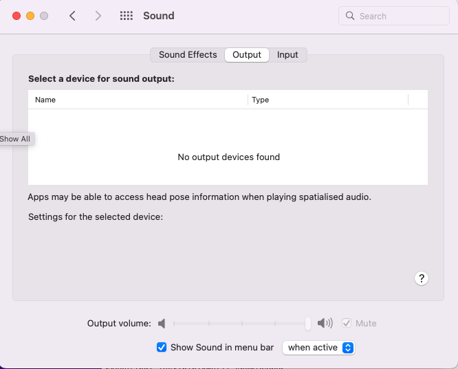

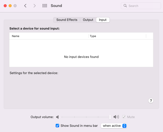

Hi guys, I have Monterey 12.6.3 install with clover r5151 and with the latest applealc.kext and whatevergreen.kext There I have biostar radeon rx550 4GB lexa core gpu with spoofed device-id 0x67ff Everything works just fine I have native graphics with metal accelaration. However no hdmi audio.
empty list in settings/audio/output

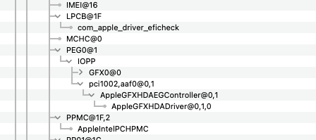

ioreg -rxn AppleGFXHDADriver | grep vendorcodecID gives me this:
      "vendorcodecID" = 0x1002aa01

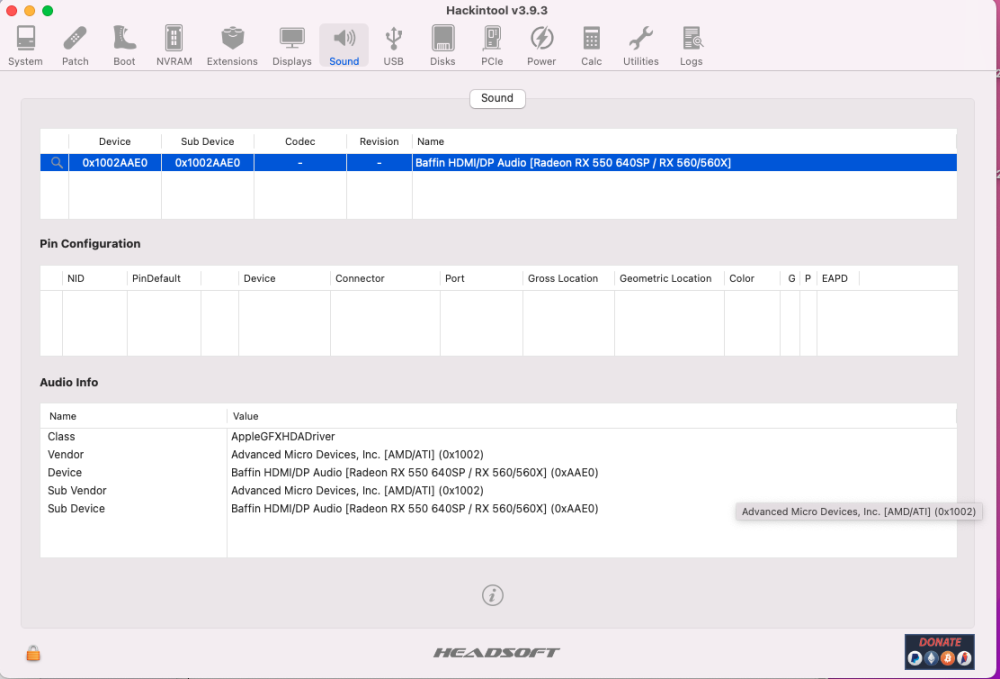

Hackintool also shows this audio adapter like a good one

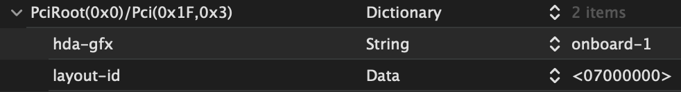

@Dmitry R
This code in Devices >> Properties fixed this issue for me.
  • check the PCI path to your audio device (the one on the motherboard, not the AMD), it can be different
  • check your layout-id (I have 7, yours can be different)
  • probably you have to enable Audio >> Inject from NO to the right layout-id.
6 hours ago, miliuco said:
@Dmitry R
Not needed at all.

Finally I've got it working 🙂 As far as it is a proxmox vm with passed through gpu, to make hdmi sound work I have to
  • pass through all functions at once
  • No extra patching is required
  • during boot  a monitor without audio should be connected to the dp of the gpu
  • after succsessful booting any gpu connector can be used to connect a device with speakers
