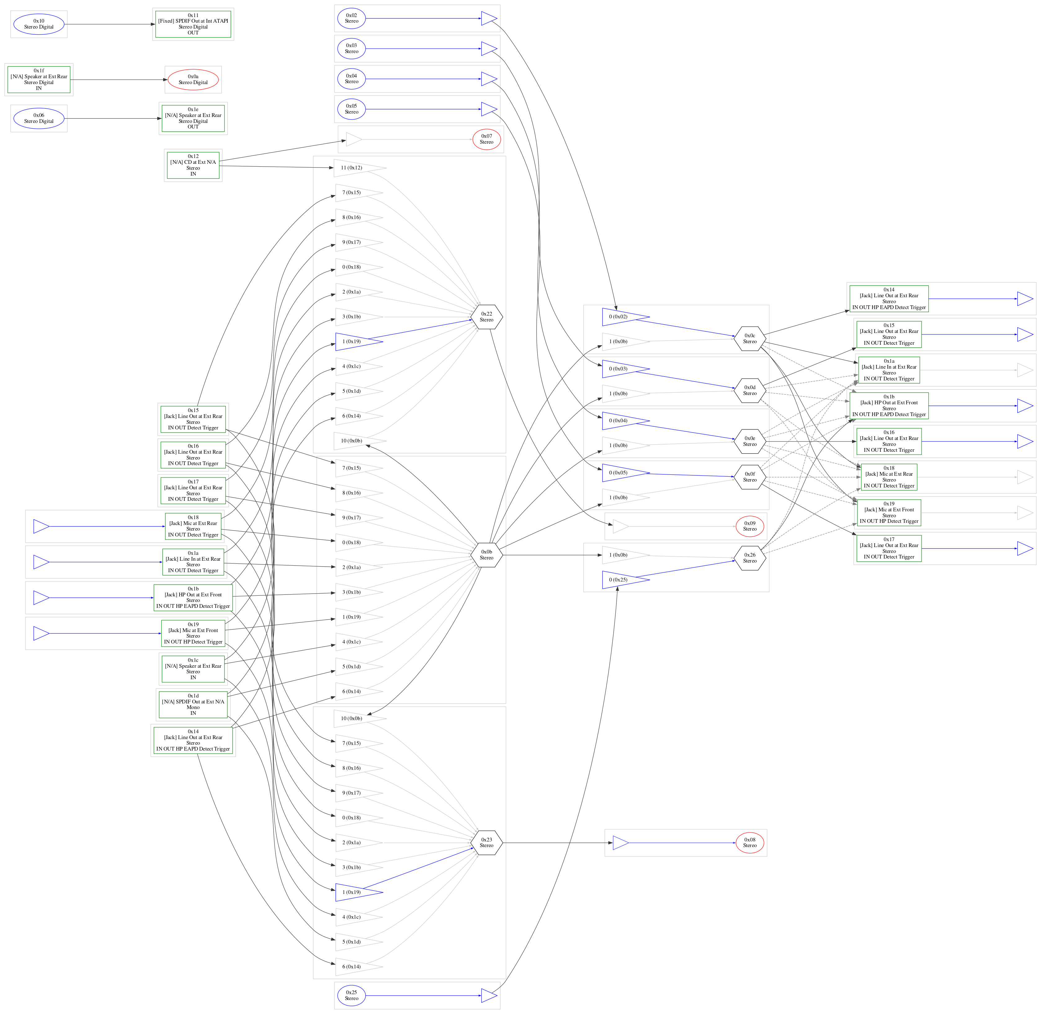

Fortitude Posted December 24, 2022 Share Posted December 24, 2022 (edited) Hi @SkyrilHD, Wow your CodecDump looks insane haha! (I’m coming from a laptop so mine’s not as crazy lol.) I’m confused with your original post… You have 8 channel outputs, but 4 Line-Out in macOS? I’m assuming that they’re stereo. What you’re trying to accomplish might actually in fact be possible as AppleHDA does have native multi-channel output support, but it appears to be mostly uncharted territory within HackintoshLand and might require some experimentation as there’s not really a guide for this currently. (This “multi-channel output aggregation patch” might help me out too with an issue that I’m facing on my system so I’m interested in taking a look at it with you to see what I can find.) This person many years ago created a six channel aggregate output for their codec using SignalProcessing parameters within their layoutID file. I would advise you to take a look at this first for ideas. I’m a little familiar with the SignalProcessing parameters as I’ve unraveled the ones for EQ, but nothing of this scale haha. Not sure which OS you have, but in macOS Big Sur version 11.5.2 (20G95), there are 49 DSPs available (I used Ida Pro to unravel these parameters): Delay GainStage ClientGainAdjust Equalization Equalization32 FIREqualization MultibandDRC DynamicRange StereoEnhancer BassEnhancer DCBlocker Crossover2Way Crossover2Dot1 Crossover2Dot2 NoiseCanceller BeamFormer 2ChInput 3ChOutput 4ChOutput 6ChOutput 2To4Splitter CalibrationEQ Volume Volume_4ch Volume_3ch Limiter MultiBandCompressor Loudness StereoToMono Virtualization AudioMeter 2To6Splitter PreGainStage AutoGainControl SplineLimiter Sum SplitBand Beam2 MozartCompressor MozartCompressorDualBand BuzzKill ControlFreak2ch ControlFreak4ch XTC_2chIn_2chOut XTC_2chIn_4chOut ThermalSpeakerProtection2ch ThermalSpeakerProtection4ch FIRdirect_2chIn_2chOut FIRdirect_2chIn_4chOut Take a look within the AppleHDA kext for your OS to see if you can find a layoutID file with a SignalProcessing function called DSP4ChOutput or similar. I’ll see if I can find it on my OS. We need to work out how the parameters work for this patch. Edited December 24, 2022 by Fortitude Quote Link to comment https://www.insanelymac.com/forum/topic/355142-applealc-combine-multiple-line-out-into-a-single-multichannel-output/#findComment-2799232 Share on other sites More sharing options...

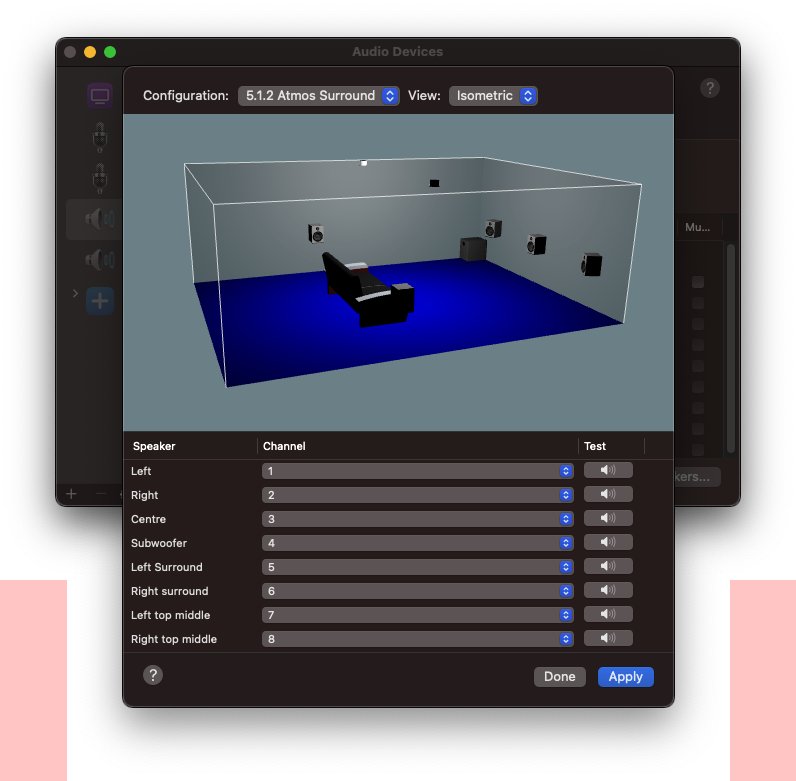

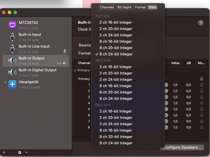

SkyrilHD Posted December 24, 2022 Author Share Posted December 24, 2022 (edited) 8 hours ago, Slice said: It is not possible with AppleALC. It is possible with VoodooHDA. Yep, tried VoodooHDA on my second boot drive and it works. Sadly, I want to keep my SIP enabled (as I want to keep "Full Security"), so I might pass this one. Also my microphone does not work for some reason. 4 hours ago, Fortitude said: I’m confused with your original post… You have 8 channel outputs, but 4 Line-Out in macOS? I’m assuming that they’re stereo. Sorry, explained it very poorly. Basically I have 4 Output Jacks (per Jack with Stereo, so 8 channels in total). 4 hours ago, Fortitude said: This person many years ago created a six channel aggregate output for their codec using SignalProcessing parameters within their layoutID file. I would advise you to take a look at this first for ideas. I followed this guide (only the Platforms part) and now I have 8 channels working! (Also if I want to I can even select 2 channels only; A very nice feature) However this now raised another issue: The audio plays very weird as if the CPU is under load. (on 6 channels, I still have the same issue but it is a bit better) Sadly, changing the audio format in Audio-MIDI-Setup does not help. EDIT: Forgot to tell more about my hardware: Intel Core i5-12400F AMD Radeon RX 6600XT (so I can't run anything lower than 12.1) macOS Ventura 13.1 Edited December 24, 2022 by SkyrilHD Quote Link to comment https://www.insanelymac.com/forum/topic/355142-applealc-combine-multiple-line-out-into-a-single-multichannel-output/#findComment-2799242 Share on other sites More sharing options...
