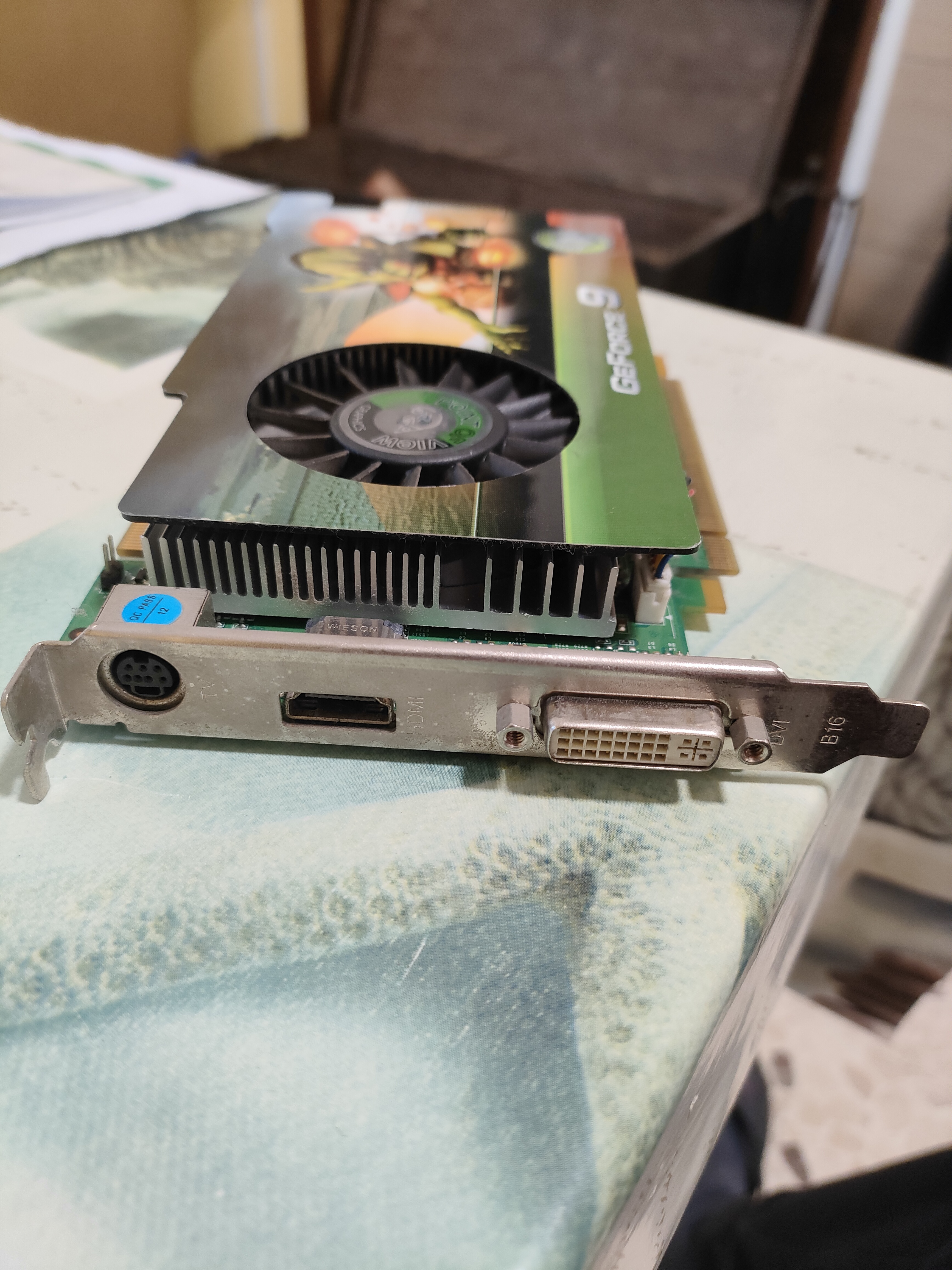

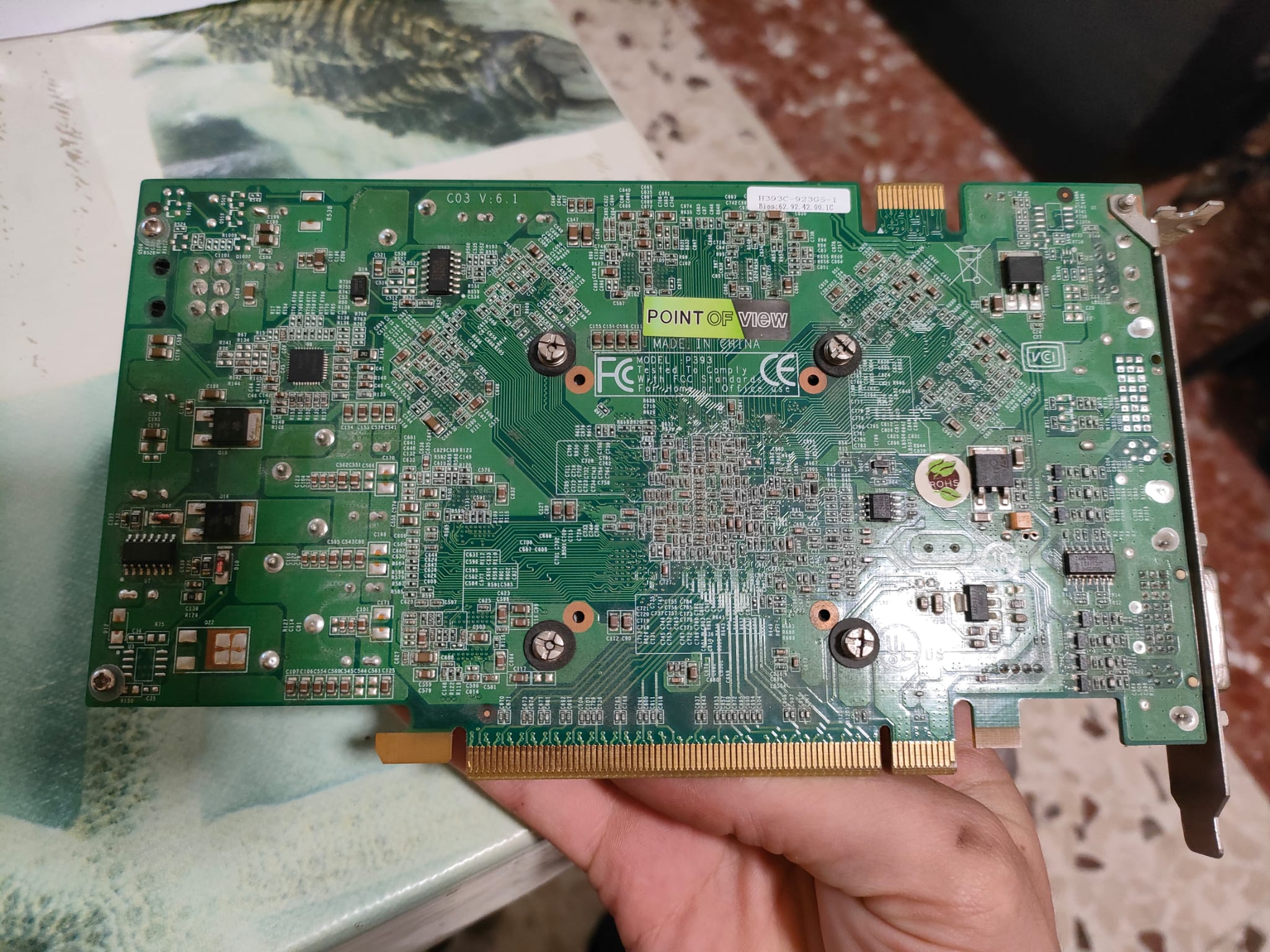

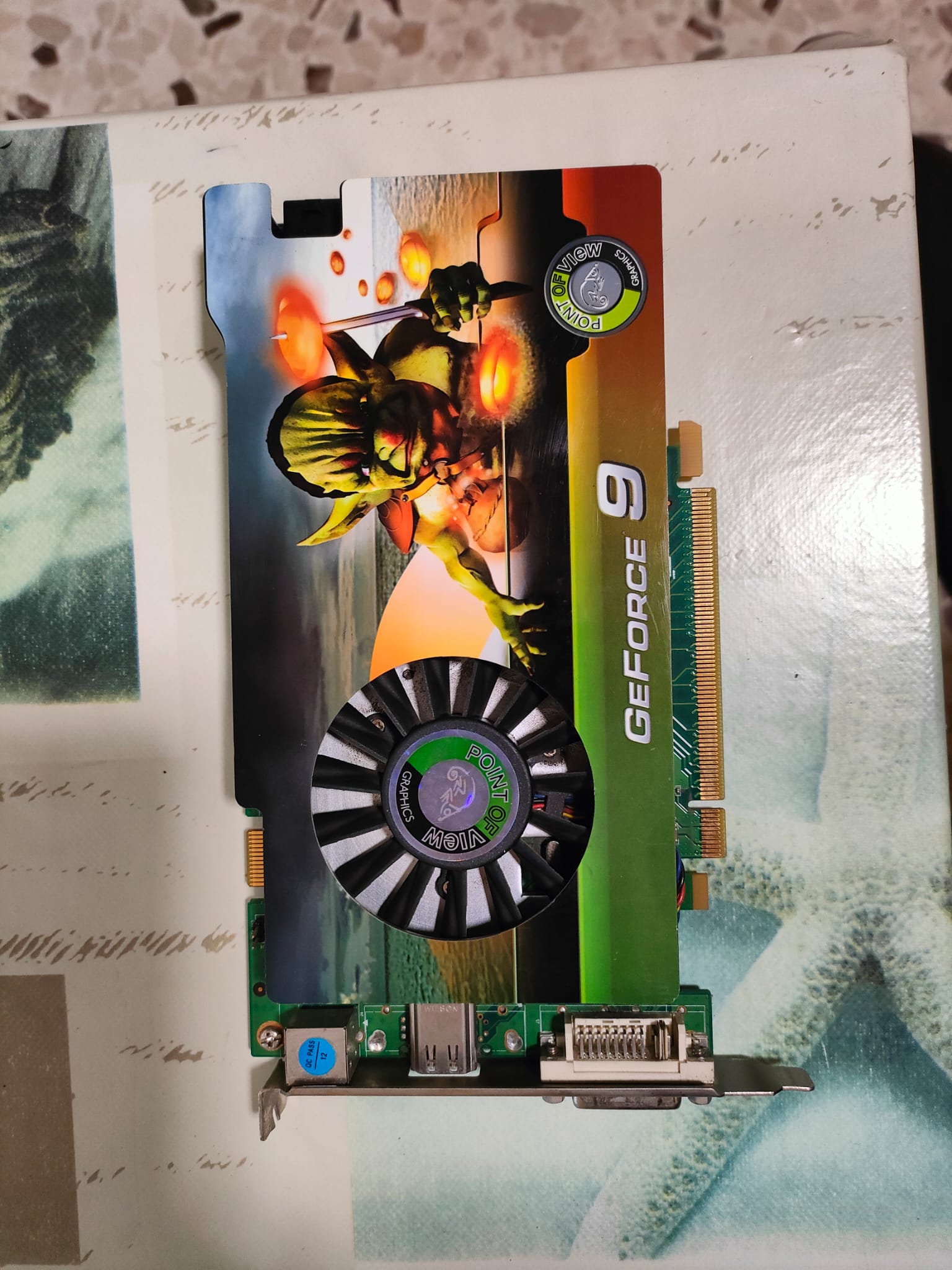

Matteo Fantino Posted November 30, 2022 Author Share Posted November 30, 2022 @Slice @aben For example, I found this GeForce 9 graphics card. But I don't know the exact model because it's not written there and I wouldn't know how to find it. Do you think it is compatible with MacOs hackintosh. And if it was compatible with which versions? Seems like a pretty old series to me. I post the photos so maybe you recognize it and you can give me some feedback. Thanks to. Quote Link to comment https://www.insanelymac.com/forum/topic/354910-install-latest-macos-version-on-amd-desktop-pc/page/2/#findComment-2798049 Share on other sites More sharing options...

aben Posted November 30, 2022 Share Posted November 30, 2022 @Matteo Fantino I believe the correct model is GeForce 9600 GT, which is based on Tesla architecture. Last supported macOS will be High Sierra. 1 Quote Link to comment https://www.insanelymac.com/forum/topic/354910-install-latest-macos-version-on-amd-desktop-pc/page/2/#findComment-2798051 Share on other sites More sharing options...
Slice Posted November 30, 2022 Share Posted November 30, 2022 It is 8800GT, yes, Tesla, yes High Sierra. https://nazya.com/ebay/product/videokarta-nvidia-p393-geforce-8800gt-512-256ddr3-sdram-180103930002b00_274137236247.html 1 Quote Link to comment https://www.insanelymac.com/forum/topic/354910-install-latest-macos-version-on-amd-desktop-pc/page/2/#findComment-2798054 Share on other sites More sharing options...
