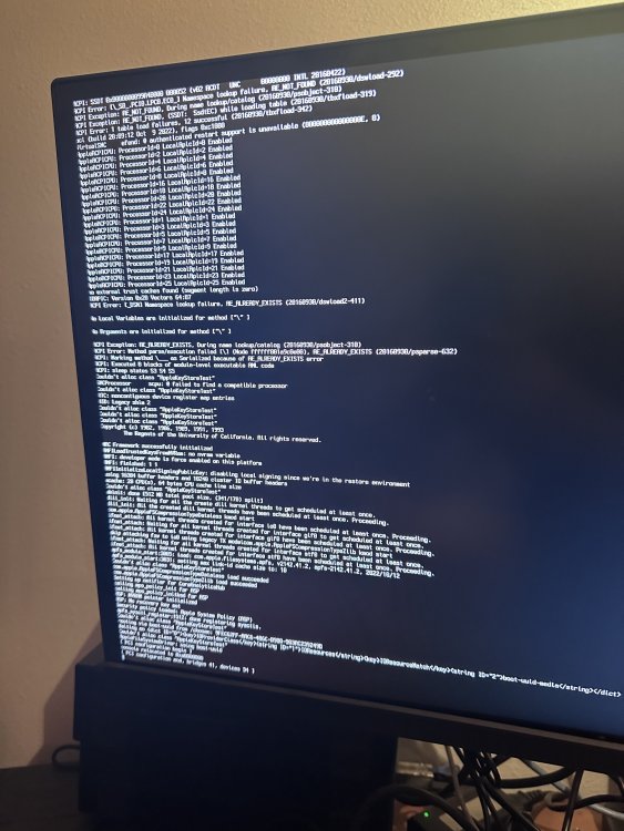

genzai Posted November 27, 2022 Share Posted November 27, 2022 hello Community, I have an x99 designare that runs perfectly with Monterey (EFI attached), but when trying to upgrade to or install Ventura it hangs early in the boot with "PCI Configuration Begin" the last thing on screen. Obviously this is not an unusual problem in the history of Hackintosh, and this system has always needed ncpi=0x2000, but I have no idea why this issue is happening during the Ventura install. I have tried removing npci=0x2000 and tried npci=0x3000 but both those options still hang with PCI Configuration Begin the last line on screen. Much appreciate any guidance. g\ x99desi-redacted-EFI.zip Link to comment Share on other sites More sharing options...

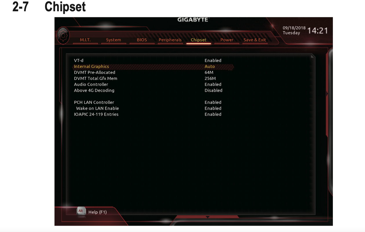

startergo Posted November 28, 2022 Share Posted November 28, 2022 (edited) add npci=0x2000 or npci=0x3000 (try both one at a time) to boot. Disregard this I saw that you tried that already. I am looking at the z390 designware manual page 58 Quote Above 4G DecodingEnables or disables 64-bit capable devices to be decoded in above 4 GB address space (only if your system supports 64-bit PCI decoding). Set to Enabled if more than one advanced graphics card are installed and their drivers are not able to be launched when entering the operating system (because of the limited 4 GB memory address space). (Default: Disabled) Do you have the latest bios? Edited November 28, 2022 by startergo Link to comment Share on other sites More sharing options...
startergo Posted November 28, 2022 Share Posted November 28, 2022 (edited) There is z390 OC GitHub page: https://github.com/seven-of-eleven/designare-z390-opencore-efi F9j bios version introduced Resizable bar option and It is not even the latest Bios: https://www.gigabyte.com/Motherboard/Z390-DESIGNARE-rev-10/support#support-dl-bios The latest bios F9: Quote Introduce capsule BIOS support starting this version. Customers will NOT be able to reverse to previous BIOS version due to major vulnerabilities concerns. Edited November 28, 2022 by startergo Link to comment Share on other sites More sharing options...

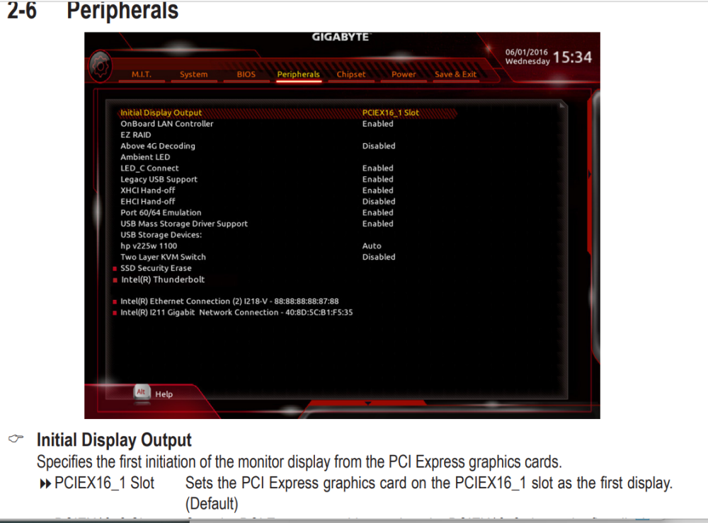

startergo Posted November 29, 2022 Share Posted November 29, 2022 4 hours ago, genzai said: X99 Designare EX You still have Above 4G decoding in the settings. mb_manual_ga-x99-designare-ex_e.pdf (gigabyte.com) Can you save the BIOS settings to a file and post it here? Link to comment Share on other sites More sharing options...

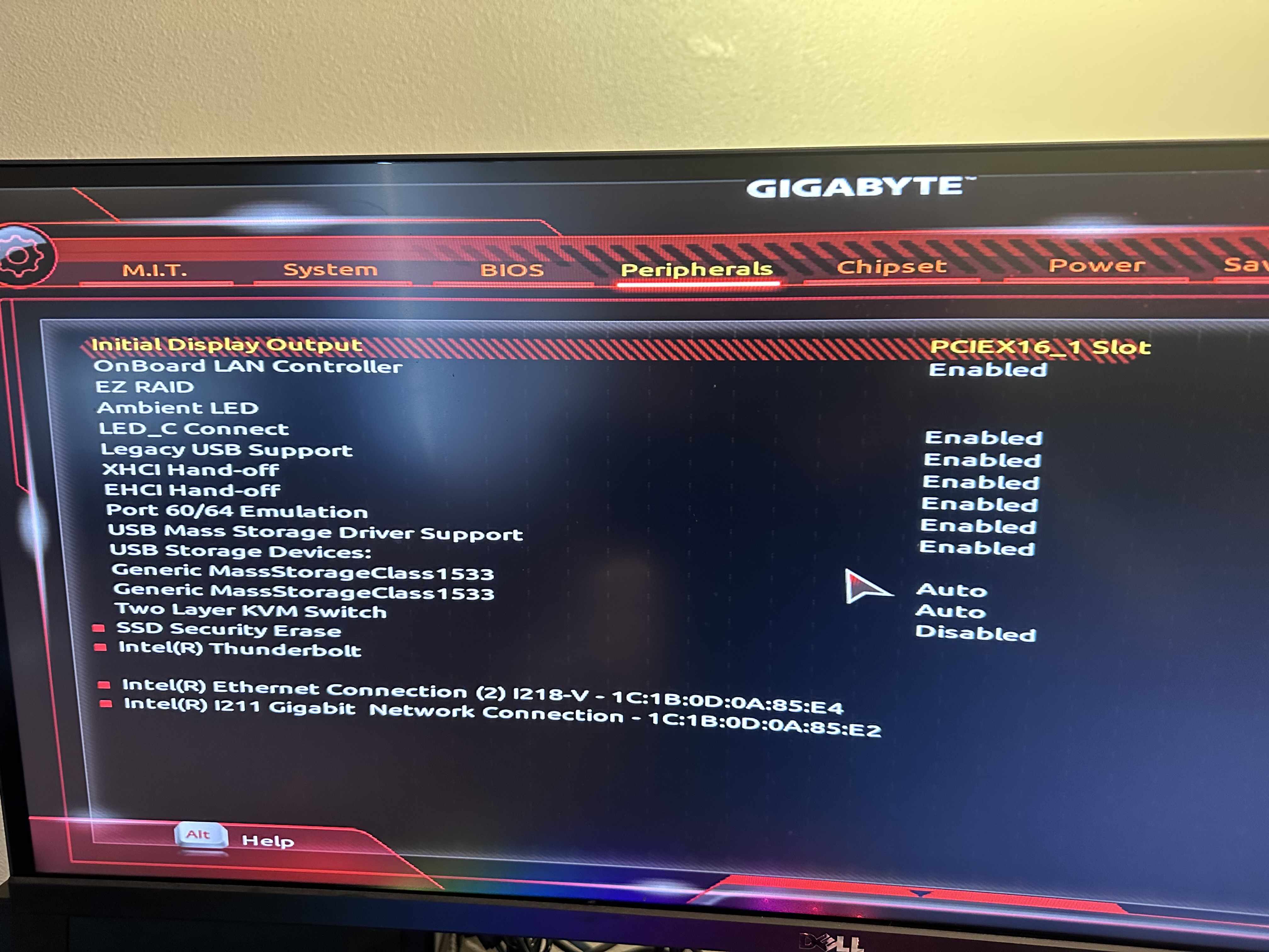

genzai Posted November 29, 2022 Author Share Posted November 29, 2022 (edited) 20 hours ago, startergo said: You still have Above 4G decoding in the settings. mb_manual_ga-x99-designare-ex_e.pdf (gigabyte.com) Can you save the BIOS settings to a file and post it here? I am not sure where the discrepancy is, but this is a screenshot of my BIOS page. I've never had an above 4G option on this board. Currently running latest f5c BIOS. I have also attached my bios setting file that works well for Catalina and Monterey. I'll also try the x299Sata kext, though that seems like a bit of a long shot. Thanks, g\ s0-restore Edited November 29, 2022 by genzai Link to comment Share on other sites More sharing options...

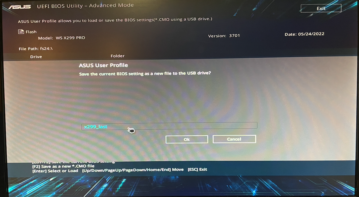

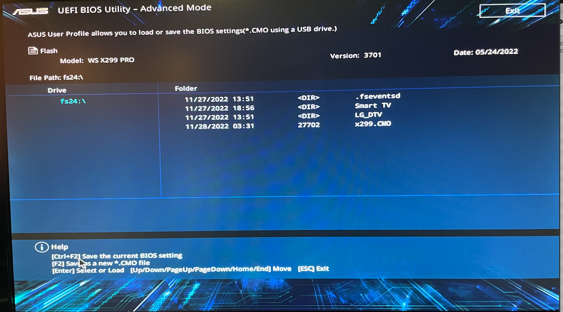

startergo Posted November 30, 2022 Share Posted November 30, 2022 I got 2 options. Ctrl+F2 saves as text and F2 only as CMO. x299_last_setting.txt Link to comment Share on other sites More sharing options...
genzai Posted November 30, 2022 Author Share Posted November 30, 2022 1 hour ago, startergo said: I got 2 options. Ctrl+F2 saves as text and F2 only as CMO. Those options are specific to Asus UEFI, not available on gigabyte boards. I tried some googling and don't think it's possible on gigabyte boards to save a txt or human readable bios profile file. But I assure you there is no above 4G setting on this board. Thanks, g\ Link to comment Share on other sites More sharing options...
