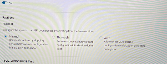

oronfel2911 Posted November 28, 2022 Author Share Posted November 28, 2022 (edited) Hello @Allan I can not disable the fast boot in BIOS as I don't have this option avalable see the image bellow and I got No variant specified, falling back to release in "terminal command" Terminal Saved Output Edited November 28, 2022 by oronfel2911 Link to comment https://www.insanelymac.com/forum/topic/354814-intel-wi-fi-6-ax201-160mhz-is-unstable-keeps-disconnecting/#findComment-2797906 Share on other sites More sharing options...

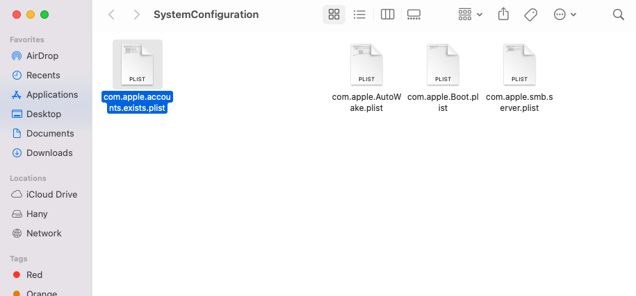

Allan Posted November 28, 2022 Share Posted November 28, 2022 And this too? Resetting System Preferences - Network Link to comment https://www.insanelymac.com/forum/topic/354814-intel-wi-fi-6-ax201-160mhz-is-unstable-keeps-disconnecting/#findComment-2797916 Share on other sites More sharing options...
oronfel2911 Posted November 28, 2022 Author Share Posted November 28, 2022 I did Resetting System Preferences Link to comment https://www.insanelymac.com/forum/topic/354814-intel-wi-fi-6-ax201-160mhz-is-unstable-keeps-disconnecting/#findComment-2797930 Share on other sites More sharing options...
deeveedee Posted December 10, 2022 Share Posted December 10, 2022 @oronfel2911 Sorry I can't help with the Wi-Fi, but you want to change your BIOS Fastboot setting to "Thorough" 2 Link to comment https://www.insanelymac.com/forum/topic/354814-intel-wi-fi-6-ax201-160mhz-is-unstable-keeps-disconnecting/#findComment-2798568 Share on other sites More sharing options...

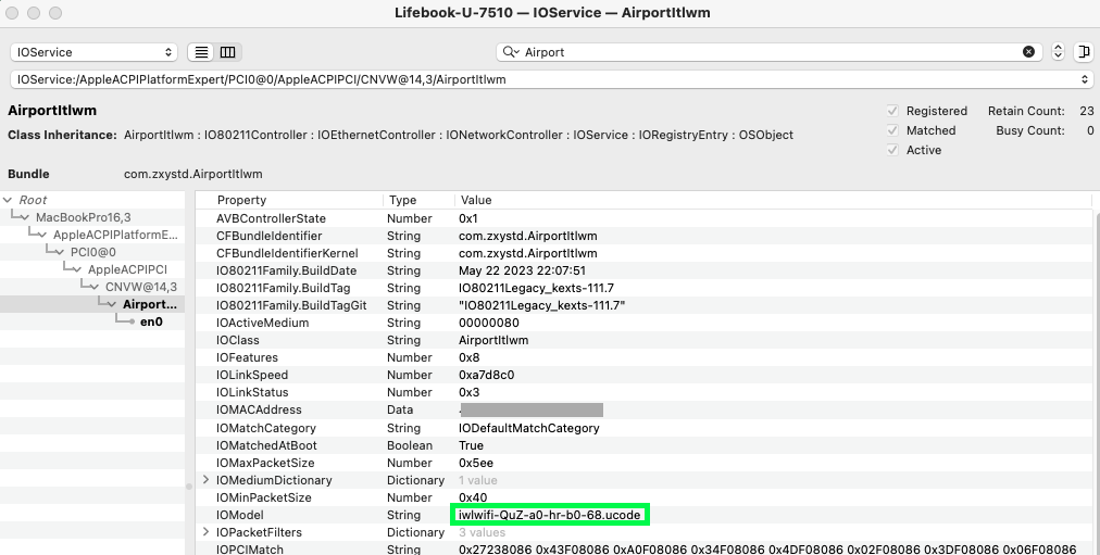

schrup21 Posted November 22, 2025 Share Posted November 22, 2025 (edited) One thing I would generally recommend: Set different SSIDs for 2.4 GHz and 5 GHz on your Wi-Fi router and only use the 5 GHz network in macOS. This can help avoid or reduce Wi-Fi/Bluetooth coexistence problems. don't know if this helps: I don't have issues with my AX201 and never had - but I built my own Intel Wifi KEXTs with the latest Firmware from the Linux Repository. https://git.kernel.org/pub/scm/linux/kernel/git/iwlwifi/linux-firmware.git You can determine firmware model of your module with IoRegistryExplorer: Spoiler ...and put the one from the linux repository in the firmware folder of the cloned Itlwm repository folder: Spoiler Because you only need the one for your module, all the rest of the firmware files can be deleted, which drastically reduces the file size of the KEXTs - The Debug Version of Lilu has to be placed in the Itlwm Repository folder as well as MacKernelSDK - Built the KEXTs within the Itlwm folder (terminal): xcodebuild -project itlwm.xcodeproj -configuration Release -alltargets build This is not entirely true: "Intel Wi-Fi 6 AX201" WiFi 6 is not possible as it's "currently disabled" according the developer. IntelBluetooth can be compiled using the same method. However, the required firmware must be determined using dmesg (DebugEnhancer): sudo dmesg | grep IntelFirmware Edited November 22, 2025 by schrup21 Link to comment https://www.insanelymac.com/forum/topic/354814-intel-wi-fi-6-ax201-160mhz-is-unstable-keeps-disconnecting/#findComment-2844030 Share on other sites More sharing options...
