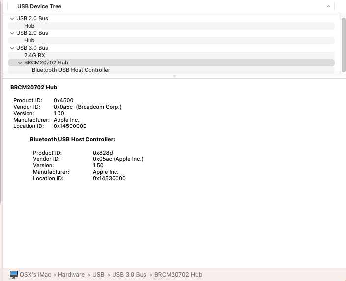

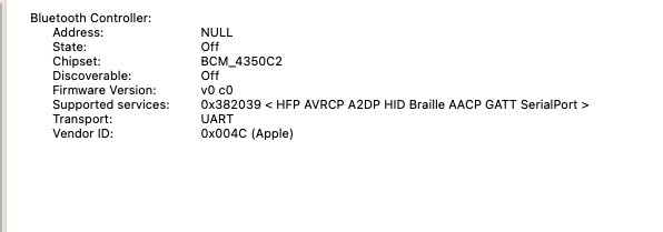

Today I installed the card, WiFi works perfectly, Bluetooth is detected but not functional (under Windows everyting works).

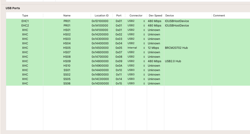

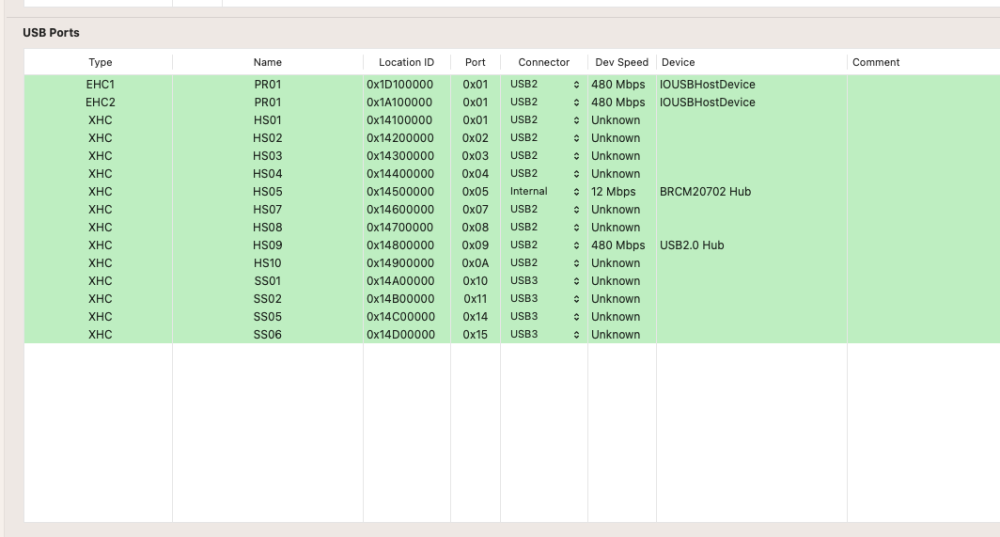

I was mapping the USBs hundreds of times with the previous mapped USB kext  and amls. So today I decided to make one last try and remove USBPort.kext and UIAC and USBX AMLs from my EFI folder. Then put only USBInjectall.kext.
I reboot and map USBs with hackintool by this way and VOILA! now everything works OOB!
So I hope that I`ll be useful with this post! Its all about 10 minutes of proper mapping!
