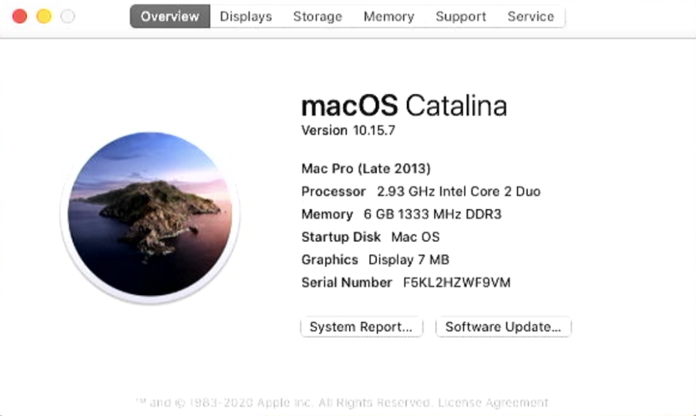

carsonr Posted September 10, 2022 Share Posted September 10, 2022 Hello, I am currently trying to get graphics acceleration with my R7 240. It does not have graphics acceleration despite applying a FakeID. I have a sneaking suspicion that MaciASL removing the _s is causing it to not work, I'm not sure though as it does seem to automatically remove them. I've seen success with Clover (https://www.tonymacx86.com/threads/r7-240-r7-340-hd-8570-no-graphics-acceleration-under-catalina.292477/page-3) but I'm not sure what the OpenCore equivalents would be, any help would be greatly appreciated. As you can see in this image it'a not being recognized as a R7 240, the FakeID instructions don't seem to work! (https://dortania.github.io/Getting-Started-With-ACPI/Universal/spoof.html) Link to comment https://www.insanelymac.com/forum/topic/353421-amd-r7-240-does-not-work-in-catalina/ Share on other sites More sharing options...

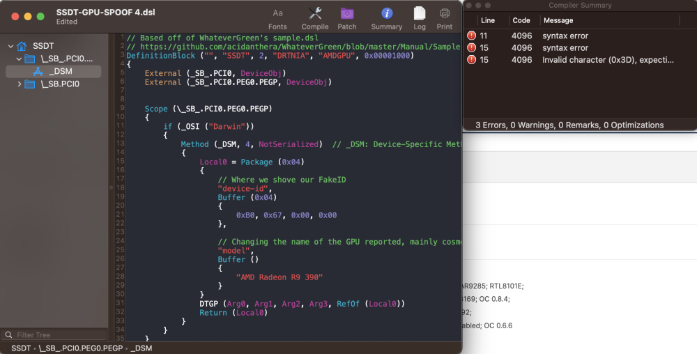

carsonr Posted September 27, 2022 Author Share Posted September 27, 2022 I went to go try the new FakeID and I am running into compile errors: Is anyone familiar and maybe can help with this? I want to get to the bottom of Oland compatibility with Catalina. Link to comment https://www.insanelymac.com/forum/topic/353421-amd-r7-240-does-not-work-in-catalina/#findComment-2794046 Share on other sites More sharing options...
Slice Posted September 27, 2022 Share Posted September 27, 2022 I think there are invisible symbols in your file. Link to comment https://www.insanelymac.com/forum/topic/353421-amd-r7-240-does-not-work-in-catalina/#findComment-2794047 Share on other sites More sharing options...

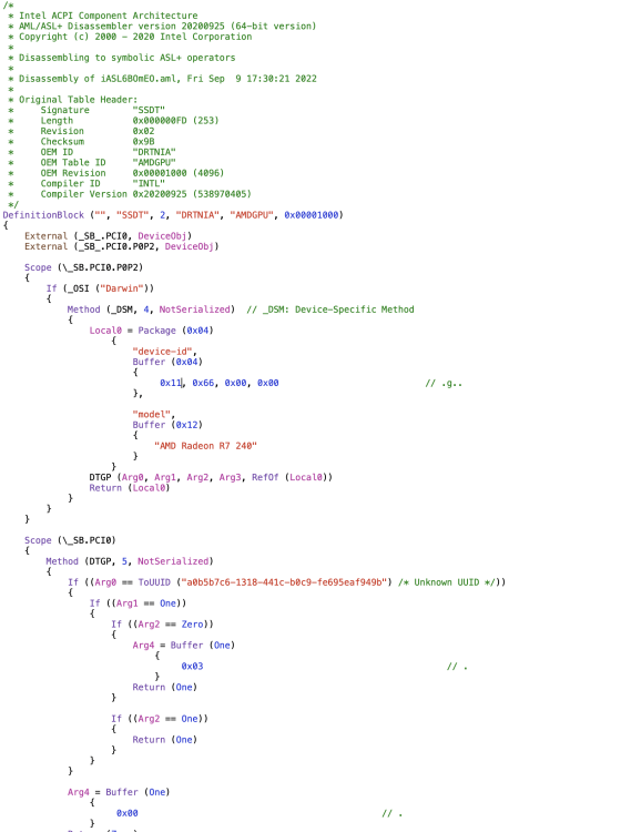

carsonr Posted September 27, 2022 Author Share Posted September 27, 2022 (edited) I have a stock Dell OEM card (R7 240). I was able to inject the fake ID with the correct vram working on Catalina using the FakeID 6798. Make sure that the fakeID is actually being injected, under System Information > Graphics > device-id. Here's a better way to inject a fakeID DefinitionBlock ("", "SSDT", 2, "CORP", "AMDGPU", 0x00001000) { External (_SB_.PCI0.P0P2, DeviceObj) // Parent object Reference Scope (\_SB_.PCI0.P0P2) { If (_OSI ("Darwin")) { // We need to create a new device - as GFX0 is not defined in your ACPI Device (GFX0) { // Use address 0, as it's GFX@0 in your ioreg Name (_ADR, Zero) // Now we can setup our _DSM and inject properties Method (_DSM, 4, NotSerialized) { If (LEqual (Arg2, Zero)) { Return (Buffer (One) { 0x03 }) } Return (Package () { "device-id", Buffer () { 0xB0, 0x67, 0x00, 0x00 }, "model", Buffer () { "AMD Radeon R9 390" } }) } } } } } Edited November 24, 2022 by carsonr Link to comment https://www.insanelymac.com/forum/topic/353421-amd-r7-240-does-not-work-in-catalina/#findComment-2794097 Share on other sites More sharing options...
