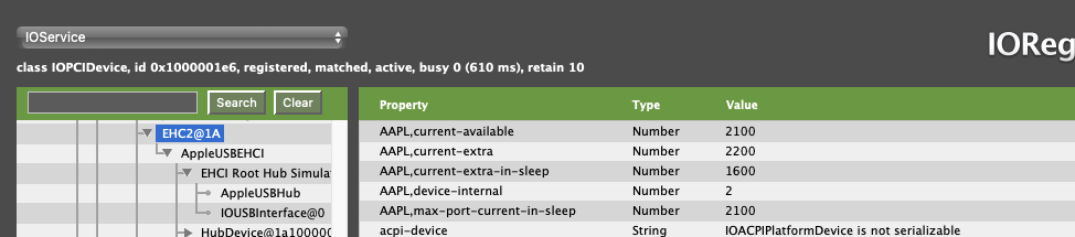

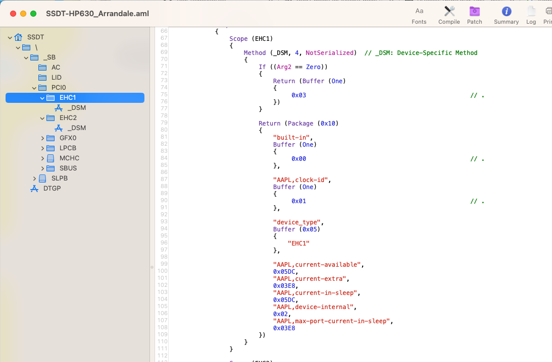

Baio77 Posted August 15, 2022 Share Posted August 15, 2022 (edited) Try adding _DSM USB. Ioreg true mac same as your SMBios. Give me the whole EFI thanks. Describe the brand model of the laptop. Post ioreg please , you could disable and swichare the USB 2.0 on XHC and solve various problems. Example: take care of HP 630 SMBios MacbookPro 6.2, you need other values. Edited August 15, 2022 by Baio77 Quote Link to comment https://www.insanelymac.com/forum/topic/352970-ssdt-patch-for-instant-wake-lg-sd550-hm77/#findComment-2791478 Share on other sites More sharing options...
