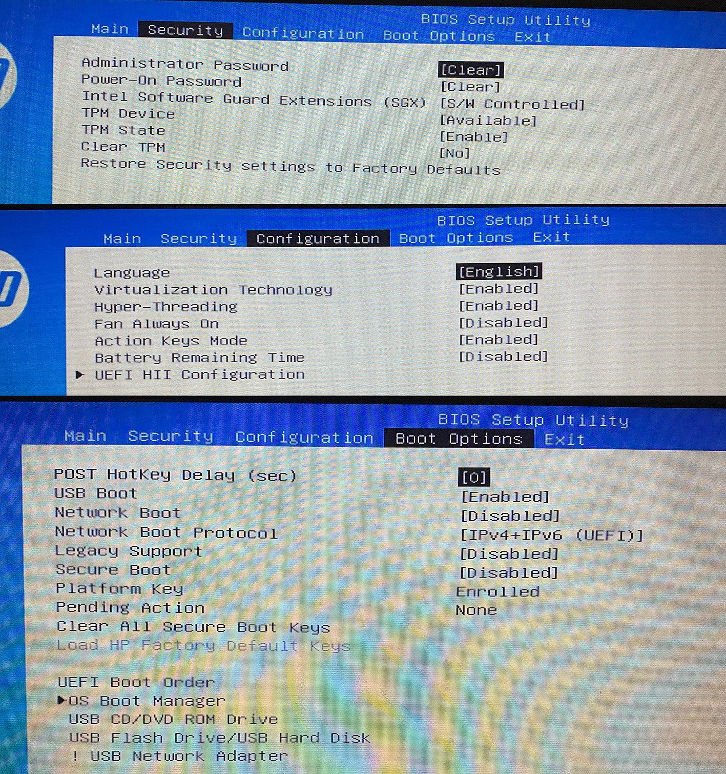

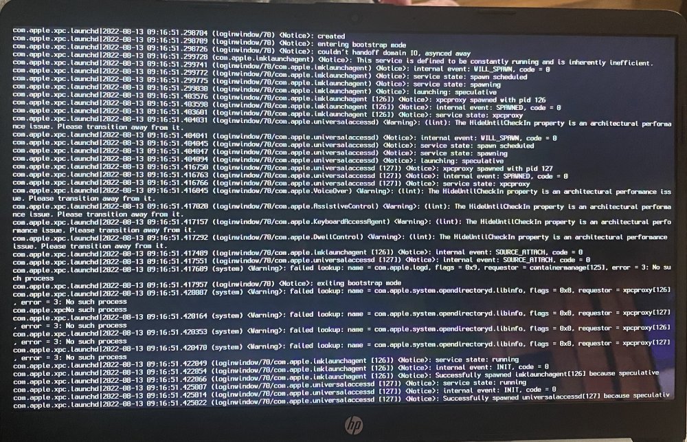

oronfel2911 Posted August 13, 2022 Author Share Posted August 13, 2022 Thanks Sir, I Updated my Signature attached the EFI that i used (Opencore) and its stuck, and attached the the image of the suck screen. also bios setting attached. i don't know how to boot in verbose mode Thanks and please help EFI.zip Link to comment https://www.insanelymac.com/forum/topic/352956-hp-i5-1035g1-dy1051wm/#findComment-2791359 Share on other sites More sharing options...
oronfel2911 Posted August 14, 2022 Author Share Posted August 14, 2022 Any other information that you need me to provide?? Link to comment https://www.insanelymac.com/forum/topic/352956-hp-i5-1035g1-dy1051wm/#findComment-2791389 Share on other sites More sharing options...
Slice Posted August 14, 2022 Share Posted August 14, 2022 5 hours ago, oronfel2911 said: Any other information that you need me to provide?? I can't help you because of Opencore. Your BIOS looks good and hardware should be compatible with Monterey. Make full ClearCMOS and try to boot by Clover 5148. 1 Link to comment https://www.insanelymac.com/forum/topic/352956-hp-i5-1035g1-dy1051wm/#findComment-2791399 Share on other sites More sharing options...

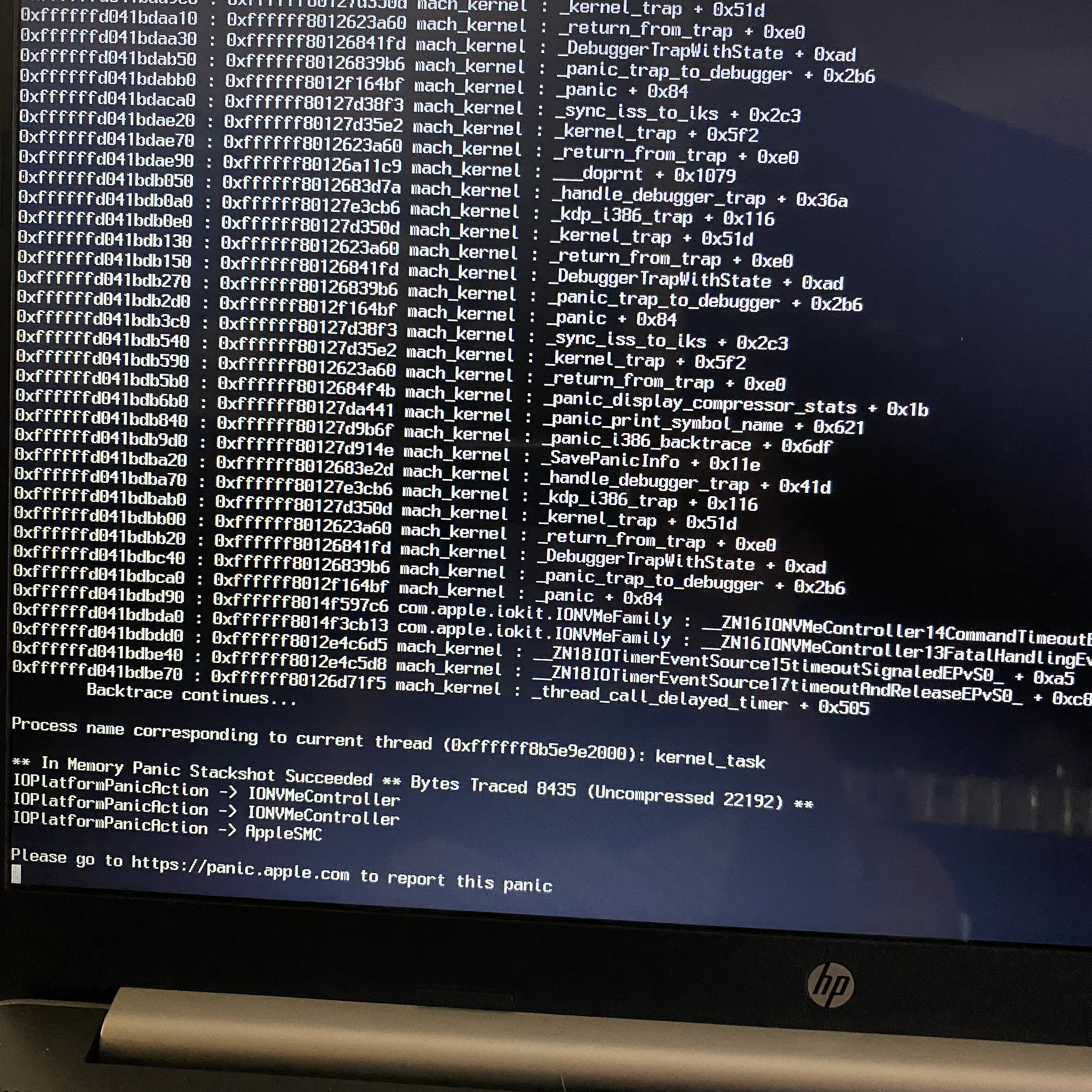

oronfel2911 Posted August 14, 2022 Author Share Posted August 14, 2022 Thanks @Baio77 I tired the EFI but stuck on this page. Link to comment https://www.insanelymac.com/forum/topic/352956-hp-i5-1035g1-dy1051wm/#findComment-2791428 Share on other sites More sharing options...

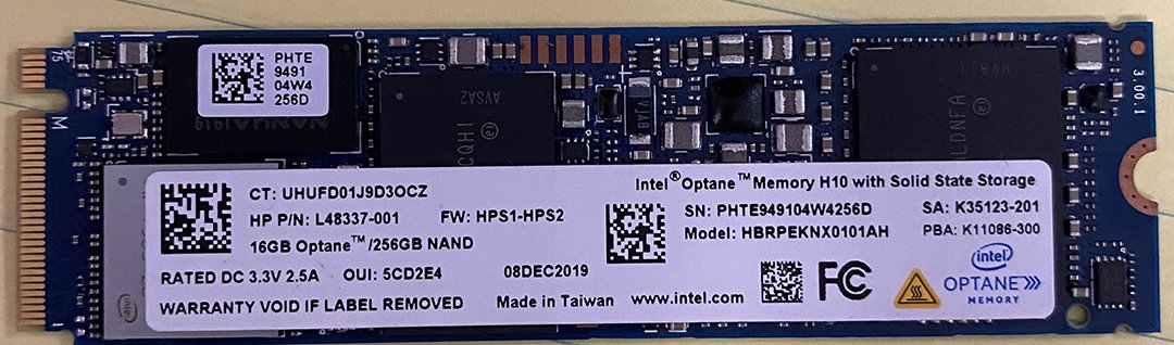

oronfel2911 Posted August 17, 2022 Author Share Posted August 17, 2022 Do you think my SSD cause the problem as i research and found out Intel Optane not supported ? Please advice attached image of SSD Installed in the laptop Link to comment https://www.insanelymac.com/forum/topic/352956-hp-i5-1035g1-dy1051wm/#findComment-2791580 Share on other sites More sharing options...
Slice Posted August 18, 2022 Share Posted August 18, 2022 The installation started so the SSD is working. Link to comment https://www.insanelymac.com/forum/topic/352956-hp-i5-1035g1-dy1051wm/#findComment-2791602 Share on other sites More sharing options...
