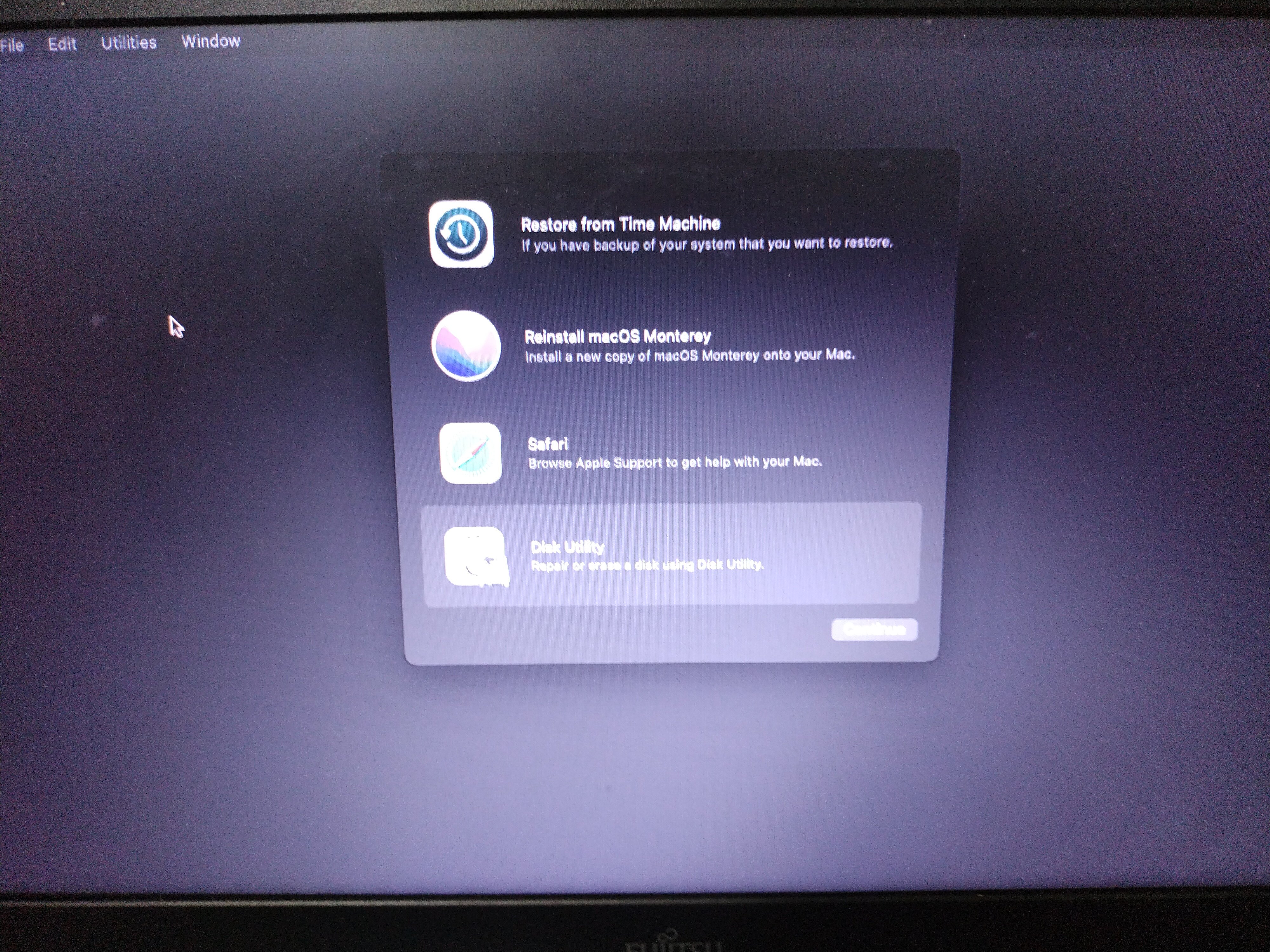

cherries Posted August 7, 2022 Author Share Posted August 7, 2022 UPDATE: I got into the installation menu! I had to use the -igfxvesa boot argument to get into the menu, however, so that means no GPU acceleration for me. Quote Link to comment Share on other sites More sharing options...

cherries Posted August 9, 2022 Author Share Posted August 9, 2022 4 hours ago, ricoc90 said: No, no worries. Just wanted to make sure. Could you try the following? EnableWriteUnprotector = False RebuildAppleMemoryMap = True SyncRuntimePermissions = True Firstly, an UPDATE: I got into the macOS installation menu with GPU acceleration, by using framebuffer-patch-enable and framebuffer-stolenmem Yes, I know, those two entries will limit myself from being able to use higher resolution and refresh rate than 1366x768 and 60Hz, but I never have a need for them, anyway. Everything worked out well, until when I added in the HorNDIS.kext kext. Somehow, when it's there, I cannot boot into macOS, nor get into the boot picker for some reason, because OpenCore would just show some logs, then boot straight into Windows after being stuck in a black screen for a while. But without the kext, I cannot use USB tethering Quote Link to comment Share on other sites More sharing options...
