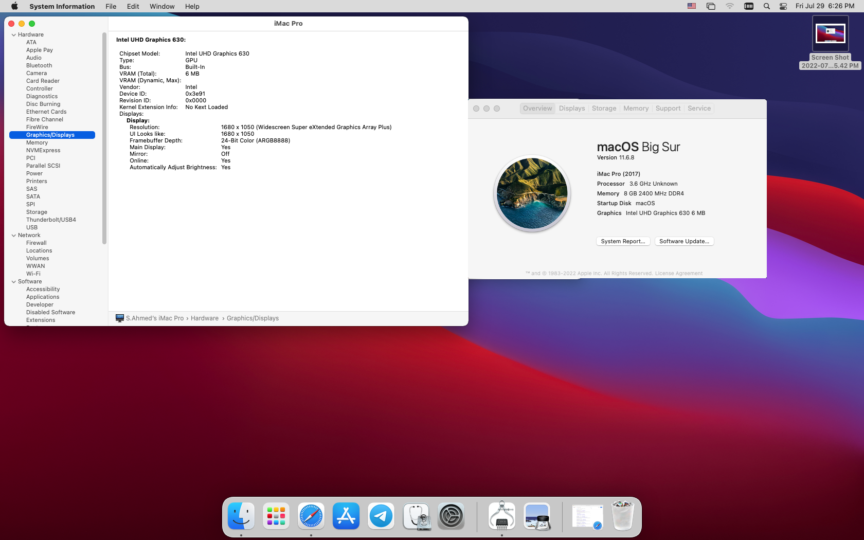

El-Matador Posted August 3, 2022 Share Posted August 3, 2022 Hello, I did everything by this tutorial, but my problem was not solved : Quote https://www.youtube.com/embed/4EU8oT0-Ea8 Please suggest an easy method, I am new in Hakintosh This is my OS : Ausu PRIME H310M-D R2.0 Intel(R) Core(TM) i3-8100 Intel(R) UHD Graphics 630 Ram 8 GB Quote Link to comment https://www.insanelymac.com/forum/topic/352840-problem-with-install-intelr-uhd-graphics-630-coffee-lake-on-bigsur/ Share on other sites More sharing options...

El-Matador Posted August 3, 2022 Author Share Posted August 3, 2022 26 minutes ago, miliuco said: Bienvenido @El-Matador. Give to us more information. What exactly is the problem? Lack of acceleration, iGPU bad detected, black screen...? Is it a laptop? What do you have in config.plist? Its a Desktop. My VGA is just 6MB. I followed all these instructions but the problem was not solved : Quote ACPI Renames COMMENT FIND REPLACE 1. Rename HECI to IMEI (PAVP) 48454349 494D4549 2. Rename MEI to IMEI (PAVP) 4D45495F 494D4549 Device Properties Devices Address = PciRoot(0x0)/Pci(0x2,0x0) KEY VALUE TYPE AAPL,ig-platform-id = 07009B3E DATA framebuffer-con0-busid = 05000000 DATA framebuffer-con0-enable = 01000000 DATA framebuffer-con0-flags = C7030000 DATA framebuffer-con0-index = 01000000 DATA framebuffer-con0-pipe = 12000000 DATA framebuffer-con0-type = 00040000 DATA framebuffer-con1-busid = 06000000 DATA framebuffer-con1-enable = 01000000 DATA framebuffer-con1-flags = C7030000 DATA framebuffer-con1-index = 02000000 DATA framebuffer-con1-pipe = 12000000 DATA framebuffer-con1-type = 00040000 DATA framebuffer-con2-busid = 04000000 DATA framebuffer-con2-enable = 01000000 DATA framebuffer-con2-flags = C7030000 DATA framebuffer-con2-index = 03000000 DATA framebuffer-con2-pipe = 12000000 DATA framebuffer-con2-type = 00080000 DATA framebuffer-con3-busid = 00000000 DATA framebuffer-con3-enable = 01000000 DATA framebuffer-con3-flags = 20000000 DATA framebuffer-con3-index = FFFFFFFF DATA framebuffer-con3-pipe = 00000000 DATA framebuffer-con3-type = 01000000 DATA framebuffer-patch-enable = 01000000 DATA This is my Config file and info from VGA : config.plist Quote Link to comment https://www.insanelymac.com/forum/topic/352840-problem-with-install-intelr-uhd-graphics-630-coffee-lake-on-bigsur/#findComment-2790702 Share on other sites More sharing options...
MaLd0n Posted August 4, 2022 Share Posted August 4, 2022 why u used these renames Quote 1. Rename HECI to IMEI (PAVP) 48454349 494D4549 2. Rename MEI to IMEI (PAVP) 4D45495F 494D4549 don't need, kext from acdt rename it for u 1 Quote Link to comment https://www.insanelymac.com/forum/topic/352840-problem-with-install-intelr-uhd-graphics-630-coffee-lake-on-bigsur/#findComment-2790708 Share on other sites More sharing options...
El-Matador Posted August 4, 2022 Author Share Posted August 4, 2022 17 hours ago, MaLd0n said: why u used these renames don't need, kext from acdt rename it for u aha I didn't know, I did according to the tutorial on YouTube, is it okay to delete this? Quote Link to comment https://www.insanelymac.com/forum/topic/352840-problem-with-install-intelr-uhd-graphics-630-coffee-lake-on-bigsur/#findComment-2790759 Share on other sites More sharing options...
El-Matador Posted August 4, 2022 Author Share Posted August 4, 2022 Just now, El-Matador said: aha I didn't know, I did according to the tutorial on YouTube, is it okay to delete this? I deleted these two lines, but the problem was not solved Quote Link to comment https://www.insanelymac.com/forum/topic/352840-problem-with-install-intelr-uhd-graphics-630-coffee-lake-on-bigsur/#findComment-2790761 Share on other sites More sharing options...
MaLd0n Posted August 4, 2022 Share Posted August 4, 2022 7 minutes ago, El-Matador said: I deleted these two lines, but the problem was not solved it's just advice not solution for ur video u can check HERE Quote Link to comment https://www.insanelymac.com/forum/topic/352840-problem-with-install-intelr-uhd-graphics-630-coffee-lake-on-bigsur/#findComment-2790762 Share on other sites More sharing options...
