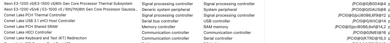

rafale77 Posted July 13, 2022 Share Posted July 13, 2022 I know this is possibly purely cosmetic but I am investigating for the sake of also learning. I have noticed on my Hack that the network interface menu has a PCI Serial adapter below: which I have traced back to come from the intel Keyboard and Text Redirect device: This device doesn't exist on a real iMac and by the way along with two other devices I would like to disable/hide from MacOS: The Gaussian Mixture model and the Thermal subsystem. (resp. GAUS and B0D4 above) I have tried to do this through SSDT by setting the _STA to zero either through name or method, none of which works. I have accessorily been successful at renaming them as you see. DefinitionBlock ("", "SSDT", 2, "Lenovo", "Disable", 0x00000000) { External (_SB_.PCI0, DeviceObj) External (_SB_.PCI0.B0D4, DeviceObj) External (_SB_.PCI0.GAUS, DeviceObj) External (_SB_.PCI0.KTRD, DeviceObj) Scope (\_SB.PCI0) { Scope (B0D4) { Method (_STA, 0, NotSerialized) // _STA: Status { If (_OSI ("Darwin")) { Return (Zero) } Else { Return (0x0F) } } } Scope (GAUS) { Method (_STA, 0, NotSerialized) // _STA: Status { If (_OSI ("Darwin")) { Return (Zero) } Else { Return (0x0F) } } } Scope (KTRD) { Method (_STA, 0, NotSerialized) // _STA: Status { If (_OSI ("Darwin")) { Return (Zero) } Else { Return (0x0F) } } } } } I am not super familiar with the language. Anyone could help me disable these 3 devices? These methods apparently work on child devices but not for PCIe bus devices? Link to comment https://www.insanelymac.com/forum/topic/352584-help-disabling-devices-at-the-pcie-bus-level/ Share on other sites More sharing options...

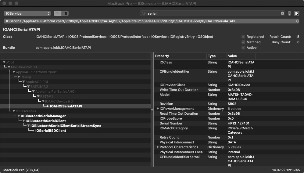

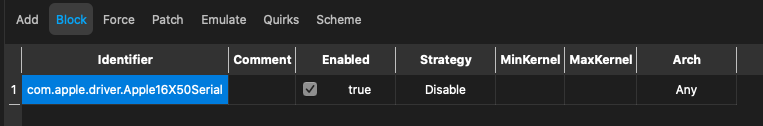

Guest 5T33Z0 Posted July 14, 2022 Share Posted July 14, 2022 (edited) @rafale77 Okay. I have this serial device in my Laptop as well. It uses Apple16X50.kext in S/L/E You could try to just block this kext from loading in OpenCore using the Kernel/Block feature. I've deleted the PCI Serial Adapter from Network Settings. macOS asked if it should show this adapter in the list again if it would be connected. I said "Yes" and saved the settings. After applying the block rule and rebooting, the device entry did not return yet and it's gone from IO Reg as well: Edited July 14, 2022 by 5T33Z0 Link to comment https://www.insanelymac.com/forum/topic/352584-help-disabling-devices-at-the-pcie-bus-level/#findComment-2788956 Share on other sites More sharing options...
