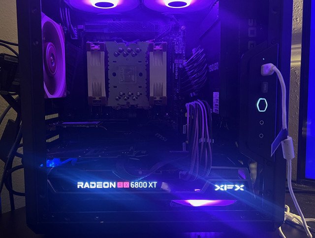

eye2eyespy Posted June 16, 2022 Share Posted June 16, 2022 Silly Question Maybe...How can I find out if my PCIE lanes which is 16 is running a full capacity?I have a TRX40 10G (3960X CPU) with 4 (16) PCIE lanes (support x16/x8/x16/x8 mode) because of my case and PSU I have to place the GPU on the last lane away from the CPU.Will this hurt performance. The motherboard says that all lanes run at 16??? Not really sure?Please advise. Quote Link to comment https://www.insanelymac.com/forum/topic/352229-xfx-6800-xt-pcie-lanes/ Share on other sites More sharing options...

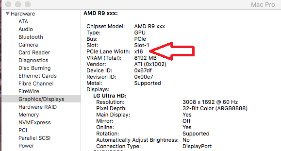

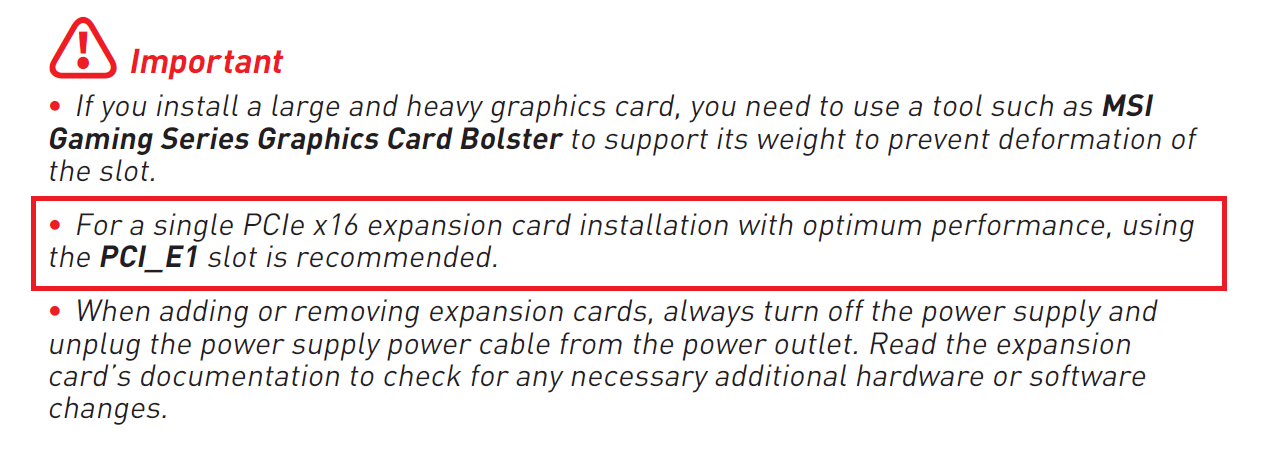

Allan Posted June 16, 2022 Share Posted June 16, 2022 Hello buddy! No, your question is not silly. We all are here to learn with each other 😉 This is what I've found at this Motherboard's manual. You can check if it's running at full speed in macOS at the System Report > Graphics/Displays: 3 Quote Link to comment https://www.insanelymac.com/forum/topic/352229-xfx-6800-xt-pcie-lanes/#findComment-2785890 Share on other sites More sharing options...
