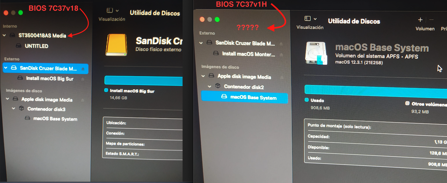

uzmi Posted May 15, 2022 Share Posted May 15, 2022 Hello everyone: I have an MSI x570 Gaming Edge Wifi motherboard and a Ryzen 3600x I have installed Monterey and it works fine with Bios 7C37v18. But when I update to the following bios it is impossible to install Monterey. I have already read that the new MSI and Monterey bios give problems. I updated the bios to the latest version 7C37v1H and tried Monterey and I have advanced further, so much that I have reached the installation screen. However here the problem arises: Utility disk Does not detect the hard disk where I must have it installed. Let's see if you can help me in case I miss something. Record. Image of Olarila with the corresponding and modified EFI folder for my team, THANK YOU MALDON! Download image 12.3.1 several times and also 12.3.0 in case there was any error when downloading it or when saving it to the usb I tried the installers with bios 7C37v18 and Disk Utility detects the hard disk perfectly. I tried a BIG SUR installer with bios 7C37v1H and disk utility sees the hard drive perfectly. I feel frustrated being so close and not being able to move forward Thank you very much for your time Config.plist.zip Link to comment Share on other sites More sharing options...

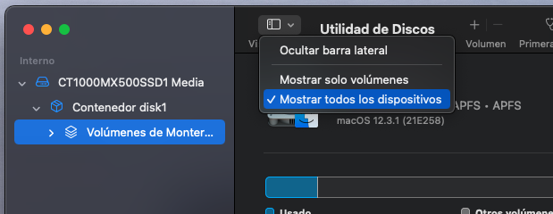

Allan Posted May 15, 2022 Share Posted May 15, 2022 Double check if at the Disk Utility > Visualization menu, the option to "see" all the disks are enabled? 1 Link to comment Share on other sites More sharing options...
uzmi Posted May 15, 2022 Author Share Posted May 15, 2022 you say this? then yes Link to comment Share on other sites More sharing options...

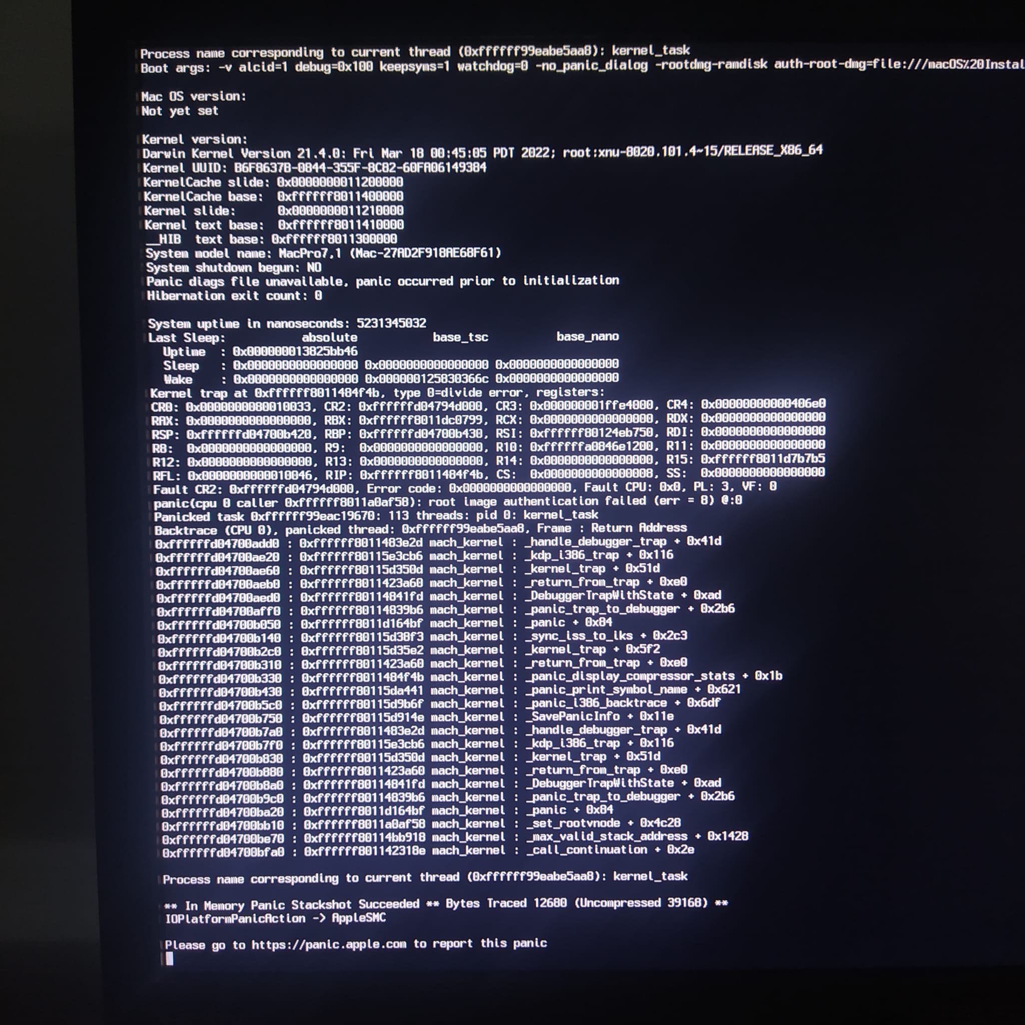

uzmi Posted May 19, 2022 Author Share Posted May 19, 2022 (edited) Bad news Disk utility also does not detect the NVMe But... I have discovered that the problem is that it doesn't "see" neither NVMe nor sata1 (I don't think sata2 either, I haven't tried it) but sata3 does work Windows does detect everything but the Monterey installer doesn’t. I've been trying different config.plist for several days, it lets me install (sata 3 works) but after the first reboot to finish installing, it stays in an infinite loop that never ends. Now it gives me a KP. I don't know what else should I try. P.S. I'm not going to try anymore. Thank you for your time Edited May 20, 2022 by uzmi Link to comment Share on other sites More sharing options...
