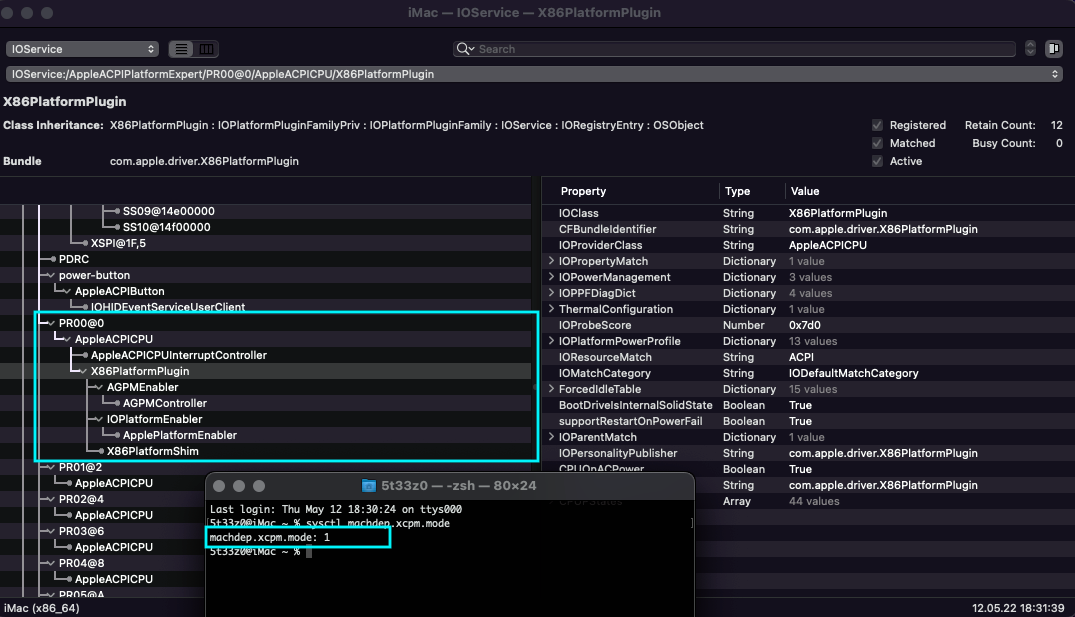

Guest 5T33Z0 Posted May 12, 2022 Share Posted May 12, 2022 (edited) That's interesting. I never tested this. I will check it out and report back. What are your system specs? EDIT: I can confirm that on my 10th Gen Core i9, I don't need SSDT-PLUG under macOS Monterey 12.4 In macOS Big Sur it's still required. I think having a Min Kernel/ Max Kernel feature for ACPI tables would be a nice to have feature now. But thinking abut it, I guess that's impossible, since ACPI works on a lower level. Edited May 12, 2022 by 5T33Z0 Link to comment https://www.insanelymac.com/forum/topic/351675-macos-123-monterey-x86platformplugin-without-plugin-type1/#findComment-2782160 Share on other sites More sharing options...

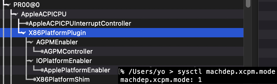

miliuco Posted May 12, 2022 Share Posted May 12, 2022 Same here. SSDT-PLUG disabled in config.plist. Thanks @aben for the information that I was completely unaware of. Spoiler 2 Link to comment https://www.insanelymac.com/forum/topic/351675-macos-123-monterey-x86platformplugin-without-plugin-type1/#findComment-2782173 Share on other sites More sharing options...

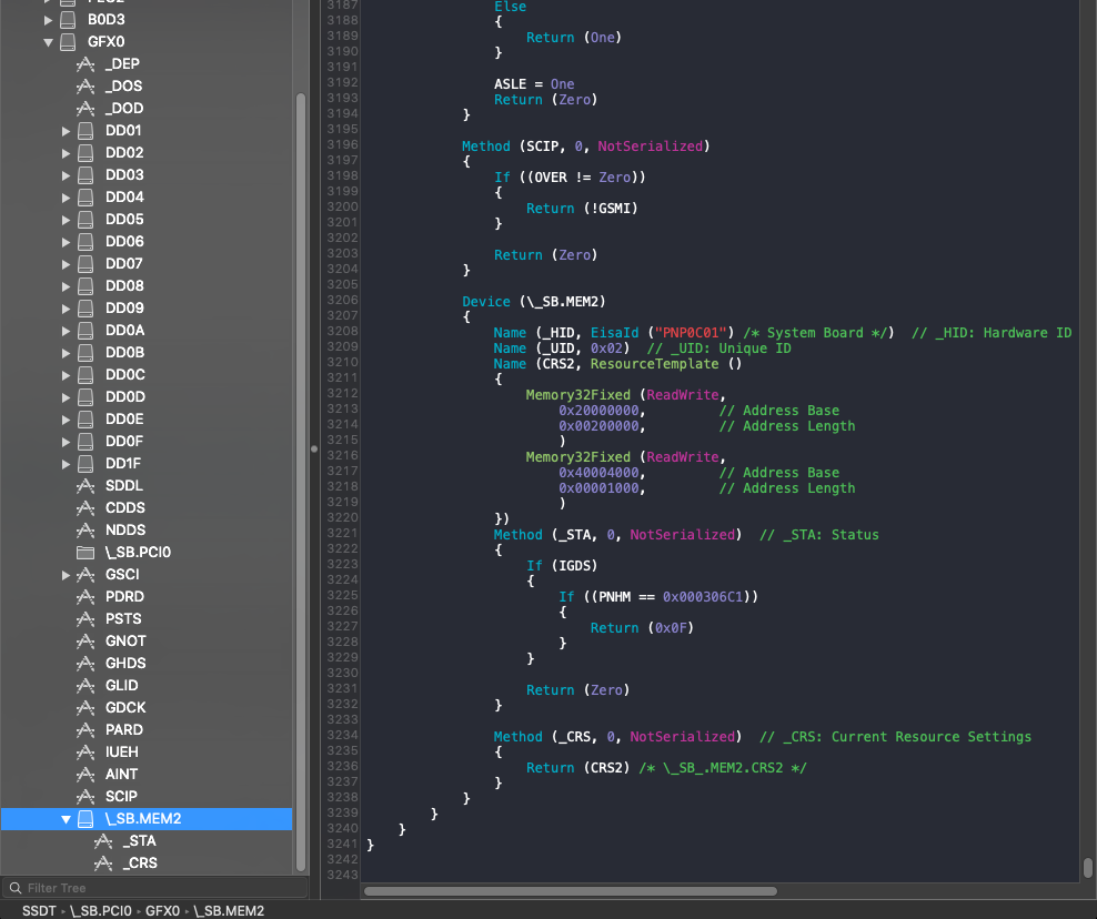

hardcorehenry Posted August 12, 2022 Share Posted August 12, 2022 (edited) On 5/14/2022 at 6:10 AM, aben said: there also shouldn't be an issue with adding a SSDT to inject a device like MEM2 for eg, which is found in ACPI tables of real Macs but has no functional benefit for a hackintosh except for cosmetic purposes About that, MEM2 doesn’t seem to be some exotic device only present in Mac, in my AsusH81M-E there is native MEM2 in OEM ACPI(SSDT-SaSsdt precisely), but it doesn’t appear in IOReg because _STA needs some conditions(very easy to make little SSDT-hot-patch to enable it, though). Unfortunately I also don’t know a purpose of this device and if it’s worth/safe enabling it. Spoiler Edited August 12, 2022 by hardcorehenry 1 Link to comment https://www.insanelymac.com/forum/topic/351675-macos-123-monterey-x86platformplugin-without-plugin-type1/#findComment-2791293 Share on other sites More sharing options...
