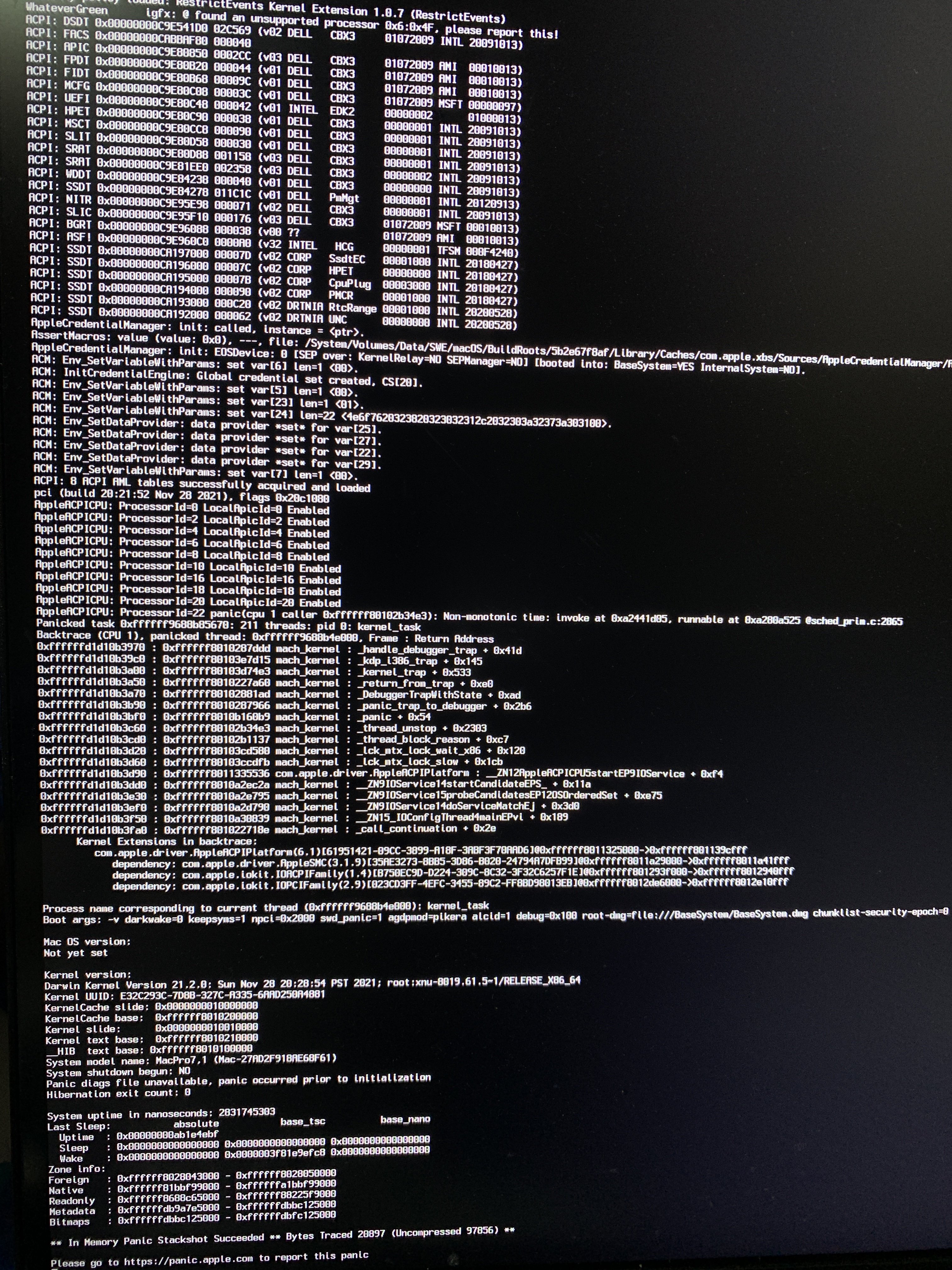

Zuja4701 Posted April 16, 2022 Share Posted April 16, 2022 Currently I'm running Big Sur 11.6.5 without any problem. I tried to fresh install Monterey 12.3 (with opencore 0.80), but it is unsuccessfully. I followed the Dortania's Guide for Broadwell-E (using MacPro7,1), all got the same panic in the following pictures. I also tried to use many methods included the booter and kernel patches, but there is no luck. Any help is appreciated. Thank you! My hardware is a DELL Precision Tower 7910: - CPU: Intel Xeon E5-2699V4 - GPU: AMD Radeon RX5700XT - RAM: 256GB ECC Samsung DDR4 2133Mhz - Motherboard: X99 - Wifi: Broadcom BCM4366 EFI-080-Dell-T7910-E5-2699v4.zip Quote Link to comment https://www.insanelymac.com/forum/topic/351465-need-help-installing-monterey-on-dell-precision-tower-7910/ Share on other sites More sharing options...
Slice Posted April 16, 2022 Share Posted April 16, 2022 The panic is about bad DSDT. It may be good in sense of Windows but not good for macOS. I may to propose use Clover with automatic DSDT fixes ability. Quote Link to comment https://www.insanelymac.com/forum/topic/351465-need-help-installing-monterey-on-dell-precision-tower-7910/#findComment-2780354 Share on other sites More sharing options...
Zuja4701 Posted April 16, 2022 Author Share Posted April 16, 2022 57 minutes ago, Slice said: The panic is about bad DSDT. It may be good in sense of Windows but not good for macOS. I may to propose use Clover with automatic DSDT fixes ability. Thank you for your suggestion! But it works well with BigSur. I will try to use clover to export DSDT. Quote Link to comment https://www.insanelymac.com/forum/topic/351465-need-help-installing-monterey-on-dell-precision-tower-7910/#findComment-2780357 Share on other sites More sharing options...
Úll Mac Posted April 29, 2022 Share Posted April 29, 2022 May be related to cputscsync.kext / voodootscsync Try booting with cpus=1 , may allow install Quote Link to comment https://www.insanelymac.com/forum/topic/351465-need-help-installing-monterey-on-dell-precision-tower-7910/#findComment-2781327 Share on other sites More sharing options...

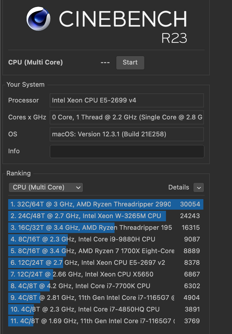

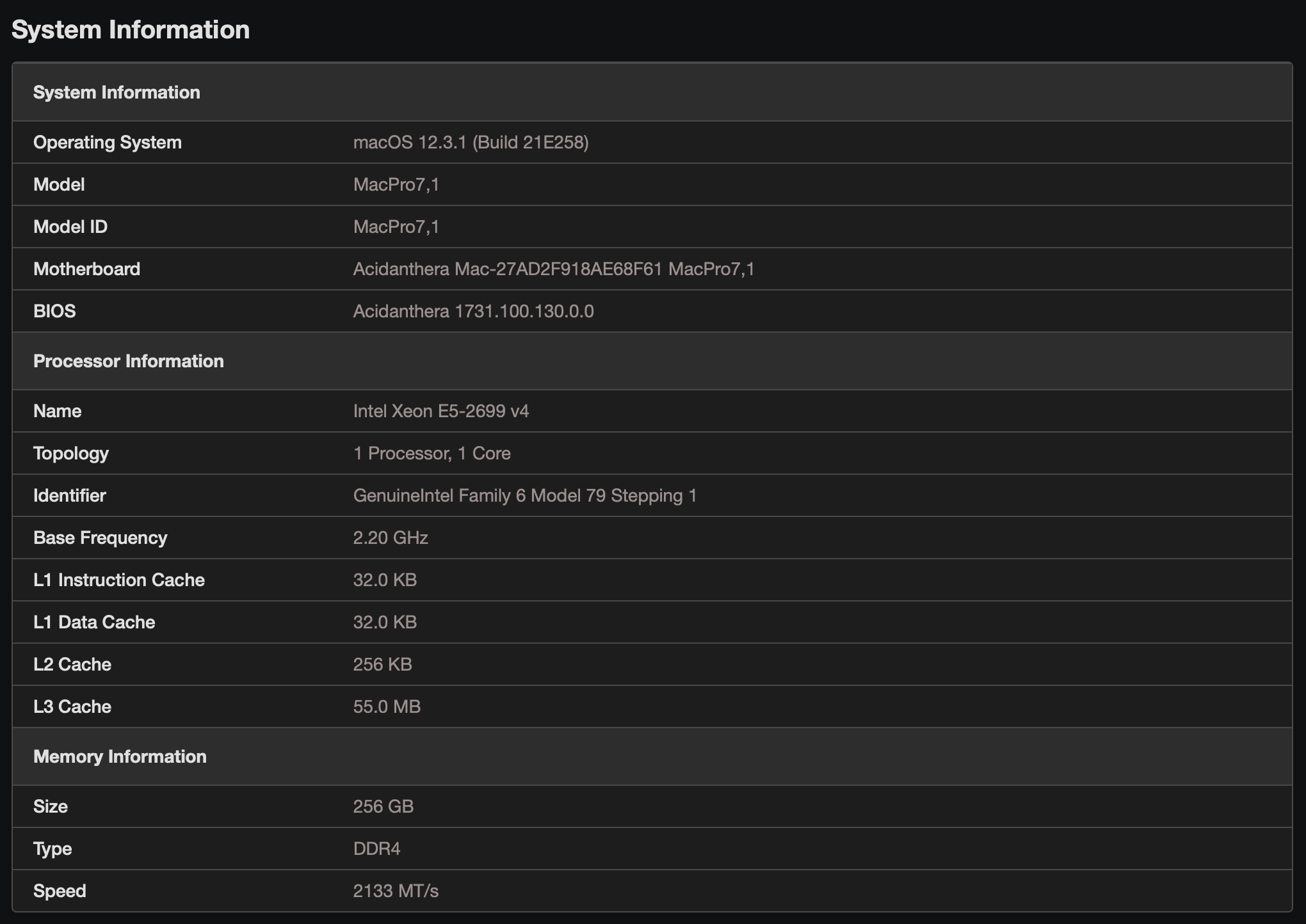

Zuja4701 Posted May 23, 2022 Author Share Posted May 23, 2022 On 4/30/2022 at 1:01 AM, Úll Mac said: May be related to cputscsync.kext / voodootscsync Try booting with cpus=1 , may allow install Hi UII Mac, Thank you for your suggestion. I have successfully installed Monterey with cpus=1. When I can boot with cpus=1, but only have one cpu and thread active (see in attach photos). Is there any suggestion to get full cpu working? Thank you! Quote Link to comment https://www.insanelymac.com/forum/topic/351465-need-help-installing-monterey-on-dell-precision-tower-7910/#findComment-2782709 Share on other sites More sharing options...
