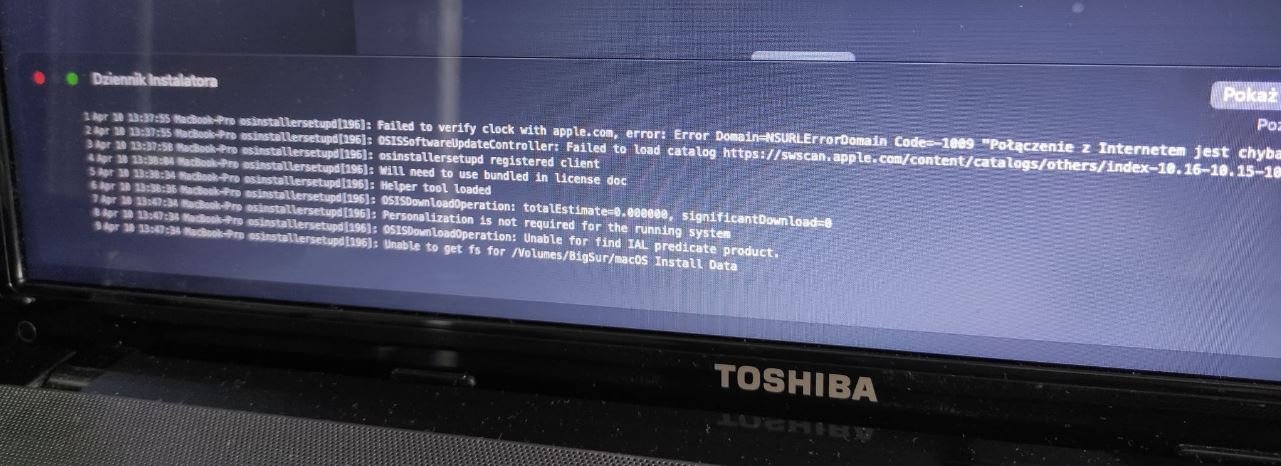

zydoslav Posted April 10, 2022 Author Share Posted April 10, 2022 (edited) @aben I have managed to boot Big Sur installer (version 11.1) from clover. One thing was wrong - clover version! In latest version (r5146) the installer is not booting. I have read your suggestion about the kernel panic for catalina installer, then I have installed latest clover version for big sur I've found (r5132) and the installer just boots to it's GUI with your EFI for clover from previous post, after changing SMBIOS to 11,1. Thanks for that I can start the Big Sur installation, but when 12 mins are remaining its showing a log "SERVICE EXITED DUE TO SIGKILL", then some exiting logs appear and the computer reboots. What can be the problem this time? In the installer log, before the system crashes there is something like: personalization is not required to install this system unable to get fs for 'big sur volume name' install data @5T33Z0 maybe you have any idea why the install crashes this way? I have tried again, attaching logs Edited April 10, 2022 by zydoslav Link to comment https://www.insanelymac.com/forum/topic/351326-which-macos-for-toshiba-l875-s7108/page/2/#findComment-2779710 Share on other sites More sharing options...
Guest 5T33Z0 Posted April 10, 2022 Share Posted April 10, 2022 (edited) I can't tell from the screenshots. Looks like the disk (SSD or HDD?) may be formatted incorrectly. Please upload a preboot log. Press F2 in the Clover GUI. The log will be stored under EFI/CLOVER/misc/ Edited April 10, 2022 by 5T33Z0 Link to comment https://www.insanelymac.com/forum/topic/351326-which-macos-for-toshiba-l875-s7108/page/2/#findComment-2779731 Share on other sites More sharing options...
aben Posted April 10, 2022 Share Posted April 10, 2022 (edited) From what I could gather, this appears to be a known issue seen when trying to install Big Sur onto hardware that is not actually compatible with Big Sur (Apparently due to missing NVRAM checks by installer). Unfortunately there doesn’t seem to be any official go-to solution per-se to tackle this particular issue other than: Allow the system to pass a few reboots to try and complete the installation of Big Sur. Install Big Sur onto partition externally via a machine that has hardware natively compatible with Big Sur. Try upgrade directly from macOS Catalina which is the final macOS version officially supported by Apple for Ivy-Bridge platforms. I’ll anyways test Big Sur on my machine as well and see if I can figure out a workaround. @zydoslav My apologies for any confusion caused but I actually never completed testing of Big Sur installation on my machine the other day, I only discovered the SMBIOS requirement part to enable the volume selection on installer GUI. Given the situation we're at, I would still suggest you install macOS Catalina with the help of OpenCore EFI I attached earlier. I believe this is the better approach at this point. Edited April 10, 2022 by aben Link to comment https://www.insanelymac.com/forum/topic/351326-which-macos-for-toshiba-l875-s7108/page/2/#findComment-2779734 Share on other sites More sharing options...

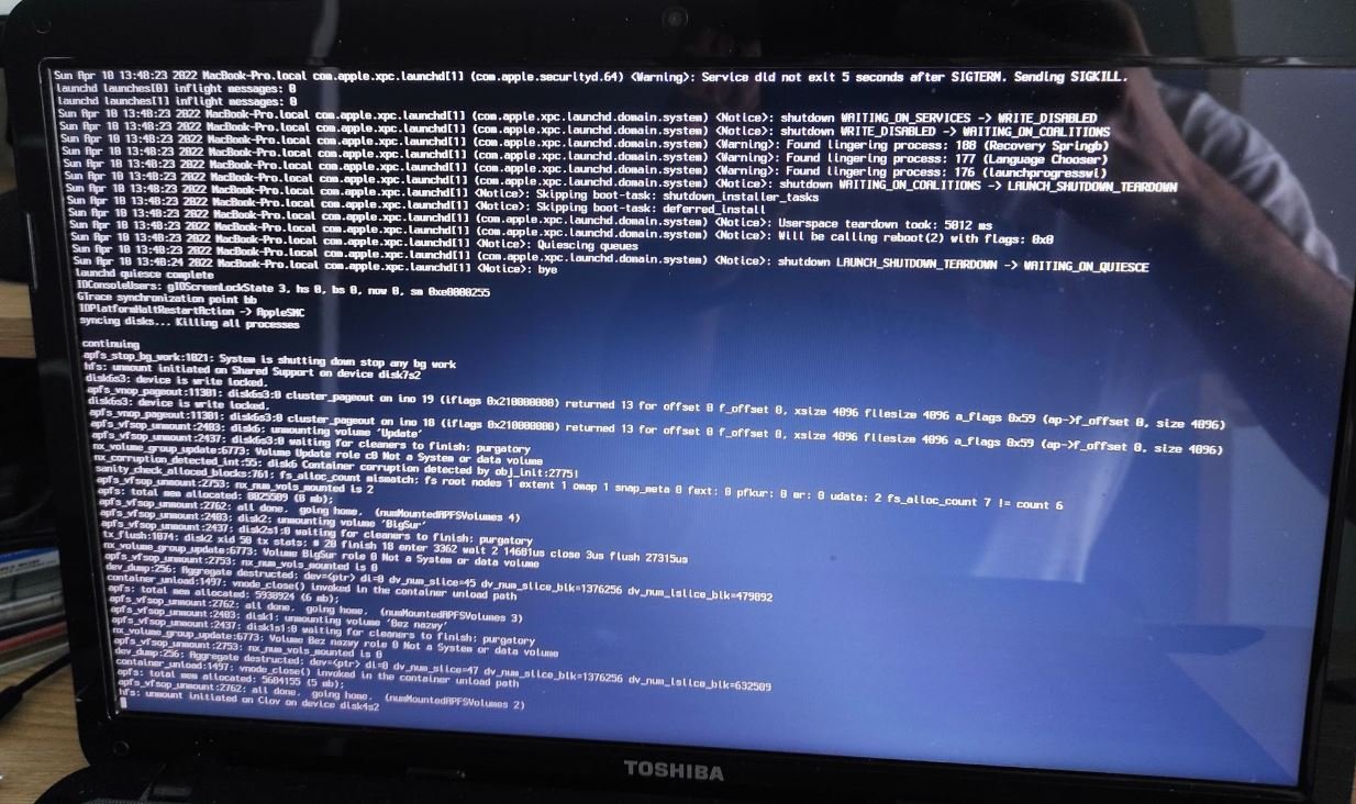

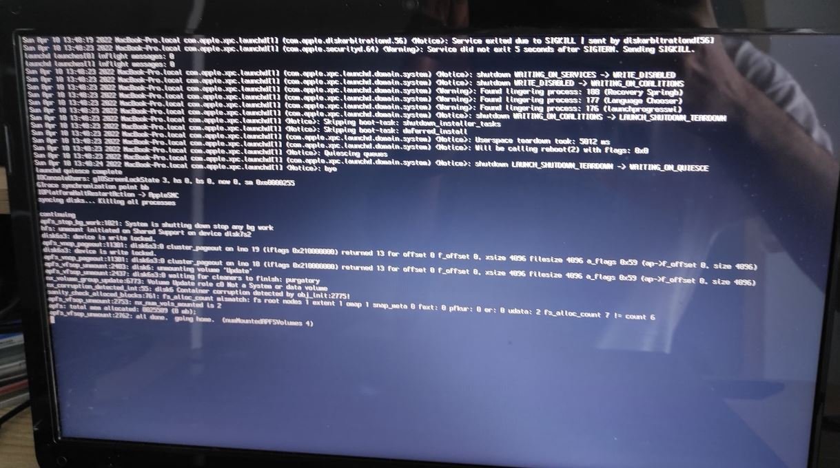

aben Posted April 10, 2022 Share Posted April 10, 2022 (edited) @zydoslav Just tested installation of Big Sur on my Toshiba L850 and just like you described, at 12 minutes was shown the same verbose output indicating the "SERVICE EXITED DUE TO SIGKILL" log however this appears to be normal behavior, can confirm its a non-issue. System automatically rebooted, continued with the installation process as usual, completing it successfully within 23 mins. Note: I used OpenCore for the test. Attaching Big Sur compatible EFI incase you wish to try. EFI.zip Edited April 10, 2022 by aben Attach EFI 1 Link to comment https://www.insanelymac.com/forum/topic/351326-which-macos-for-toshiba-l875-s7108/page/2/#findComment-2779739 Share on other sites More sharing options...
zydoslav Posted April 10, 2022 Author Share Posted April 10, 2022 (edited) @aben your tips are very helpful. I have installed Catalina on an external drive and it looks like the installation is OK - you are right "SERVICE EXITED DUE TO SIGKILL" looks like a normal situation here. It also occured when I tried to install big sur, but after reboot I could only start installation again. In Catalina case I could boot macOS from my disk to finish installation. On first run I had a 'sip is off, allowing core dump for pid xxx' infinite loop, but I have added a boot parameter 'amfi_get_out_of_my_way=1' nad now Catalina boots. I am on first config screen right now. What do you suggest to do after installing Catalina? Any post-install steps to make it work good? I will try to upgrade it to big sur next days, and if It will not work I will try to install big sur with your approach from opencore. I can see that ethernet controller is not working, wifi also is not working Can I make them working when Catalina install is completed? edit: copied kexts to Library/Extensions on installation drives, installed them through terminal and when I rebooted I have a kernel panic 'panic diag file unavailable, panic occured prior to initialization' haha which post install steps I should take to avoid later problems with booting? Edited April 10, 2022 by zydoslav Link to comment https://www.insanelymac.com/forum/topic/351326-which-macos-for-toshiba-l875-s7108/page/2/#findComment-2779743 Share on other sites More sharing options...

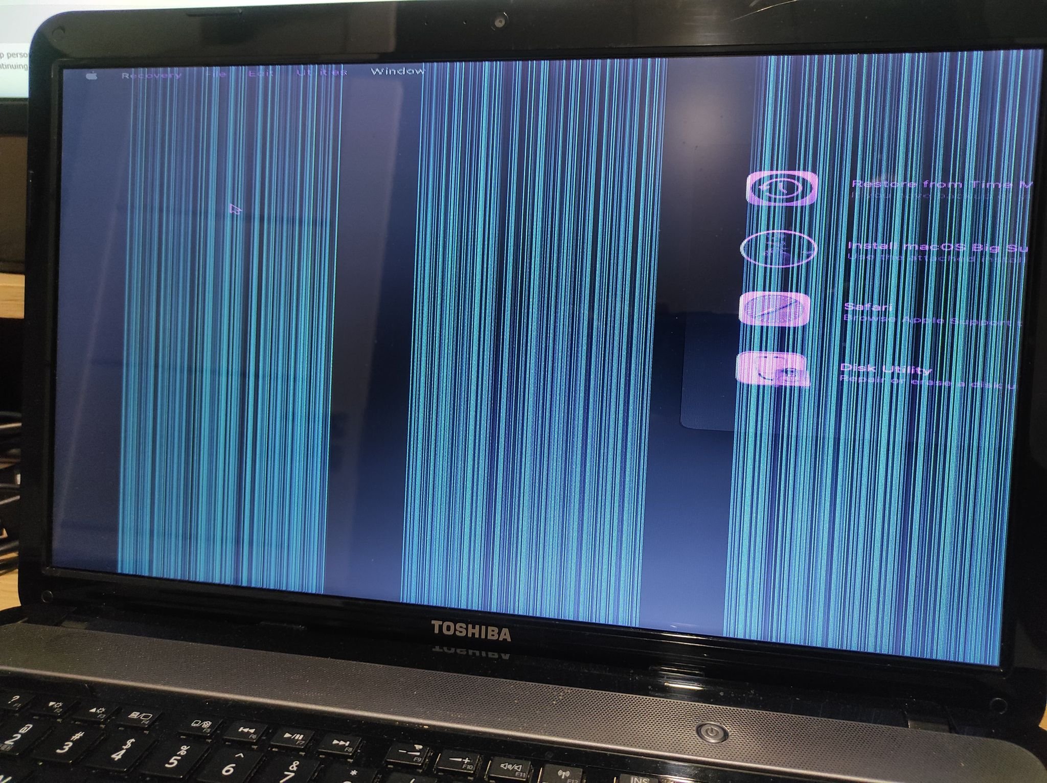

zydoslav Posted April 14, 2022 Author Share Posted April 14, 2022 @aben today I have tried your approach with opencore (big sur installation). I can boot to the installer, install goes through the first phase, but then it reboots and I can only boot the installer again and start install from the begginning. There is also a screen problem - attached a photo, do you know how to solve this? Link to comment https://www.insanelymac.com/forum/topic/351326-which-macos-for-toshiba-l875-s7108/page/2/#findComment-2780216 Share on other sites More sharing options...
aben Posted April 15, 2022 Share Posted April 15, 2022 (edited) Hmm...looks like it's a possible EDID problem. My model too has washed out screen problems for which I'm required to inject a custom EDID patch (thanks to findings by a guru who worked on the same L850 model at AppleLife.ru almost a decade ago) however as far as I'm aware this issue was only seen on the AMD equipped GPU models, but maybe even others are affected. You may try with the custom EDID patch I use on my model although I'm a bit skeptical it may not be compatible since you have a 17inch compared to 15inch. Just to rule out other possibilities, I have uploaded two EFI folder below, one with the custom EDID patch and one without IMEI SSDT. Give both a try. As for the Big Sur install issues, may I safely assume that you are trying to install Big Sur onto an external drive connected via USB? If so, this could be a possible limitation with either Big Sur install or non-Apple hardware. I would suggest you try creating a small HFS+ partition with size of 17 GB at the end of the internal drive and use that HFS+ partition to create Big Sur install media. Boot OpenCore via USB stick and use that internal install media to install Big Sur onto the same drive. This is the approach I used for testing Big Sur install. EFI-custom_EDID.zip EFI-no_IMEI.zip Edited April 15, 2022 by aben Link to comment https://www.insanelymac.com/forum/topic/351326-which-macos-for-toshiba-l875-s7108/page/2/#findComment-2780240 Share on other sites More sharing options...

zydoslav Posted April 15, 2022 Author Share Posted April 15, 2022 (edited) @aben the problem remains I have tried to modify config.plist regarding to https://dortania.github.io/OpenCore-Post-Install/gpu-patching/intel-patching/connector.html but no success (I have added framebuffer-con1-type = 02000000). Big Sur is booting, but still damaged display. On Catalina with Clover video card worked perfectly @5T33Z0 maybe you know how to fix this problem? Edited April 15, 2022 by zydoslav Link to comment https://www.insanelymac.com/forum/topic/351326-which-macos-for-toshiba-l875-s7108/page/2/#findComment-2780292 Share on other sites More sharing options...
aben Posted April 15, 2022 Share Posted April 15, 2022 @zydoslav Only two possibilities I can think of: Either one or more of CLOVER's many DSDT patch is somehow fixing your display issue and/or Catalina's display driver is more suited for your display. Only way to confirm is by looking at an IOREG extract from both Catalina booted from CLOVER and Big Sur from OpenCore haha. Since you have Big Sur already installed, I propose you try boot using same CLOVER config. This should help narrow down the culprit. 1 Link to comment https://www.insanelymac.com/forum/topic/351326-which-macos-for-toshiba-l875-s7108/page/2/#findComment-2780319 Share on other sites More sharing options...

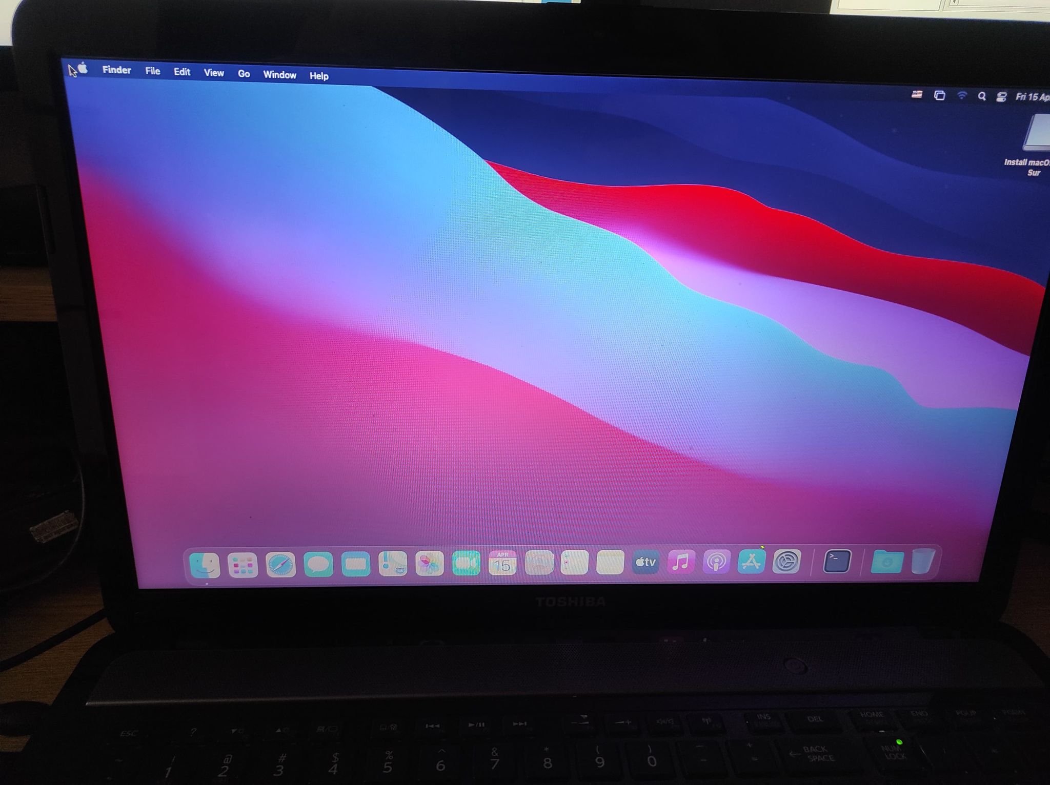

zydoslav Posted April 15, 2022 Author Share Posted April 15, 2022 (edited) @aben Clover is seeing only the recovery partition (it boots without graphic problems). I can't boot big sur with clover (don't know why). I have done a deep research, including documentation of whatevergreen kext and there was a problem with framebuffer. I have change AAPL,ig-platform-id regarding to https://github.com/acidanthera/WhateverGreen/blob/master/Manual/FAQ.IntelHD.en.md and... it worked! Display is repaired Now I have to somehow handle some problems I have noticed at first look: - not working touchpad, (this is a problem, on catalina it worked with kexts attached to your EFI, on BigSur touchpad is not working and I don't know that to do with this issue.) - not working ethernet, (WORKING with RealtekRTL8100.kext) - not working wifi (I'll try to make it work via wifi usb dongle) THANK YOU @aben!!! Edited April 15, 2022 by zydoslav 1 Link to comment https://www.insanelymac.com/forum/topic/351326-which-macos-for-toshiba-l875-s7108/page/2/#findComment-2780323 Share on other sites More sharing options...
aben Posted April 16, 2022 Share Posted April 16, 2022 (edited) @zydoslav Ahh makes sense. Looks like I overlooked the correct framebuffer value required for mobile Ivy-Bridge's AAPL,ig-platform-id property since my model don't require iGPU framebuffer patching 😅 sorry about that! However good to finally see Big Sur running great on your Toshiba Glad I was able to provide some assistance. With regards to the trackpad, I see no reason why there would be any difference between our models since it worked for me on Big Sur using the same ApplePS2SmartTouchPad.kext I shared with you. I have to mention, this kext was actually modified/configured to better suit our keyboard function/shortcut keys like brightness, volume etc however if you are still facing issues I would suggest you first try combo Fn key + F5 on your keyboard, this shortcut enables/disables trackpad on our Toshiba models, maybe this will help resolve the issue. If not, the only solution left would be to use Acidanthera's VoodooPS2 and its trackpad plugins however I'm afraid you will probably lose out on the original keyboard shortcuts for which you may have to do some research and find a way to manually map these keys, if its a deal breaker for you. Edited April 16, 2022 by aben Link to comment https://www.insanelymac.com/forum/topic/351326-which-macos-for-toshiba-l875-s7108/page/2/#findComment-2780373 Share on other sites More sharing options...
