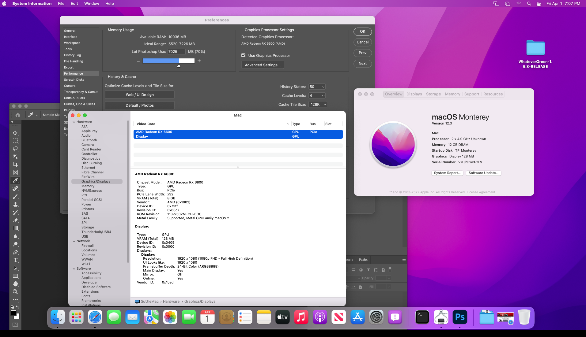

installdemo Posted April 1, 2022 Share Posted April 1, 2022 The 'twist' is that it's running on top of ESXi with GPU Passthru with no loaders and no kext. And Photoshop sees and can use the GPU. Whatever your Hackintosh plans; Don't give up! I didn't. 1 Quote Link to comment https://www.insanelymac.com/forum/topic/351320-monterey-with-radeon-rx-6600-with-a-twist/ Share on other sites More sharing options...
etorix Posted April 2, 2022 Share Posted April 2, 2022 Contrary to RX 5500-5700 and 6800-6900, RX 660 were reportedly not affected by the graphic issues in 12.3. What is the purpose of running macOS on top of ESXi rather than bare metal? Are you running another OS in parallel? Quote Link to comment https://www.insanelymac.com/forum/topic/351320-monterey-with-radeon-rx-6600-with-a-twist/#findComment-2779277 Share on other sites More sharing options...

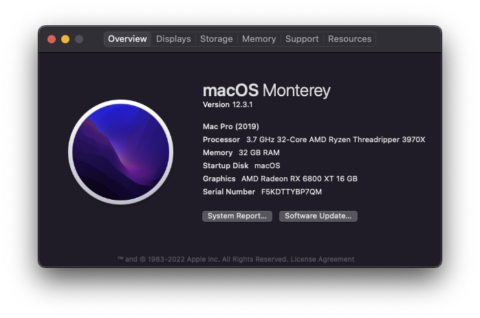

Pavo Posted April 3, 2022 Share Posted April 3, 2022 (edited) 10 hours ago, etorix said: Which is good to know. But using a hypervisior comes with overhead, restriction to hardware that is supported by the hypervisor (quite a stringent matter with respect to passthrough…), and the whole point of a hypervisor is normally to run multiple OS in parallel. So curious minds would like to know more about the use case. The overhead is less than 1% and not noticeable by the user. Restrictions are only the ones that are on macOS in bare metal as well. Its actually better to run macOS as a VM on AMD hardware since it doesn't require any kernel patches as it does on bare metal on AMD hardware. I run macOS as a VM on my AMD Threadripper system and it works flawless with GPU, Wifi/BT, NVMe and USB Controllers passed through, but I use Linux host OS and KVM+Qemu instead of ESXi which still requires a boot loader such as OpenCore or Clover. Edited April 3, 2022 by Pavo 1 Quote Link to comment https://www.insanelymac.com/forum/topic/351320-monterey-with-radeon-rx-6600-with-a-twist/#findComment-2779350 Share on other sites More sharing options...
