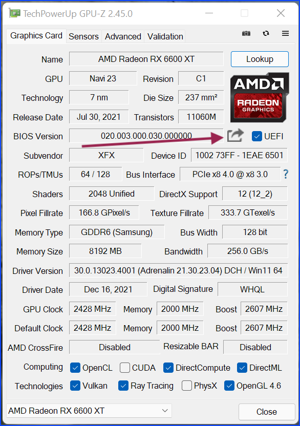

GPU-Z loads the GPU specifications and allows you to export everything to a file with ROM extension.
To export (Graphics Card tab) use the arrow icon that comes out of a rectangle below the AMD Radeon logo, to the right of the text box with the BIOS version

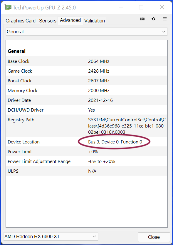

In the Advanced tab you have to write down the Bus number in the DeviceLocation key, this number (on my system it is 3) is important later, when looking for the SPPT key in the Windows registry.

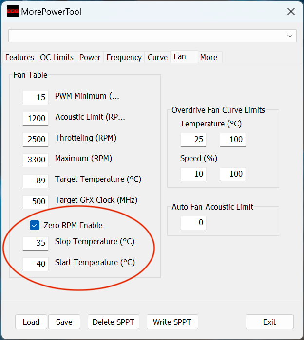

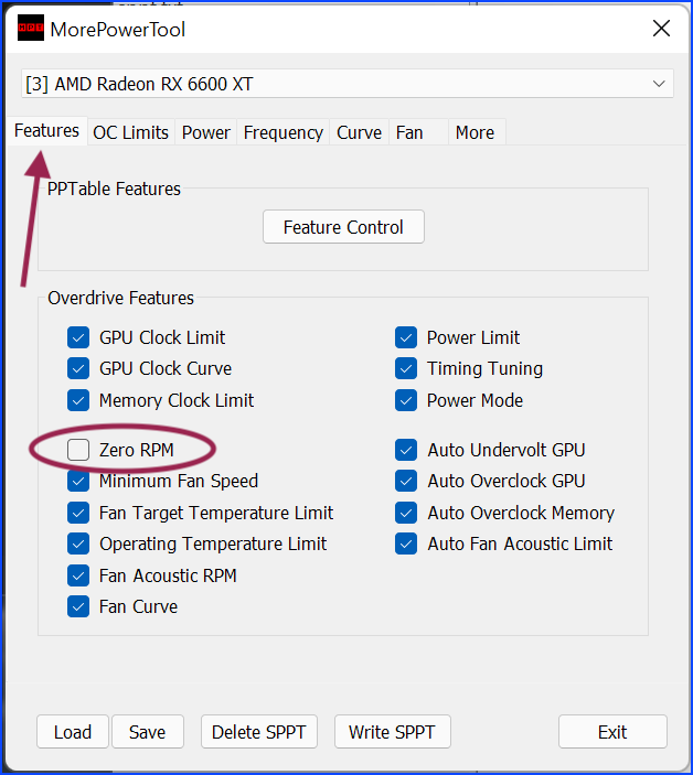

MPT is where the task of generating the SPPT key with Zero RPM disabled is performed.
  • At the top, choose the GPU model you have installed; it usually shows the bus number (noted above) at the beginning of the name (3 in this case).
  • It is advisable to delete the table that may already exist in the registry from the Delete SPPT button.
  • Load the ROM file generated with GPU-Z (Load button).

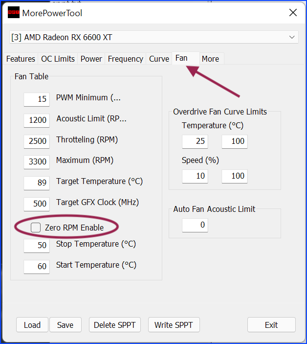

  • Modify the Zero RPM option by unchecking the checkbox in 2 tabs: Features and Fan.

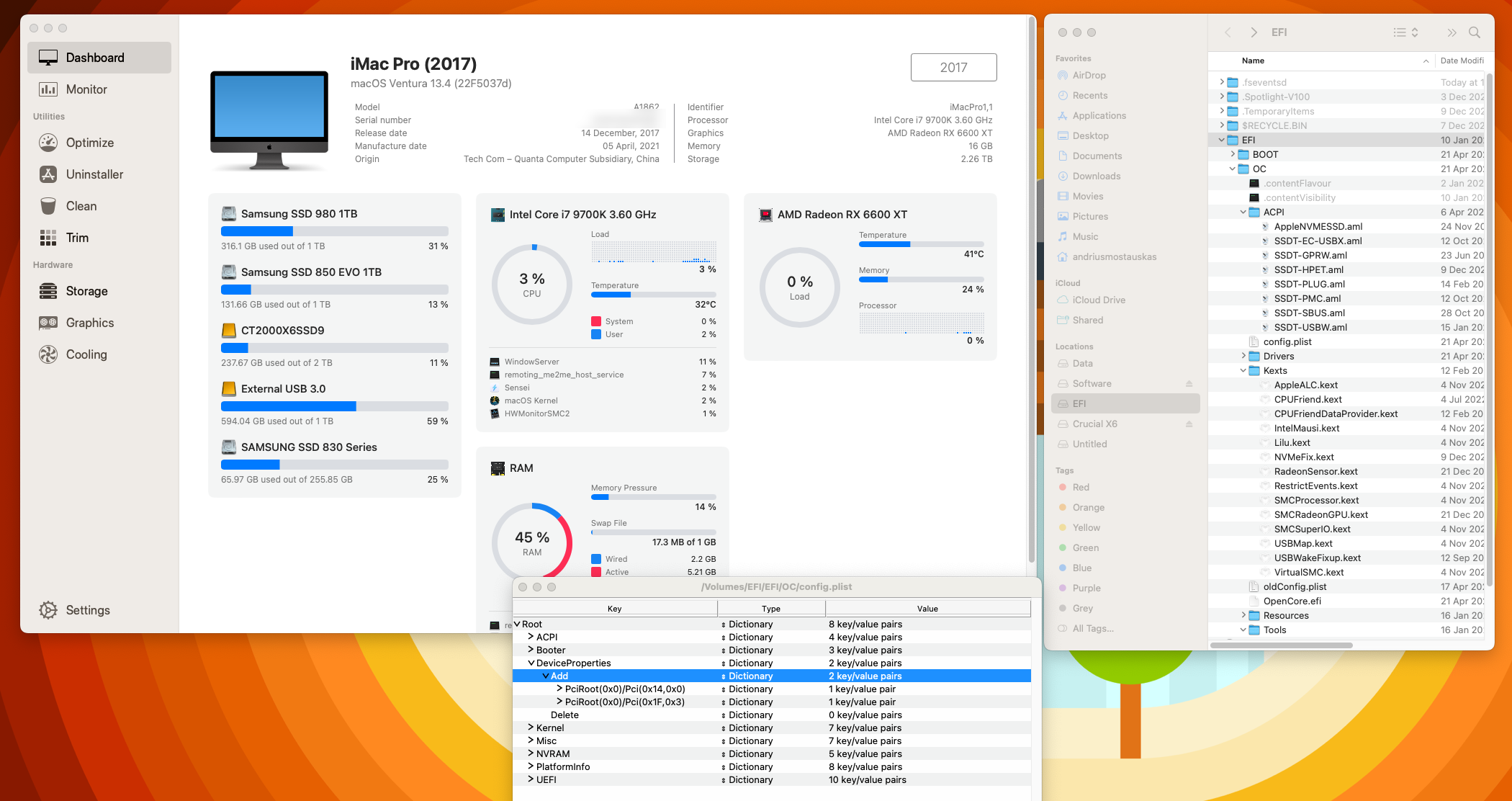

For better identification of the SSDT, rename it to SSDT-SPPT.aml and don't forget to compile it to AML format. When you compile the DSL file to AML, the compiler formats text, fills buffer sizes and adds header with comments.
Place SSDT-SPPT.aml in the APCI folder and in config.plist, restart and reload OpenCore.

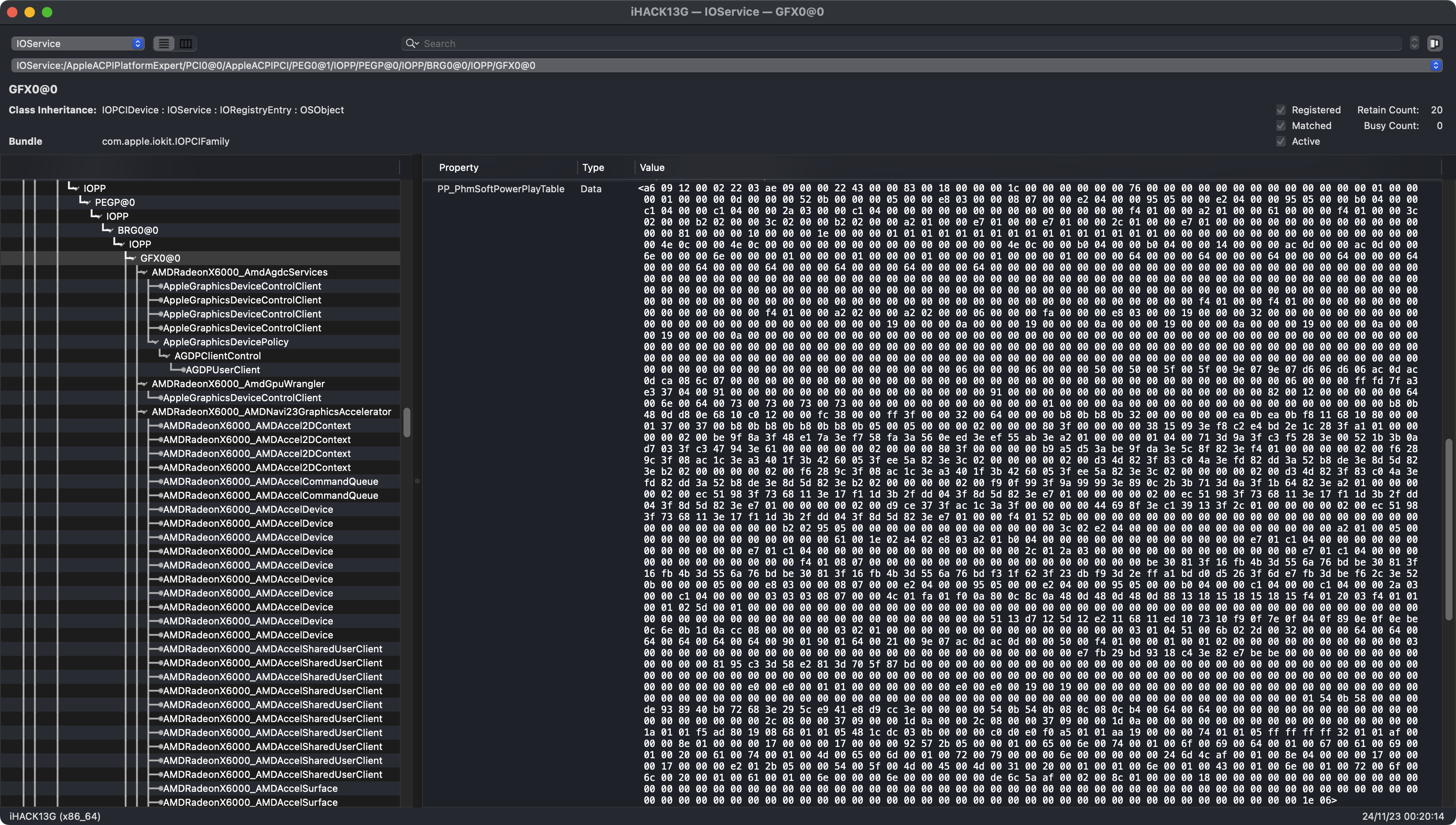

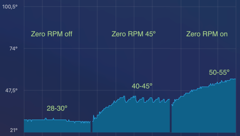

Check that the SSDT loads correctly
To see if everything is right, run IORegistryExplorer and compare what you see with this image (PP_PhmSoftPowerPlayTable is one of the properties of GFX0 or whatever the graphics device is called on your system):
If you have added SPPT string with modified Zero RPM, you must see the changes in GPU temperatures and fans spin. In the image there is 3 conditions, graphics made when there is not high demand:
  • Zero RPM off: Zero RPM disabled, temperature does not rise above 35º
  • Zero RPM 45º: fans start at 45º and stop at 40º
  • Zero RPM on: default setting, fans stop below 60º, temps around 50-55º.

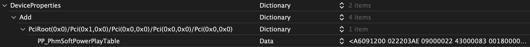

Open the config.plist file in DeviceProperties >> Add > PciRoot(0x0)/Pci(0x1,0x0)/Pci(0x0,0x0)/Pci(0x0,0x0)/Pci(0x0,0x0) and adds PP_PhmSoftPowerPlayTable, its value as Data is the long text string.
<key>PciRoot(0x0)/Pci(0x1,0x0)/Pci(0x0,0x0)/Pci(0x0,0x0)/Pci(0x0,0x0)</key>
<dict>
         <key>PP_PhmSoftPowerPlayTable</key>
         <data>Long string, seen as: hexadecimal in PLIST file editors and as Base64 in plain text editors</data>
</dict>

There is a way to recover the lost feature. When modifying the vBIOS ROM file in Windows with MorePowerTool, instead of disabling Zero RPM (unchecking option box), it is left checked but the temperatures at which fans start and stop are modified. By default they are configured like this: Stop Temperature 50º and Start Temperature 60º.
I have tried these settings: Start Temperature 40º and Stop temperature 35. With this change, fans spin and stop with the GPU temperature oscillating between 35 and 40º. GeekBench performance is as expected.

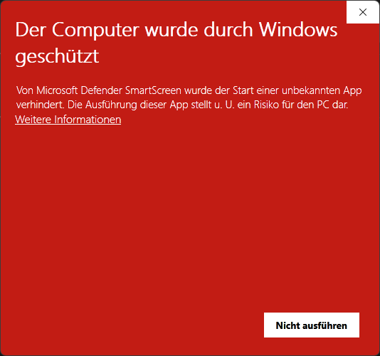

Guest 5T33Z0
Can't install MPT in WIndows 11. There's a red Warning window I've never seen before. I guess I have to reboot with disabled driver signature enforcement?
Edited by 5T33Z0
I didn't need any special thing to install MPT, it was a time ago, I'll try to see what happens.
3 minutes ago, 5T33Z0 said:
@miliuco Seems like Microsoft Defender SmartScreen detects it as malicious
Click on Weitere informationen and click run anyway.
It's form Windows SmartScreen to block unknown publishers. You don't have to disable signature enforcement.

There is a way to recover the lost function. When modifying the vBIOS file in Windows with MorePowerTool, instead of deactivating Zero RPM (unchecking its option box) it is left enabled (checkbox checked) but the temperatures at which the fans start and stop are modified. By default they are configured like this: Stop Temperature 50º and Start Temperature 60º.
I have tried setting Start Temperature to 40º and Stop temperature to 35º, I have created the new registry key (Save or Write SPPT) and I have exported it to the OpenCore config.plist file. With this modification, in macOS the fans spin and stop with the GPU temperature varying between 35 and 40º, achieving a result similar to what was lost. Performance in GeekBench 6 is as expected, 98.000 – 114.000 with an RX 6600 XT model.

I have completely removed power play table from my config and noticed that it behaves very differently in different SMBIOS's. When running under iMac19,1 I found my system way less stable and GPU temps varied between 55-60C. However when switched to iMacPro1,1 system is extremely stable and GPU temps keeps in a range of 35-40 when idle. I also found out that it performs better when it comes to GeekBench 6 scores ( 5% increase when compared with the same configuration on iMac19,1).
