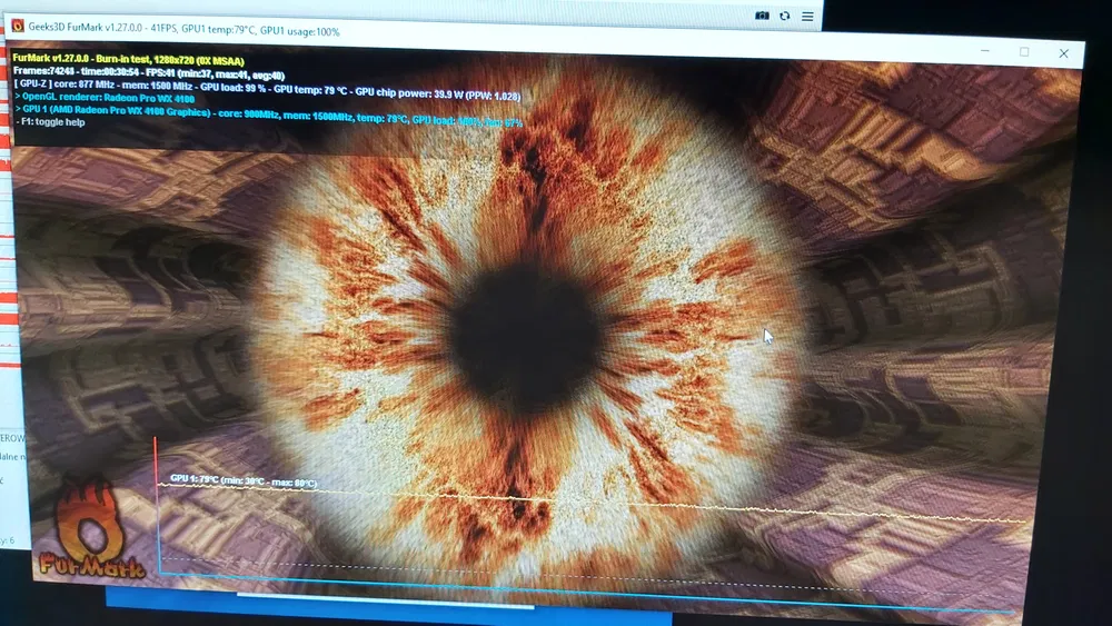

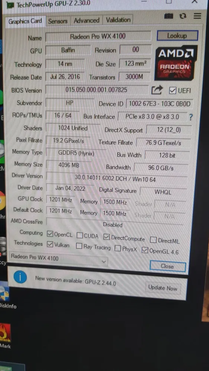

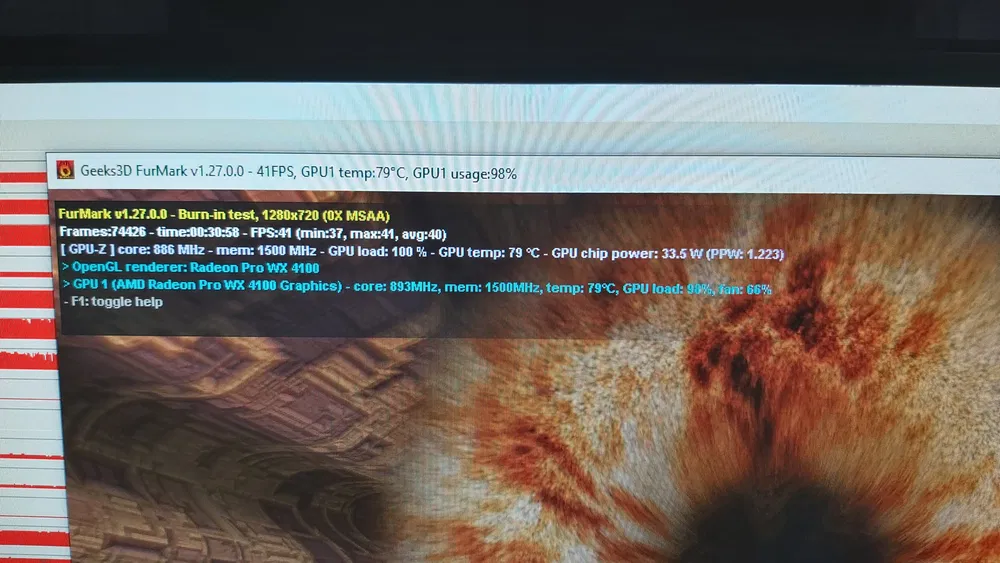

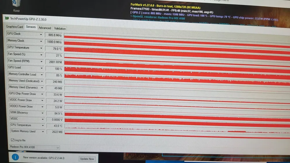

FICU Posted March 19, 2022 Author Share Posted March 19, 2022 1 hour ago, etorix said: If the card works it's all good… Radeon Pro cards are not (ab)used by gamers and unlikely to have ever been overclocked, modded or put to mining 24/7—and the WX4100 is not powerful enough to be of interest to miners anyway. In the end, I bought this GPU, nice of the seller, providing a 7-day startup warranty. When the GPU comes, I will try to fasten everything together and let me know if it worked. I still have a question about the installation itself. I currently have the following hard drives: - 1x Samsung 1TB M.2 PCIe4.0 NVMe 980 (1 partition 300GB for Windows, 2 partition 631GB for games, programs and personal files), - 1x Samsung 500GB 870 EVO SATA (only 1 partition as an additional disk for games) - 1x WDC 1000GB HDD (1 partition as old photo / video / music storage) - 1x New Samsung 500GB 870 EVO SATA (not connected, delivered to me yesterday) Does Hackintosh have any "special requirements" for the disk (Of course I only mean SSD, not HDD)? My guess is that for Hackintosh it would be good to use the M.2 NVMe SSD due to the transfers that such a disk can achieve, but having a new, unused SATA SSD disk, I could use it for Hackintosh without spending unnecessary money. I have important files and documents on my disks that I would not like to lose. Can I disconnect the drives during the installation to be sure? Quote Link to comment https://www.insanelymac.com/forum/topic/351118-z690-gpu-selection-for-hackintosh/#findComment-2778559 Share on other sites More sharing options...
etorix Posted March 19, 2022 Share Posted March 19, 2022 MacOS is actually picky with NVMe drives and, among others, Monterey does not like booting on Samsung NVMe drives. At all. There has been a report of Monterey wearing out a brand new 980 in a matter of weeks. There is a mitigation strategy (setting TRIM timeout to the maximum value, and living with slow boot) but it is best not to use affected drives as macOS boot drives. WD 750/850 are the current NVMe recommendation for Monterey. I use Toshiba/Kioxia drives (consumer XG5/XG6 and data centre XD5), but have still to test these with Monterey. SATA drives are all fine: Use the 870 EVO. And, most importantly, it's fine to keep the 980 as Windows drive for dual boot—macOS won't touch it! For multi-boot, it is good practice to physically remove the drives of other OSes while installing, out of safety, although issues reportedly arise the other way around: Linux or Windows grab the first EFI partition they find and put their stuff in there, breaking macOS boot. If you spend some time unplugging drives, I'd suggest to take out the RTX as well, install macOS with the WX4100 in the CPU PCIe slot first and then proceed to move the card to the PCH slot, adjust if needed and set up the dual boot. 1 Quote Link to comment https://www.insanelymac.com/forum/topic/351118-z690-gpu-selection-for-hackintosh/#findComment-2778563 Share on other sites More sharing options...
