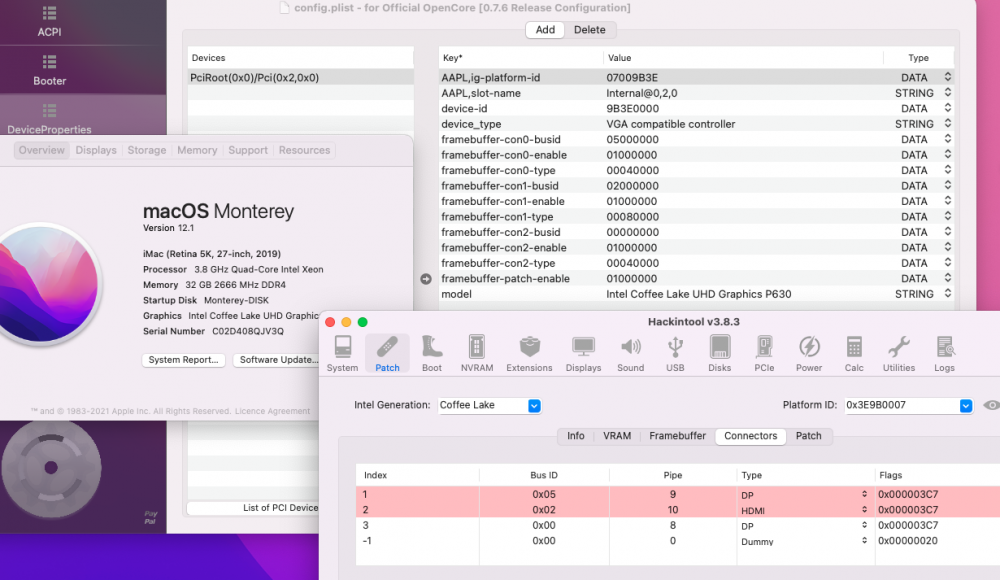

sebus Posted December 24, 2021 Share Posted December 24, 2021 (edited) Trying to get this as main single graphics display via DP Mobo: Asus WS C246M Pro (it has 1xDP, 1xHDMI, 1xVGA) Tried: General Framebuffer Patching Guide using Hackintool https://www.insanelymac.com/forum/topic/346265-guide-intel-uhd-graphics-630-coffee-lake-on-macos/ OpenCore Post-Install Patching Bus IDs Each time I try to use device-id in OC, I get black display (can Screen Share connect) Here are the screenshots with NO entries in OC config.plist (it is only 7Mb VRAM with NO acceleration, so unusable) Anybody has any more ideas? Thanks sebus Edited December 27, 2021 by sebus Link to comment https://www.insanelymac.com/forum/topic/350113-solved-intel-uhd-graphics-p630-coffee-lake-refresh-xeon-e-2174g-3e96/ Share on other sites More sharing options...
