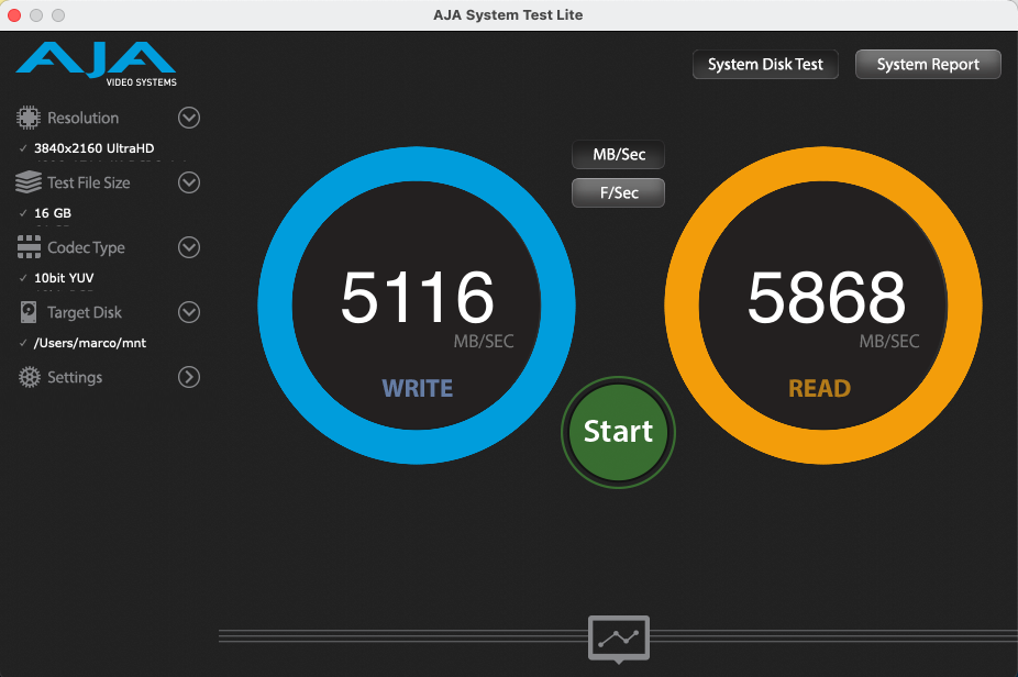

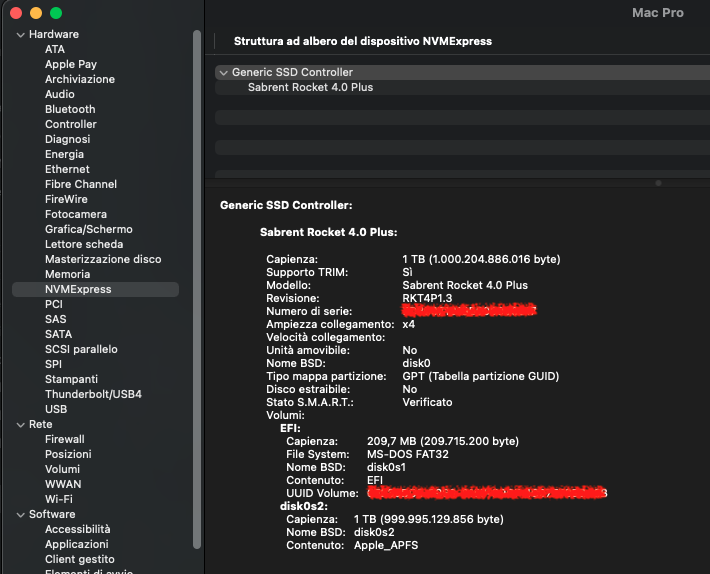

sandokan71 Posted November 29, 2021 Share Posted November 29, 2021 (edited) Hi.. I'm testing my new M.2 NVME Sabrent Rocket 4 Plus, which is able to run at full speed (PCIE 4x4) with 11th gen CPU i5-11400 on Asrock B560M-HDV. Running MacOS Monterey 12.0.1 with Opencore 0.7.6, with a minimal set of kexts (lilu, weg, virtualsmc, intelmausiethernet e NVMeFix) all at latest versions. So far, everything looks great. Just noticed something strange in System Report, section NVMExpress, I can't see anything under "Link Speed" . I would expect something like 16T/sec... but it is empty. Maybe this is normal for a non-Apple NVME controller? Or maybe PCIe4 is not recognized by Apple, so the System Report simply shows a blank output? All the benchmarks appears good, results are almost doubling the typical values obtained with PCIE 3x4, so it's strange... Edited November 29, 2021 by sandokan71 Link to comment https://www.insanelymac.com/forum/topic/349782-nvmexpress-link-speed-is-blank-with-pcie-40x4/ Share on other sites More sharing options...

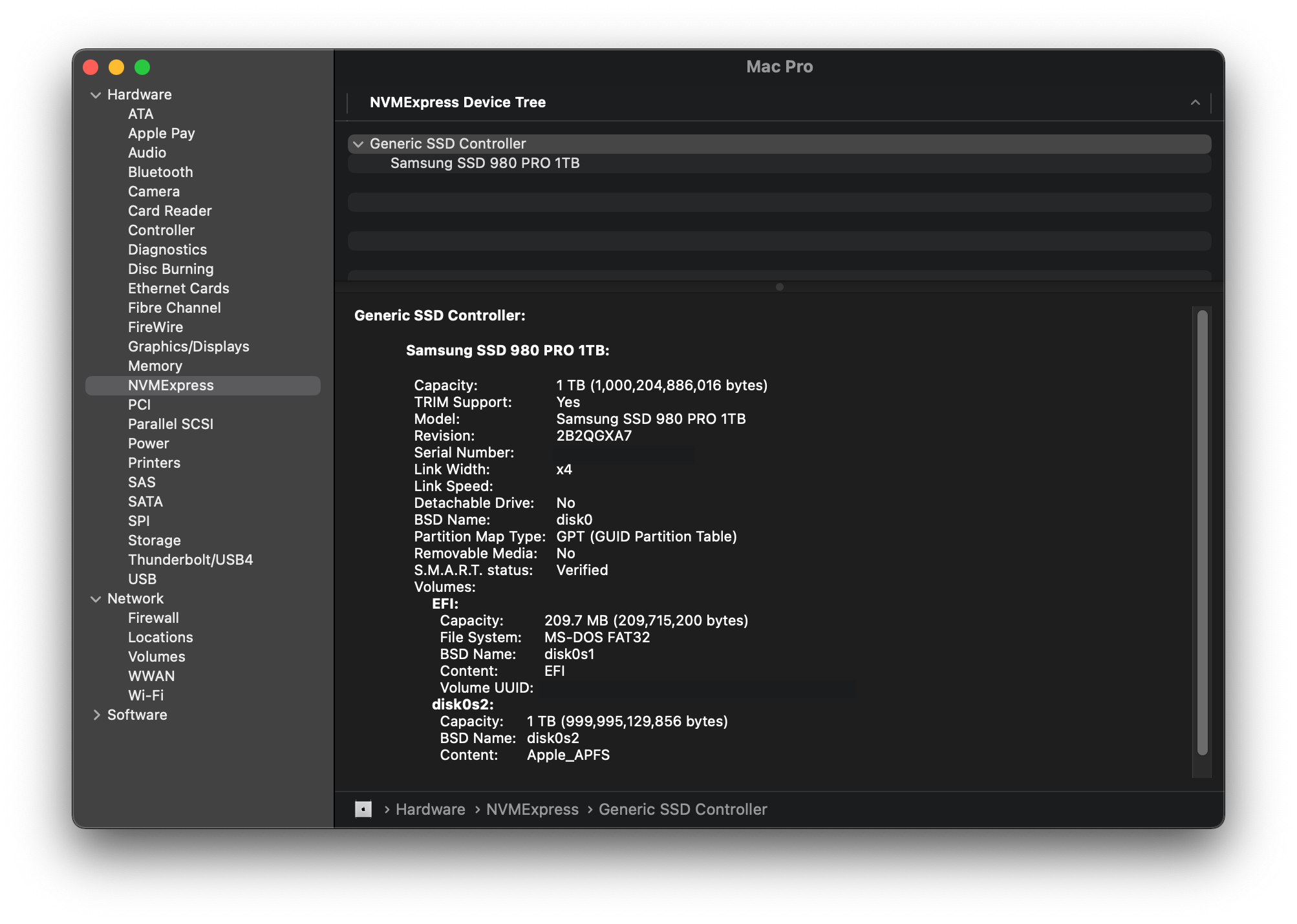

Cyberdevs Posted November 30, 2021 Share Posted November 30, 2021 @sandokan71 On my Ryzen rig the link speed is also blank as you can see in the picture and since Ryzen is not officially supported by macOS then the result is the same as your situation. I use Samsung 980 Pro 1TB NVME drive. 1 Link to comment https://www.insanelymac.com/forum/topic/349782-nvmexpress-link-speed-is-blank-with-pcie-40x4/#findComment-2772708 Share on other sites More sharing options...
sandokan71 Posted November 30, 2021 Author Share Posted November 30, 2021 19 hours ago, Cyberdevs said: @sandokan71 On my Ryzen rig the link speed is also blank as you can see in the picture and since Ryzen is not officially supported by macOS then the result is the same as your situation. I use Samsung 980 Pro 1TB NVME drive. OK.. so it's probably for the same reason, any unsupported platform will show Link Speed as blank. Anyway, I am still not seeing any problem in using this setup, I need to do more tests especially for TRIM.. Link to comment https://www.insanelymac.com/forum/topic/349782-nvmexpress-link-speed-is-blank-with-pcie-40x4/#findComment-2772717 Share on other sites More sharing options...
