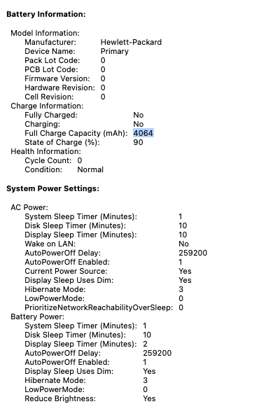

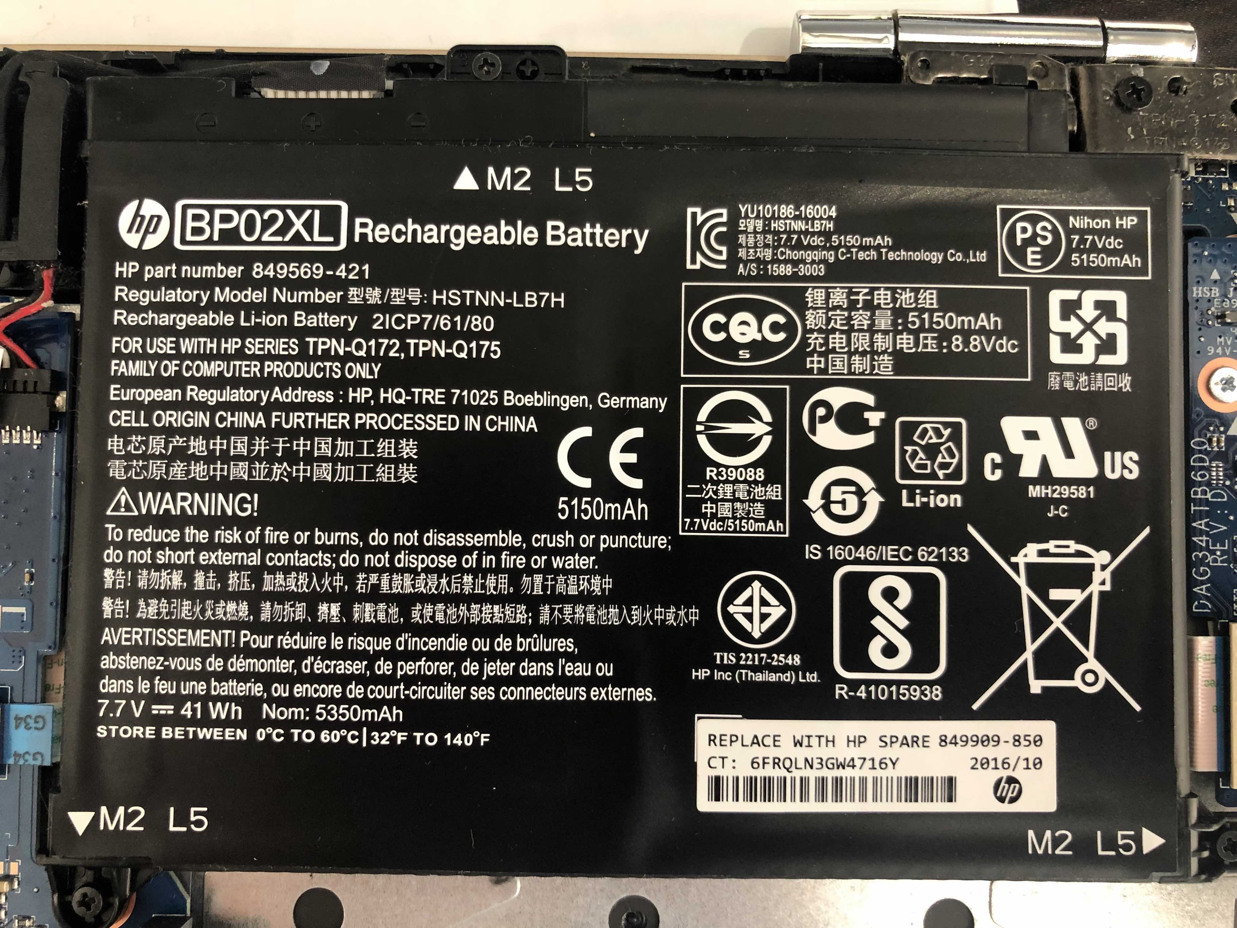

After some diagnostics The battery is 5150mAH and what is in System Information is 4064mAH
Also I tried to boot windows and status stick to not charging and HP Support Utility shows Battery as Unknown.
But after disconnect batteries as i mentioned above HP tools shows that battery is normal and charging
