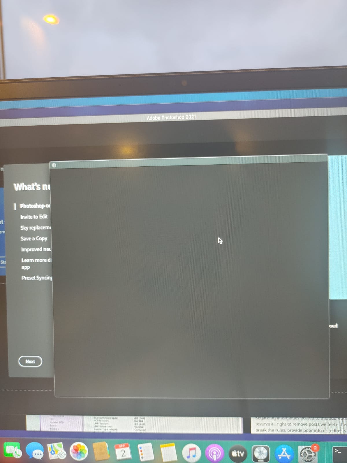

Likewise, attempting to change the mac account picture crashes system preferences and opening photoshop gives a black screen. Same thing happens even if I drag a photo over the icon or use scripts to try and change the admin photo via terminal (the scripts, despite claiming to be successful, even caused temporary kernel panics which sorted themselves out; image remained unchanged). The Contacts app also crashes when attempting to change ANY contact photo, be it by clicking or dragging a photo.
https://imgur.com/x3n8nB
Photoshop preferences also have '??' throughout the GPU info section, something like "GPU: ??630 ??H?D?" despite the GPU information in 'About This Mac' being correctly recognised (see below). I also cannot change these photoshop settings as they are greyed out.

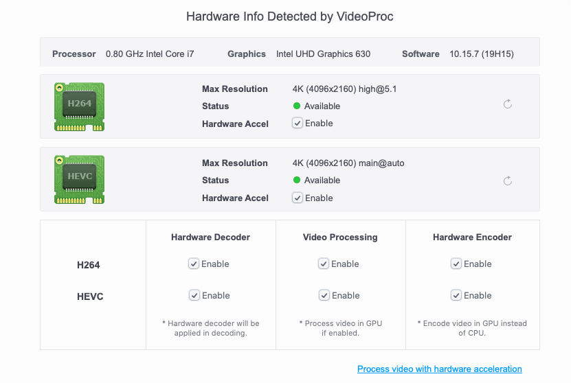

I have confirmed that hardware acceleration is fully supported and that HEVC IS supported. I verified the H.265 hardware acceleration by successfully encoding a sample file.

On paper, graphics acceleration looks to be functional (translucent dock, videoproc claims everything is operational - see below...) but I'm not sure it's 100% functional due to the issues I mentioned.
Can you elaborate on iGPU properties to inject? I'm really new to this hackintosh thing and was alway unsure about auto-detection versus manually putting in device properties. My EFI file (with SMBIOS data redacted) is also available on github (https://github.com/Necromancer2Point0/MSI-GS66-OC-New-Dawn/tree/main/Latest Stable Bootable (V 0.4)) if you need any more information.
Still, I find it odd that I've only encountered these crashes when doing image related tasks.
VDADecoderChecker states Hardware acceleration is fully supported and VideoProc shows that HEVC IS supported. I verified the H.265 hardware acceleration by using Handbrake to encode a sample file with the option H.265 (VideoToolbox), which was successful.

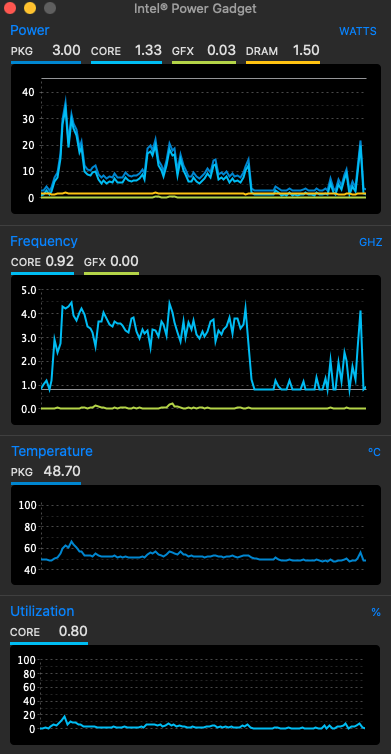

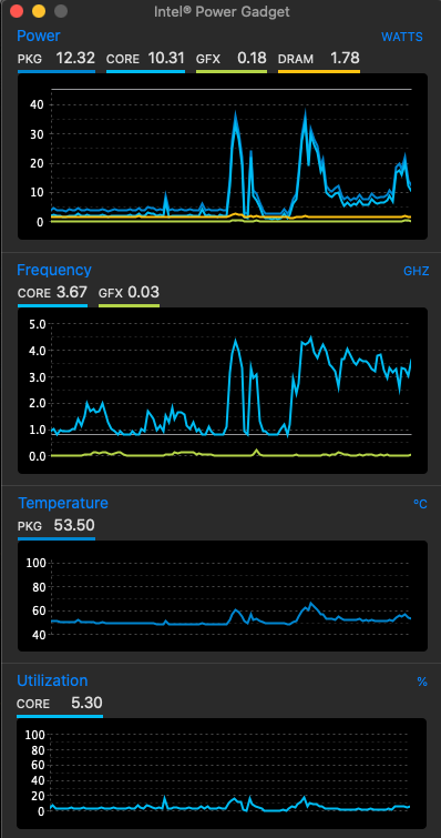

I just installed Intel Power Gadget (v 3.5.5) as you suggested and have been monitoring the graphs. Pretty quick to install - didn't even need to reboot.
CPU frequency (while plugged in) hovers between 0.8-1.2 ghz on idle, spikes when browsing and doing other tasks to about 1.4-2.5 ghz and reaches 3-4 ghz (not capped; sometimes spikes to 4.5 ghz) when playing a project in Logic Pro.
Temps are decent (39-45 C on idle; about 45-55 C under load) though Windows is still slightly better as I have used Throttlestop to undervolt and get around 30-40 C on idle and 45-55ish C when solely taxing the iGPU (with dGPU, temps reach a maximum of around 77 C). Negligible difference all things considered.
CPU frequency (while on battery at full brightness) tells pretty much the same story, again hovering between 0.8-1.2 ghz on idle, spiking when browsing and doing other tasks to about 1.4-2.5 ghz BUT only reaches 2.5-3 ghz (seems to be capped at 3 ghz) when playing a project in Logic Pro, which I think is a good thing and possibly an indication that power management is working properly (?).
Temps are decent (lower end of 39-45 C on idle; 45 C capped under Logic Pro's load) though Windows is still slightly better as I have used Throttlestop to undervolt and get around 30-40 C on idle albeit around the same temperature when taxing the CPU. Again, negligible difference all things considered.
Fans were silent throughout both testing setups though I have had them rarely kick in abruptly in the past (usually stopping just as abruptly) when opening something strenuous or doing multiple things at once.
Battery life seems reasonable given the fact I've got brightness set to max, RGB keys on full blast, many browser windows, terminal open, and have been messing around with Logic. So far from testing and writing up this post, only a couple % gone and the prediction in Activity Monitor is about 4 hours. It predicted 6 hours last time I tested when doing browsing on an ever so slightly dimmer brightness setting (2 below max), which I messed around with for about 1.5 hours to confirm that it wasn't just a whacky prediction.
I have not tried extreme benchmarking tasks like Prime95 or anything like that as my real world usage will almost certainly never come close to that kind of stress.
All in all, both temperatures and CPU utilisation (averaging about 5% according to the monitor) look very stable on the aforementioned tasks, being relatively flat on the graph (screenshots below are over a shorter period of time; after longer testing, it was much flatter).
I've attached some screenshots of the monitor to get a sense of the readings.
