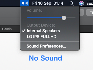

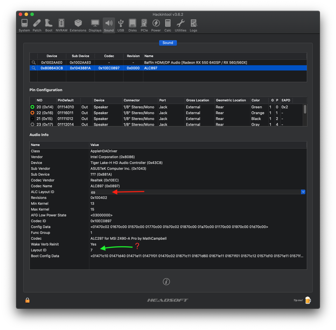

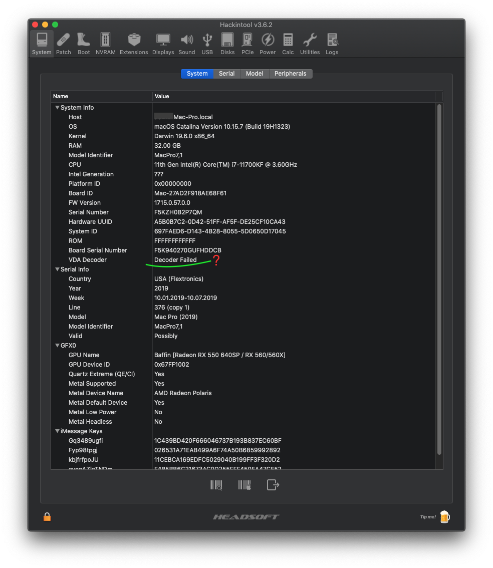

monostroy Posted September 9, 2021 Share Posted September 9, 2021 (edited) Audio issue has been SOLVED! Please read the explanation from this Thread below. Btw, you're great MaLd0n, And Allan too! 👍 Hi All.. I think I've made mistake with my choosing hardware.I've already installed Catalina 10.5.7 (19H1323) on this PC (Asus B560M Plus Gaming + i7 11700K'F' + RX550)And now, I'm facing a problem with the Audio (ALC897). Although HDMI Audio through RX550 is working fine.I have use Layout id : 66 and 69, the volume icon seem fine.. But still no sound. And another problem about the VDA Decoder, since the processor that I use is Gen.11 with 'F' series, will this problem be solved? Anyone can help me? Here my screenshot and resource files : Resources Files : From 'RunMe' app.zip ACPI origin.zip Edited September 13, 2021 by monostroy Solved 2 Link to comment https://www.insanelymac.com/forum/topic/348844-solved-no-sound-asus-b560m-plus-gaming-i7-11700kf-rx550/ Share on other sites More sharing options...

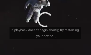

monostroy Posted September 10, 2021 Author Share Posted September 10, 2021 (edited) 15 hours ago, MaLd0n said: extract one sendme with this efi folder https://tinyurl.com/2ur3vc56 reset nvram first time Hi MaLd0n, thanks for your reply.. I have replaced the EFI folder, but it still no luck.. No output audio device. And my RX550 gpu become 7mb And i believe this audio issue, has an impact when I play YouTube, and other offline video files. They don't play.. But when I change output audio to the HDMI Output, YouTube and offline video will play smoothly.. These problem, so far I know it has correlation with the processor. But will it affect to the audio too? 16 hours ago, Allan said: Try this: config.plist.zip EDIT: And according to your IOReg output, you don't have the proper power management. 😬 Hi Allan.. I have no idea with that. 😬 Is there something wrong with the configuration? or because this machine is relatively too early? Edited September 10, 2021 by monostroy Link to comment https://www.insanelymac.com/forum/topic/348844-solved-no-sound-asus-b560m-plus-gaming-i7-11700kf-rx550/#findComment-2766067 Share on other sites More sharing options...

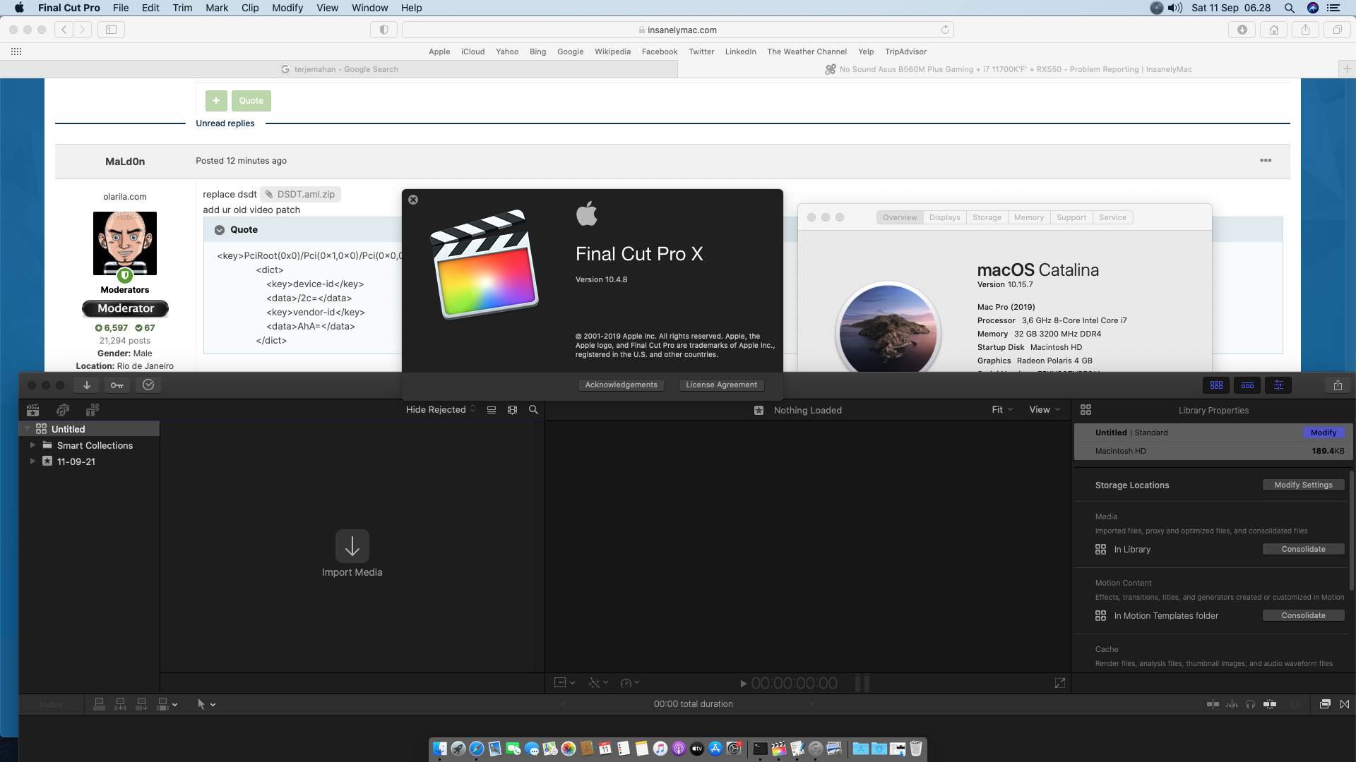

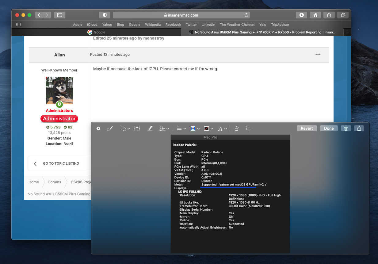

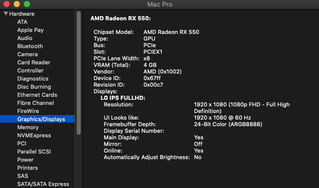

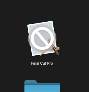

monostroy Posted September 10, 2021 Author Share Posted September 10, 2021 (edited) 2 hours ago, MaLd0n said: check if work EFI FULL.zip 4.44 MB · 1 download remap ur usb https://www.olarila.com/topic/14220-video-guide-usb-port-mapping-guide-2021-mojave-catalina-bigsur-monterey/ Wow.. Thank you MaLd0n, all USB port and the audio working good. But I have a new problem now, browser (Safari or Chrome) look glitchy and laggy, and I lost Metal on my GPU. And sometimes safari reloaded it self.. 😬 Spoiler And sadly, I hear FCPX not support for my (F) series processor? Is that right? 😢 Spoiler Edited September 10, 2021 by monostroy Link to comment https://www.insanelymac.com/forum/topic/348844-solved-no-sound-asus-b560m-plus-gaming-i7-11700kf-rx550/#findComment-2766088 Share on other sites More sharing options...
Allan Posted September 10, 2021 Share Posted September 10, 2021 Maybe if because the lack of iGPU. Please correct me if I'm wrong. Link to comment https://www.insanelymac.com/forum/topic/348844-solved-no-sound-asus-b560m-plus-gaming-i7-11700kf-rx550/#findComment-2766089 Share on other sites More sharing options...

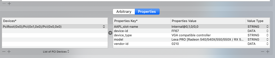

monostroy Posted September 10, 2021 Author Share Posted September 10, 2021 But, when I turn back to Clover.. My Metal my GPU status is Supported. And I think QE/CI work well. No glitch or laggy on the browser.. Here's the screenshot : Spoiler Here's my Device/Properties in clover : Wait, I'll add it, and I hope it will work in OC.. Spoiler Link to comment https://www.insanelymac.com/forum/topic/348844-solved-no-sound-asus-b560m-plus-gaming-i7-11700kf-rx550/#findComment-2766093 Share on other sites More sharing options...
MaLd0n Posted September 10, 2021 Share Posted September 10, 2021 replace dsdt DSDT.aml.zip add ur old video patch Quote <key>PciRoot(0x0)/Pci(0x1,0x0)/Pci(0x0,0x0)</key> <dict> <key>device-id</key> <data>/2c=</data> <key>vendor-id</key> <data>AhA=</data> </dict> 2 Link to comment https://www.insanelymac.com/forum/topic/348844-solved-no-sound-asus-b560m-plus-gaming-i7-11700kf-rx550/#findComment-2766097 Share on other sites More sharing options...

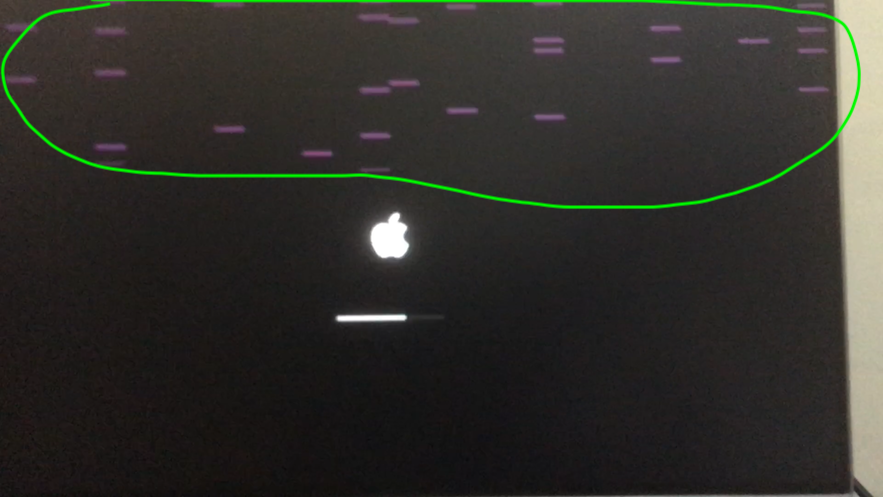

monostroy Posted September 10, 2021 Author Share Posted September 10, 2021 (edited) 1 hour ago, MaLd0n said: replace dsdt DSDT.aml.zip add ur old video patch OMG.. UNBELIEVABLE!! I think all the hardware already works now! OMG.. you're great MaLd0N! 🤗 And thanks to Allan too.. 👍 Btw, I'm not yet add your last DSDT.aml, I've just edited last video patch in OpenCore Configurator. And check all devices. And what makes me more happier is about FCPX After, I almost desperate when I heard this F series processor had issue in FCPX.. But, now I think, maybe I just opened the wrong version of FCPX. 😆 FCPX 10.4.8 Spoiler After it, I will add your DSDT file.. I'll report it later. ----- EDIT : - I have added your latest DSDT file. It Working Good! 👍 - I just tried the front audio port, Front Audio : Working Good. But Front Mic/headset not working. Then I change Alcid:69 to 66, Front Mic : Worked! 👍 I think all the big problem was SOLVED! The only issue is on the boot glitch, but I think it's just a cosmetic, not a big deal. Boot Glitch around 1-2sec : Spoiler Edited September 11, 2021 by monostroy 1 Link to comment https://www.insanelymac.com/forum/topic/348844-solved-no-sound-asus-b560m-plus-gaming-i7-11700kf-rx550/#findComment-2766102 Share on other sites More sharing options...
