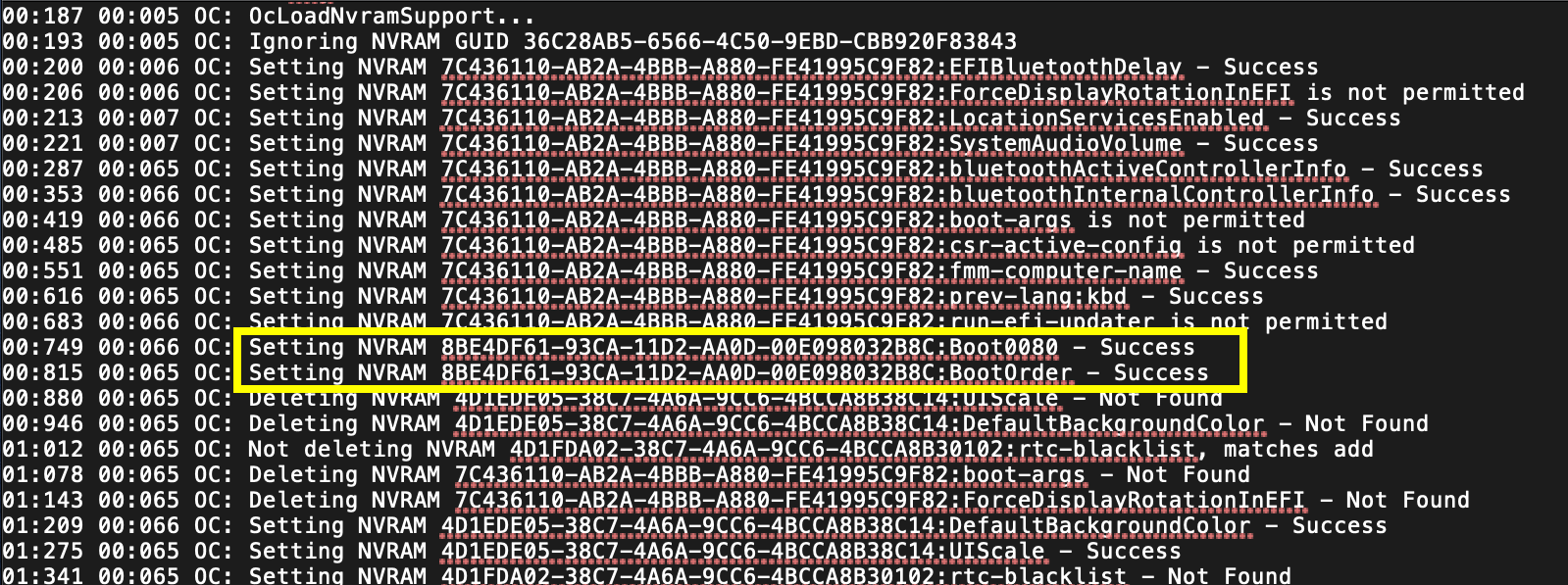

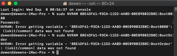

dewen Posted September 8, 2021 Share Posted September 8, 2021 (edited) Hi :I have a problem with OC dual boot on one single HDD.I can not set the default boot entry to macOS, it alwayse fixed at win10. Preference -> Startup Disk or Ctrl-Enter at OC picker : not work. My Hardware : Dell XPS 9100 Studio. LGA 1366. 5ND3X X58. Xenon X5690 CPU. BIOS ver. : A04 : No UEFI. no native NVRAM 320G SATA HDD. 16G RAM. GT 730 Legacy install OC 0.7.2 Debug ( BootInstall_X64.tool + HfsPlusLegacy.efi ) 10.5.7 Catalina, then make GUID partition under macOS and install win10 from OC picker menu. I installed Emulated NVRAM to support Boot0080 and BootOrder nvram variable, because they are necessary for default boot entry. I put LogoutHook folder in \Users\Shared\ and run /Users/Shared/LogoutHook/LogoutHook.command install and set Booter - DisableVariableWrite : noMisc - Security - ExposeSensitiveData : to 0x3. ScanPolicy : to 0NVRAM : LegacyEnable, LegacyOverwrite, WriteFlash : yesUEFI Quirk : RequestBootVarRouting : yes it seems works, nvram.plist created at root EFI and updated after each boot. Test : 1. clean boot : no Bot0080 data in NVRAM and nvram.plist. Attach the debug boot log and nvram.plist opencore-2021-09-07-164106.txtnvram.plist 2. restart, at OC picker, choose macOS and press Ctrl-Enter. it set Boot0080/BootOrder data to nvram vaiable attach boot log and nvram.plist ( the same )nvram.plistopencore-2021-09-07-164847.txt then restart again, the Boot0080/BootOrder will be write to nvram.plist and used on next boot. 3. OC should read the updated nvram.plist(with BootOrder), but it seems not read it, the picker still use win, so I moved to macOS and boot it ( without Ctrl-Enter ). terminal command shows no Boot0080 data, means nvram.plist with Boot0080 not read or set correctly. The updated nvram.plist has Boot0080 data but not work nvram.plist attach the boot log, the nvram for Boot0080/BootOrder seems setting success, but not work. not supported ? opencore-2021-09-07-165446.txt Attach my config.plistconfig.plist It seems OC emulated nvram not support legacy boot system ? so the updated nvram.plist with Boot0080/BootOrder can not be read or set at the OC picker stage ? so I can not set default boot entry to macOS. Any suggest or help will be appreciated, thank you ! Edited September 13, 2021 by dewen Quote Link to comment Share on other sites More sharing options...

MacNB Posted September 9, 2021 Share Posted September 9, 2021 2 hours ago, dewen said: My X58 system is Dell XPS Studio 9100 with motherboard 5DN3X, It has h/w NVRAM, but seems not "compatible" with macOS like Asus x99 chipset. I installed OpenCanopy GUI, with Preference -> Startup Disk set to macOS, reboot, but it still fixed at Windows picker. ( due to debug reason so I choose not to install it at first for less variable cause ) attach the config.plist(with GUI), nvram.plist ( with Boot0080 var ) and boot log config.plist 26.68 kB · 0 downloads nvram.plist 2.82 kB · 0 downloads opencore-2021-09-09-135005.txt 256 kB · 0 downloads Can you share your config.plist, and the "boot" file locate in the EFI root directory ? ( installed by BootInstall_X64.tool ) Do you use HfsPlusLegacy.efi driver ? Thank you for your kindly help to spend time for re-install new version OC and check my config for the problem I met, I am appreciated, thank you. Attached is my config file (serials redacted). Attached boot file too. This will will not make any difference as it is the same as the one you have (if installed from 0.7.2 release). Yes I use HfsPlusLegacy.efi driver. All BIOS chips are non-volatile (NVRAM) by definition so that they can be updated with new versions of the BIOS by dedicated Flash updaters. But the word NVRAM in the spec sheet does not mean a section of the BIOS chip is used (read/write) by the OS's for what we call "NVRAM" (used for storing UEFI variables). I do not know how to verify whether your (or any) motherboard has read/writable NVRAM variable section at runtime. I also do not know how OC (or Clover) distinguishes between "real" or emulated NVRAM when it is reading/writing to it. In your case, it appears to be a "hybrid" case of real & emulated NVRAM judging by: 19:612 00:255 OCB: BootOrder/BootNext are not present or unsupported My theory is that when macOS writes the Startup Disk id into the NVRAM, it's probably being written "somewhere" on the real NVRAM and a cached copy in the OS. The cached copy is written to the nvram.plist (which looks correct) on restart by LogoutHook.command. When OC come along, it may be reading from the real NVRAM and picking up garbage and hence prints that message above. Seems like some corruption is taking place. Would need to dig into the source code to see why OC prints that message. Probably best to raise a new bug report with the details attached (motherboard specs, config.plist, logs when booting default and when pressing Ctrl-Enter to set the default boot). config-MacNB-530.plist boot 1 Quote Link to comment Share on other sites More sharing options...
MacNB Posted September 9, 2021 Share Posted September 9, 2021 (edited) @dewen I have just reproduced your problem on my legacy system. I don't know how i missed it ....... but you have set RequestBootVarRouting=TRUE. It needs to be set to RequestBootVarRouting=FALSE. Please change it and report back. Edited September 9, 2021 by MacNB typo 1 2 Quote Link to comment Share on other sites More sharing options...
dewen Posted September 10, 2021 Author Share Posted September 10, 2021 (edited) On 9/10/2021 at 1:34 AM, MacNB said: @dewen I have just reproduced your problem on my legacy system. I don't know how i missed it ....... but you have set RequestBootVarRouting=TRUE. It needs to be set to RequestBootVarRouting=FALSE. Please change it and report back. It works !!! by your suggestion and modify my config.plist it works !!! now I can dual boot and set default OS, thank you very much !!! Solution : (for emulated NVRAM ) To enable persistent Default Boot setting via StartUp Disk preferences, set the following values in the config.plist: 1. RequestBootVarRouting = FALSE 2. LauncherOption = Disabled thank you !!! Edited September 11, 2021 by dewen 2 1 Quote Link to comment Share on other sites More sharing options...
